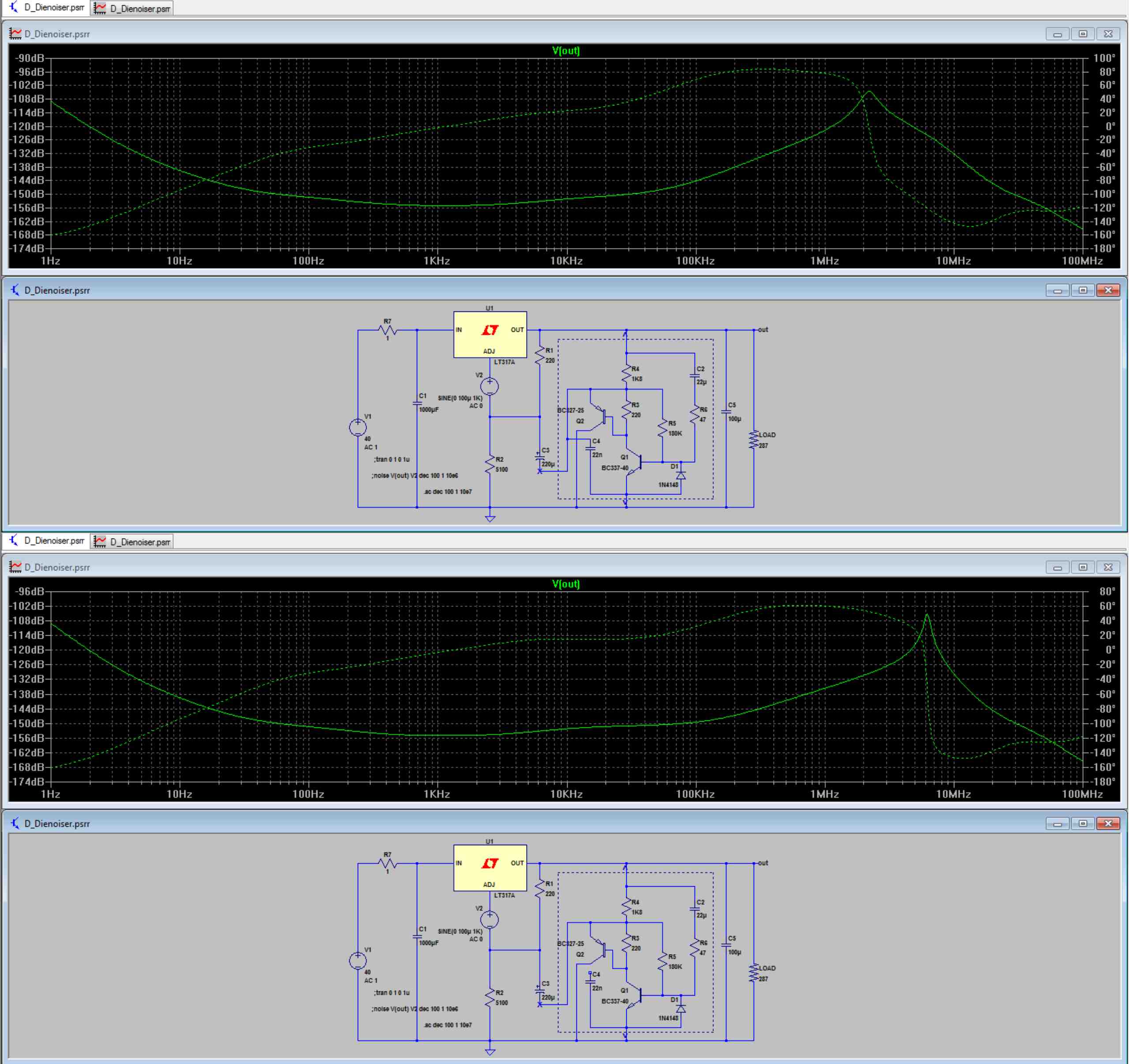

These are the curves I get on my sim.
How do I get to show the oscillation?
Hmm, I have 100 uF/220 mΩ cap at output in the real dienoiser circuit and it does not oscillate, even without 22 nF compensation capacitor. It was many times reiterated in this long thread that very low ESR capacitor at LM317 output can introduce oscillation. In LTspice is the opposite. 😕
There was one case where adding 1 uF ceramic capacitor at output, in parallel with electrolytic cap, made denoiser (single transistor) circuit to oscillate.
Like I said before my miniature dienoiser oscillates with 100u/600mohm. I'll test it with a low-ESR cap tomorrow. However I do not particularly like circuits that are on the verge of oscillations. Especially as an add-on since changing to a low-ESR output cap may not be feasible in an existing hardware.
Only that if the control system is unstable, and if Nyquist oscillation is observed on node "AAA", we also expect to observe it on BBB, CCC, DDD, and EEE too.
Among them, I expect the greatest amplitude at BBB and EEE. Probing them ought to give the easiest-to-see oscillatory waveforms. Plotting what's easy to see, feels like a useful decision.

The oscillation amplitude is greatest at the junction of the Sziklai transistors (i.e. DDD in your schematic). Here I also shortened the timestep which makes the oscillations appear sooner.
As I said earlier, it points to a local issue, and indeed shortening the timestep to very small values (even 1ns or less) can reveal something.
There are many other factors to take into account: the solver chosen in LTspice, the various parameters (Gmin, abstol,...) etc
Now, one crucial question: why I can’t get oscillations on the same model at any spot (A,B,C,D,E)?
As I can’t induce them on real circuit as well. Isn’t this just LTspice quirk?
As for LTspice, see above: unless all the options are forced in the .asc, you cannot be sure that "your" LTspice is the same as the other person's one.
Try really short timesteps.
In the real circuit, I wasn't able to observe oscillation either, but I only made a breadboard test.
Diego's original sim (not LTspice) looked stable without any comp capacitor, but in reality I had to add one to get it stable

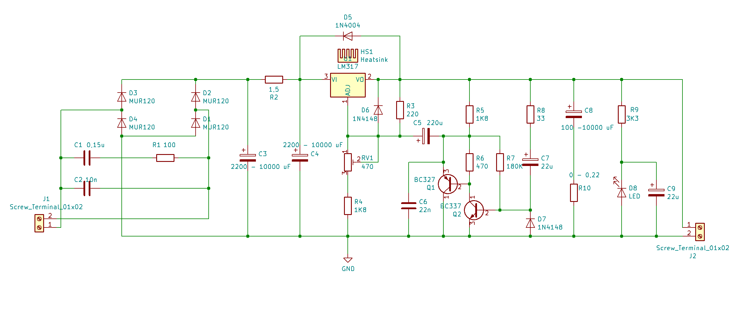

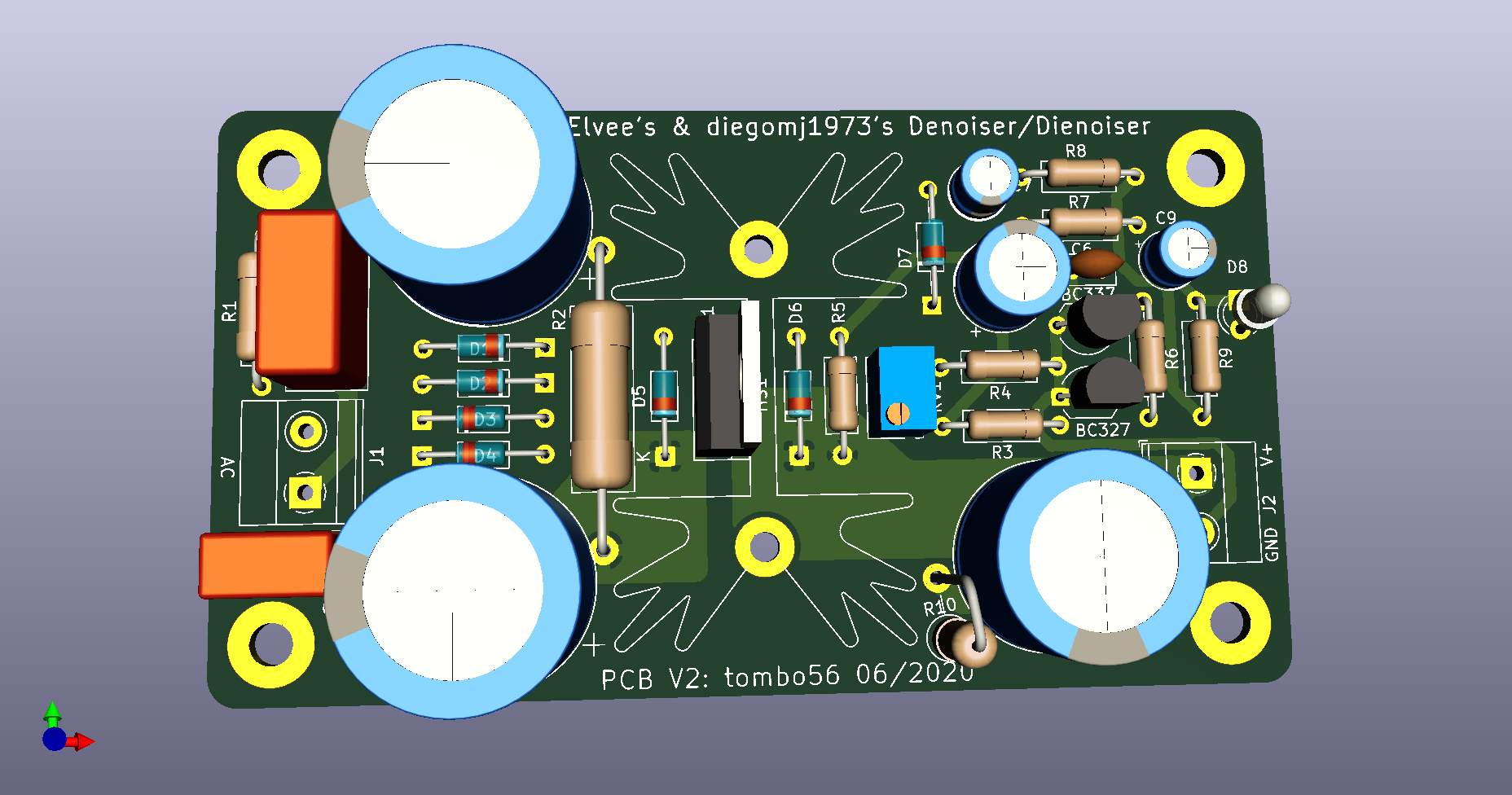

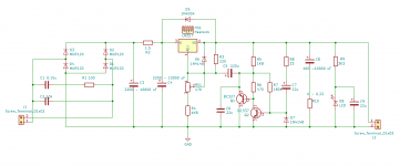

PCB V2
Here is revision of the single rail dienoiser pcb.
It now accommodates 18 mm diameter input caps. There is led indicator on the output with capacitor bypass, so it is assured that no noise will be introduced (overkill, I know). R5 resistor is moved close to output pin of LM317. Pitch for BC transistors is changed to 2,5 mm. Wonder why? I was lazy to exchange soldering tip for fine one and all pins were soldered together. That made me to replenish my curse words repertoire.
Output capacitor can be with 5 mm or 7,5 mm pitch and up to 16 mm diameter. There is position for a ESR adjusting resistor in series with output capacitor or just jumper.
If someone will build this, let me know if any help is needed with BOM list and values for specific output voltage and current.

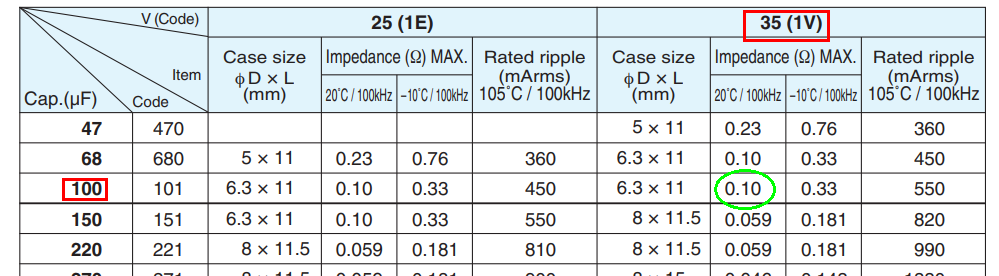

I must be missing something here. When I calculate the ESR for MY 100µF capacitor (Nichicon UHV1V101MED1TA, 100µF, 35v, tanδ = 0.11@120Hz) and using the formula:
E.S.R. = DF / 2 Pi f C, I get 1.46 Ω. That's a far cry from the coupla-hundert milliohms that everyone here is talkin'. Huh?
