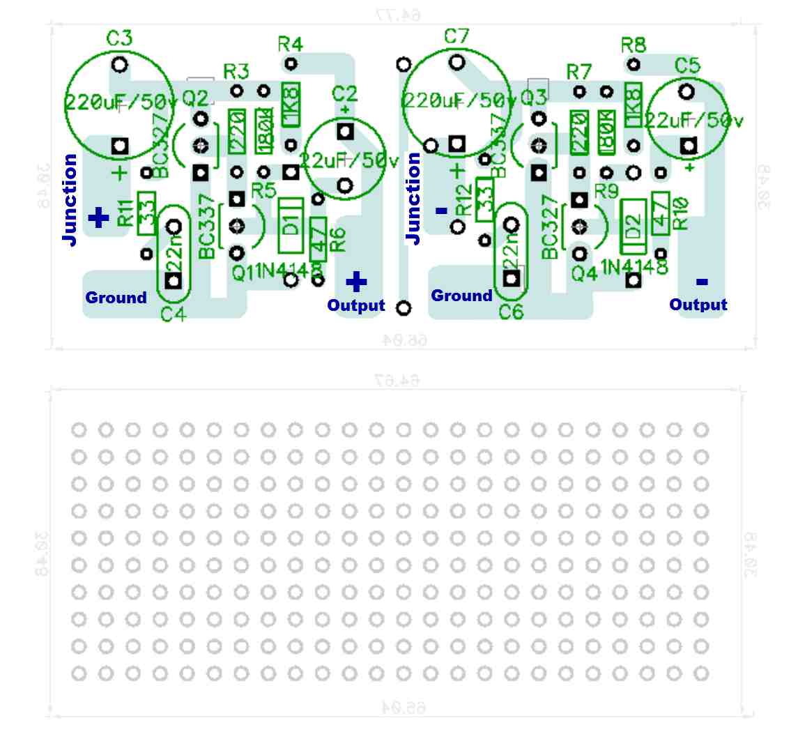

Here's the updated and corrected last version of the Dienoiser designed for assembling on a prototype pcb.
It's designed for through hole parts only, and the parts terminals are to be used as the circuit traces, twisting and soldering the wires to interconnect the parts.
Please disregard the other design I had uploaded some days ago, as it had one trace missing. Also this time, and considering some feedback from others that used the Dienoiser and seemed to have had some oscillations, I added a compensation resistor space in series with the 22n capacitor.
As soon as possible I will assemble that proto pcb here, with the parts I have, and add it to some of the regulators I also have.
As you can see, there's a vertical line in the middle, which you can use to separate the positive and negative Dienoisers, accordingly to what you need. Or if you have only positive regulators, as might be the case, repeat another positive Dienoise on the right side.
This is as easy as this project can get.

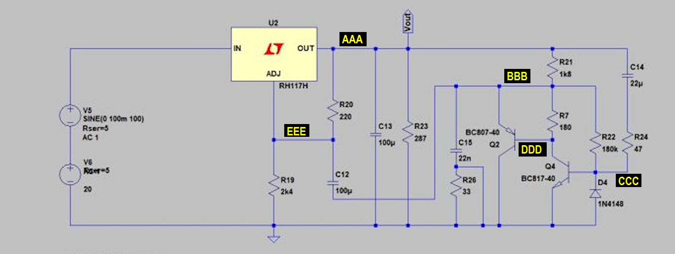

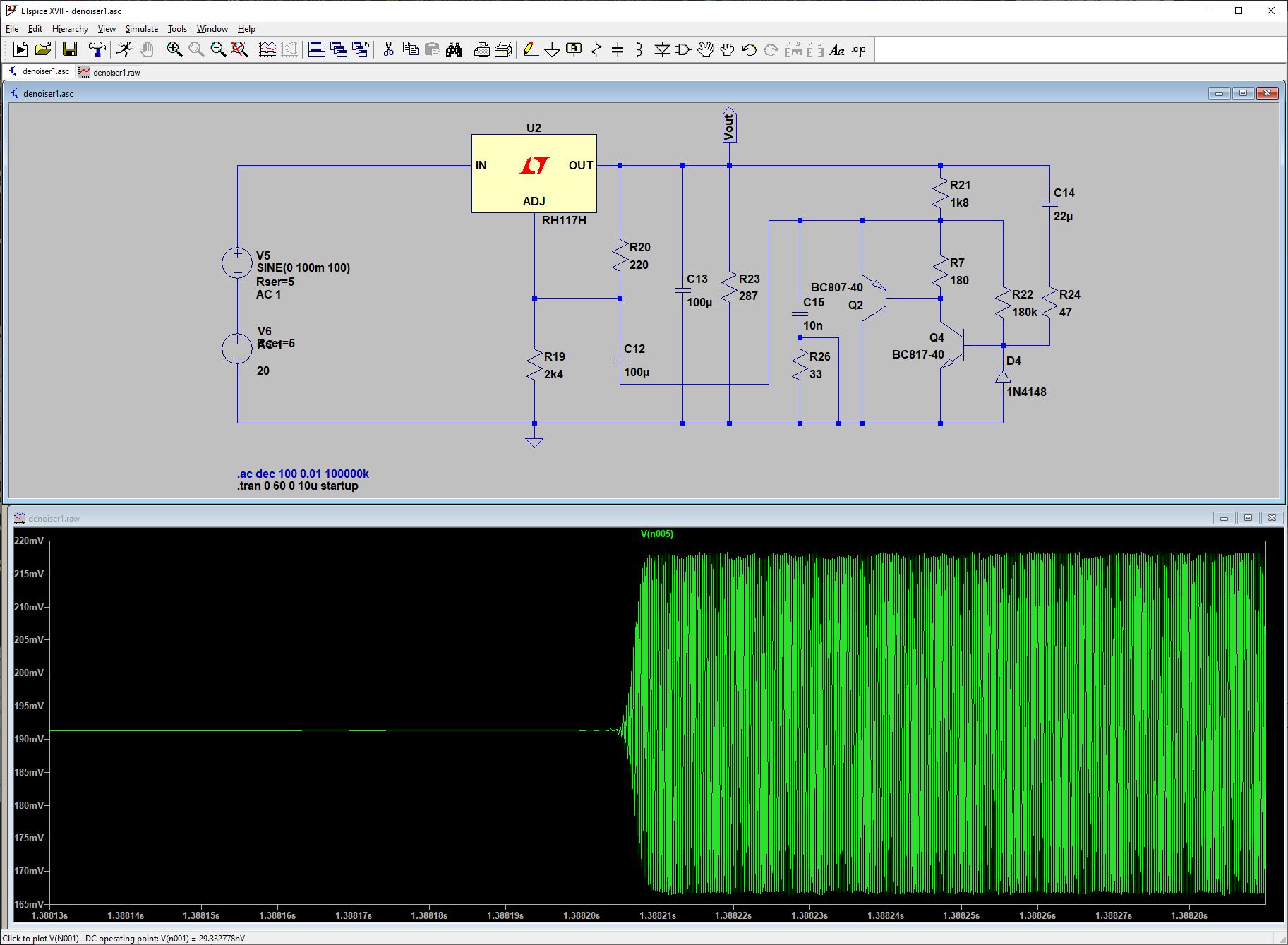

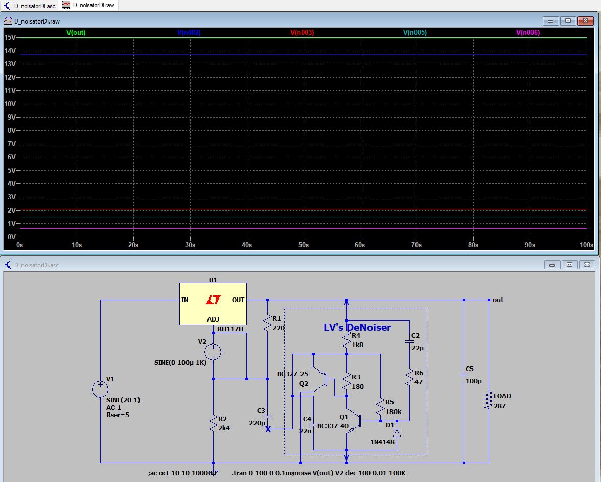

Only that if the control system is unstable, and if Nyquist oscillation is observed on node "AAA", we also expect to observe it on BBB, CCC, DDD, and EEE too.
Among them, I expect the greatest amplitude at BBB and EEE. Probing them ought to give the easiest-to-see oscillatory waveforms. Plotting what's easy to see, feels like a useful decision.
_

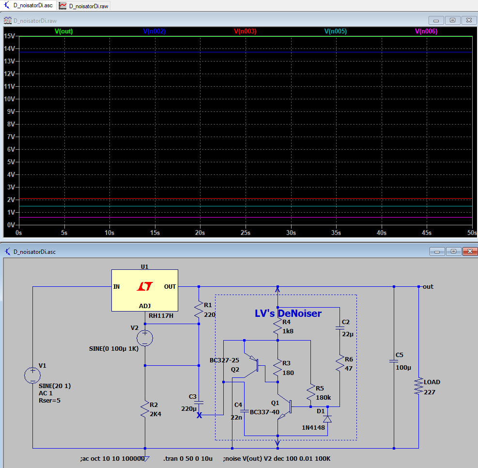

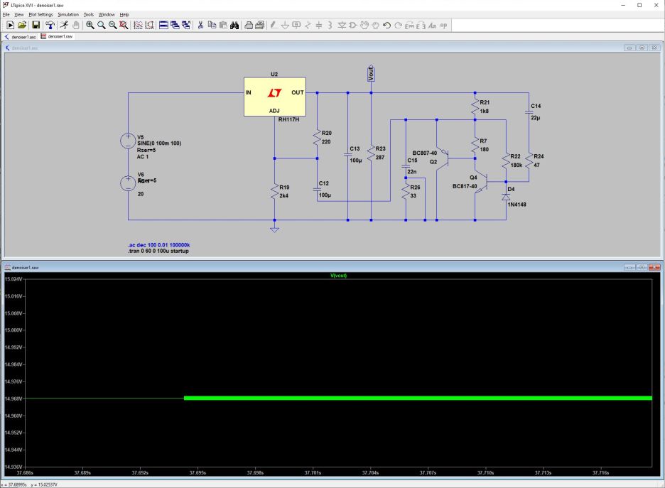

Now, one crucial question: why I can’t get oscillations on the same model at any spot (A,B,C,D,E)?
As I can’t induce them on real circuit as well. Isn’t this just LTspice quirk?
