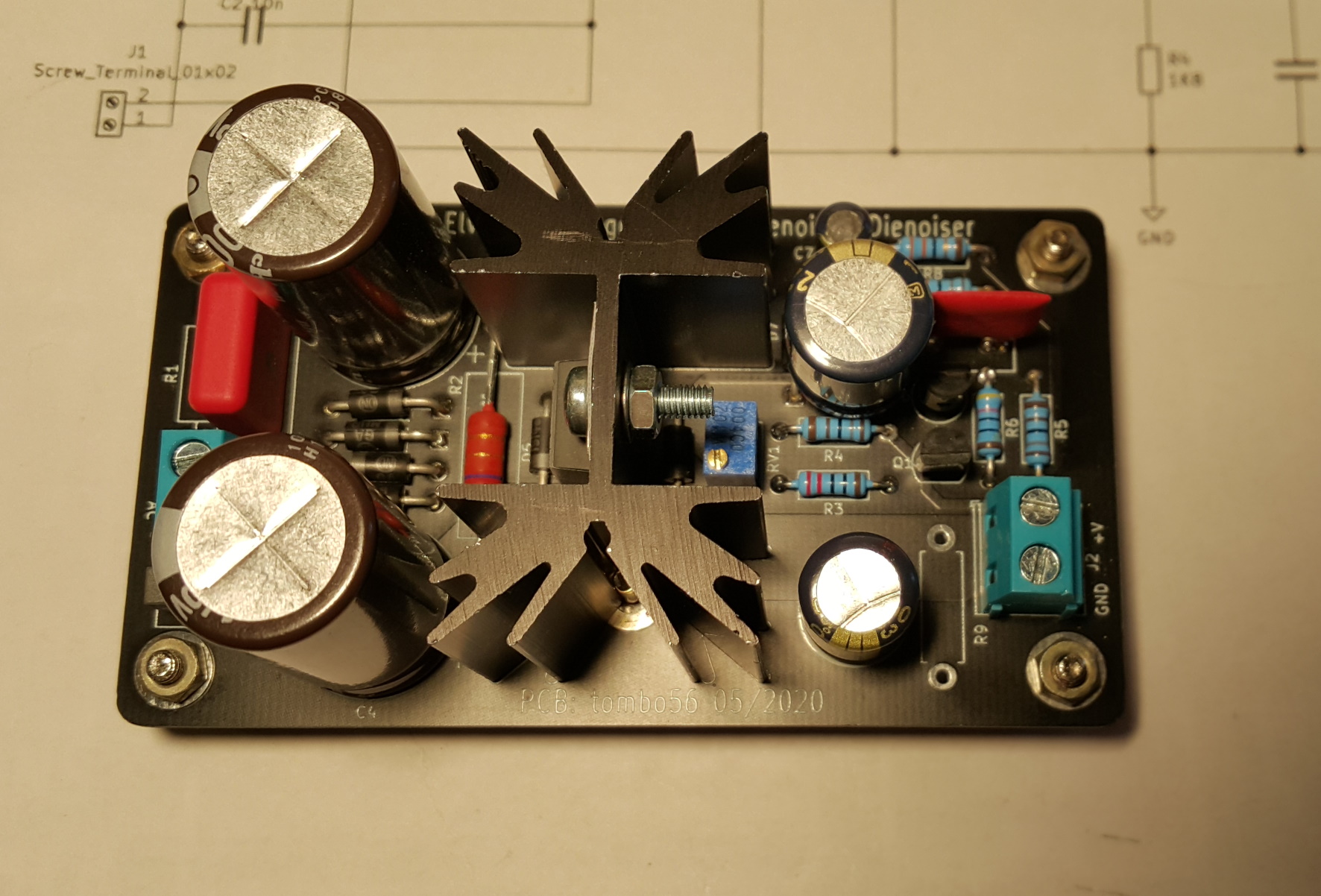

I’m happy to confirm that my single rail dienoiser design is working good. First tested deliberately without compensation capacitor at 60 mA, 120 mA and 11 to 17 V output voltage. Everything was stable and no oscillations spotted.
No min. load resistor was used as voltage divider and denoiser circuit draw around 10 mA, which is more than needed.
With compensation capacitor tested at 60 mA, 120 mA, 370 mA and 1,1 A. Pass OK.
I have no equipment for measuring noise levels but, based on Elvee’s measurements it should be around 2 µV with BC transistors.
There will be, very soon, second revision of PCB with pilot led at the output (noise proof), place for 18 mm diameter reservoir capacitors, some different pad dimensions or pitch and one good idea borrowed from Mark Johnson’s VRDN (you can always find some good ideas in his designs). Output capacitor will have in series position for ESR adjusting resistor or jumper. Therefore, it will be possible to use big capacitors or long life ones that usually have low impedance.

Excellent Tombo.
Your board I ordered is still on it's way and JLC haven't quite finished my onboard design yet.
Worrying to hear the Sziklai pair aren't as stable with the LDO's. Hopefully not the case with the LM317. Either way, the second transistor can be easily jumpered.
With a 10kHz BW and just a BC337, the measured noise was 0.3µV.
Should translate to 0.4 ~0.5µV for 20kHz.
With a ZTX or similar, this can ne halved

Maybe it's a problem with LDOs only, because Tombo didn't see any oscillations.

Bohrok 2610 also experienced oscillations using the Sziklai pair on LM317.
My first test was with no compensation capacitor across transistors and yet, regulator was stable in varied voltage and load range (though not tested to full capacity) and no measured oscillation. With compensation capacitor, it should be very stable.
I wonder have cdsgames used in test new board with optimal layout or add on module. Maybe, Kelvin connection and overall layout has greater effect on circuit stability when using transistor pair?
