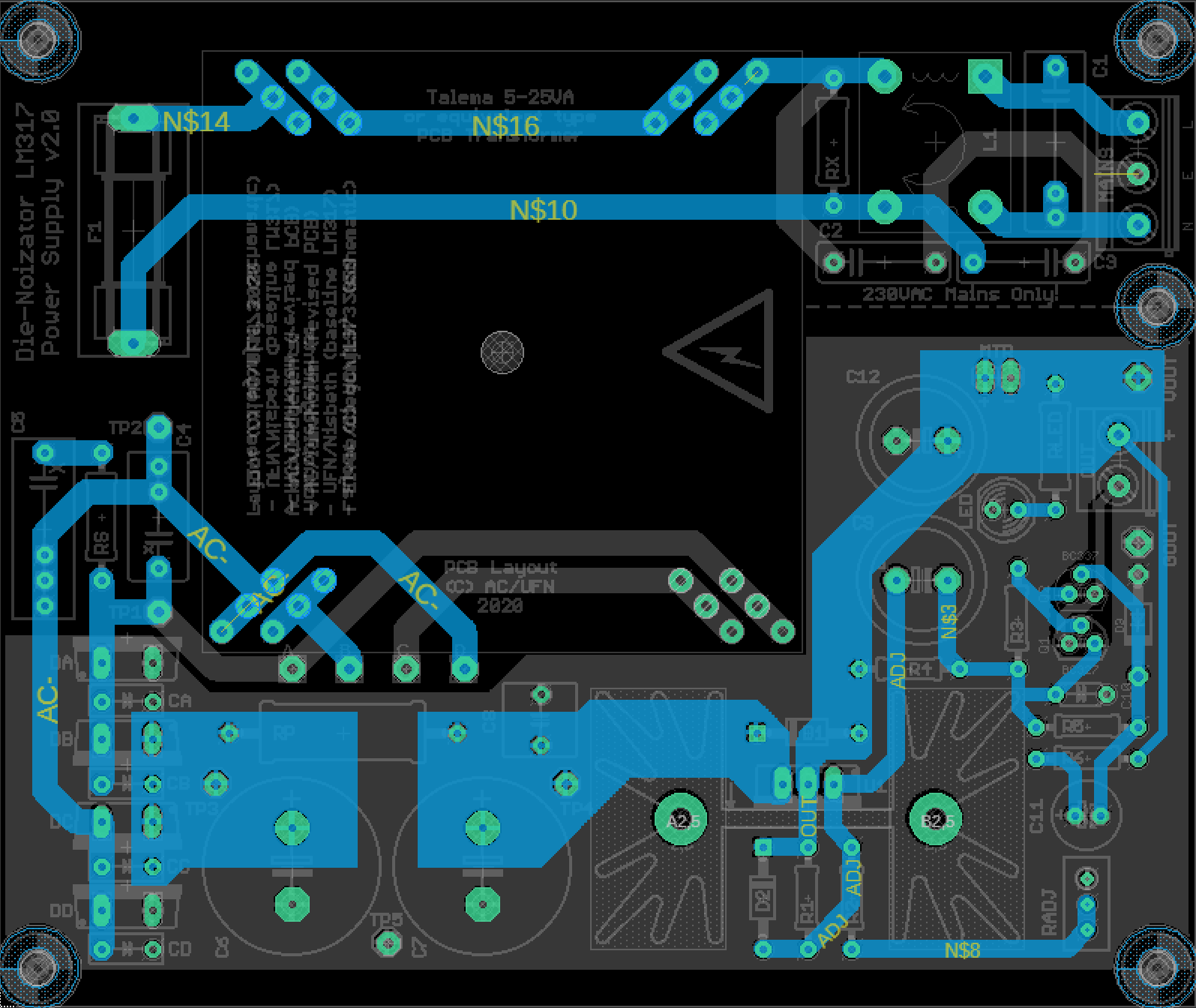

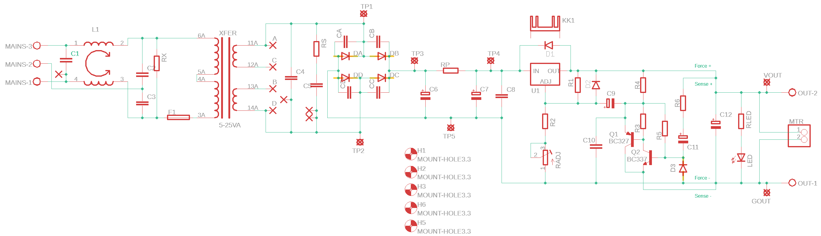

D-Noizator: a magic active noise canceller to retrofit & upgrade any 317-based VReg

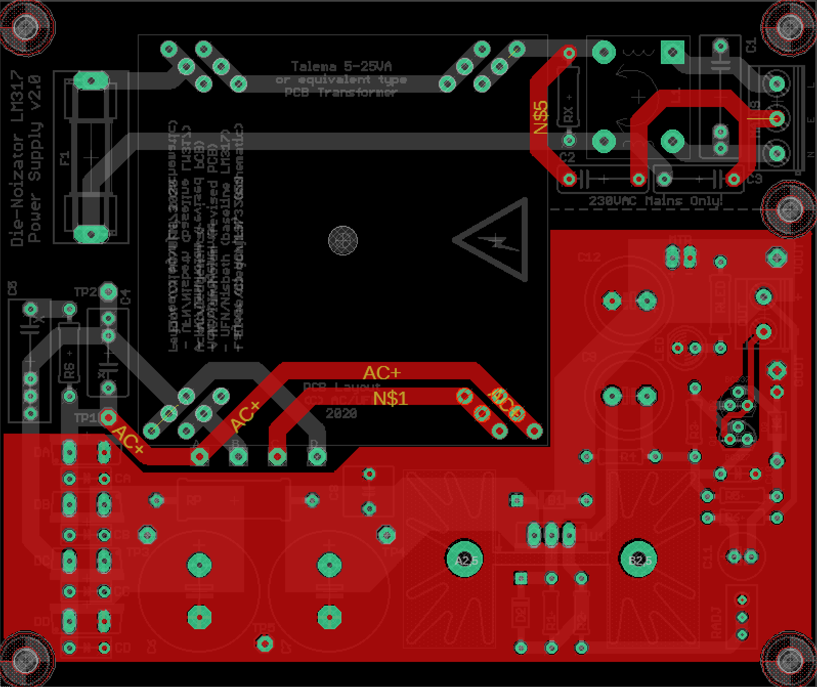

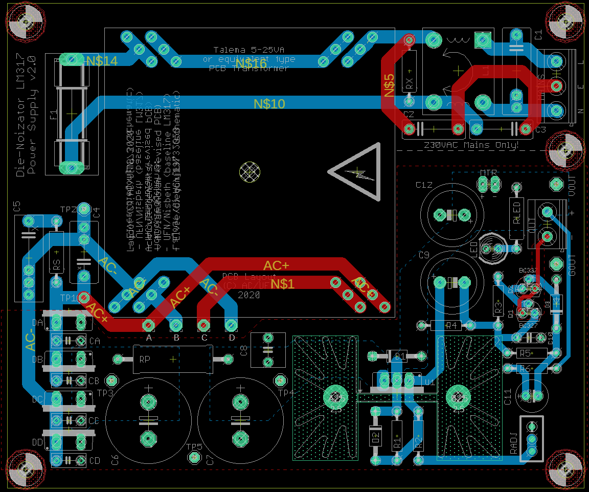

Here is my final solution. Comments about the board noted and addressed.
Secondaries can be customised for parallel (A+B, C+D) or series (B+C). I've experimented with custom primary jumpers, but it looks rather messy, so this is 230V for now. Would be responsive if people are really desperate for 110V.
attachment.php
Has been really fun and an enjoyable learning experience. Thanks Nisbeth for letting me loose on it 🙂
Gerbers attached, UNTESTED, but verified error-free in Eagle.

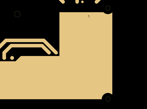

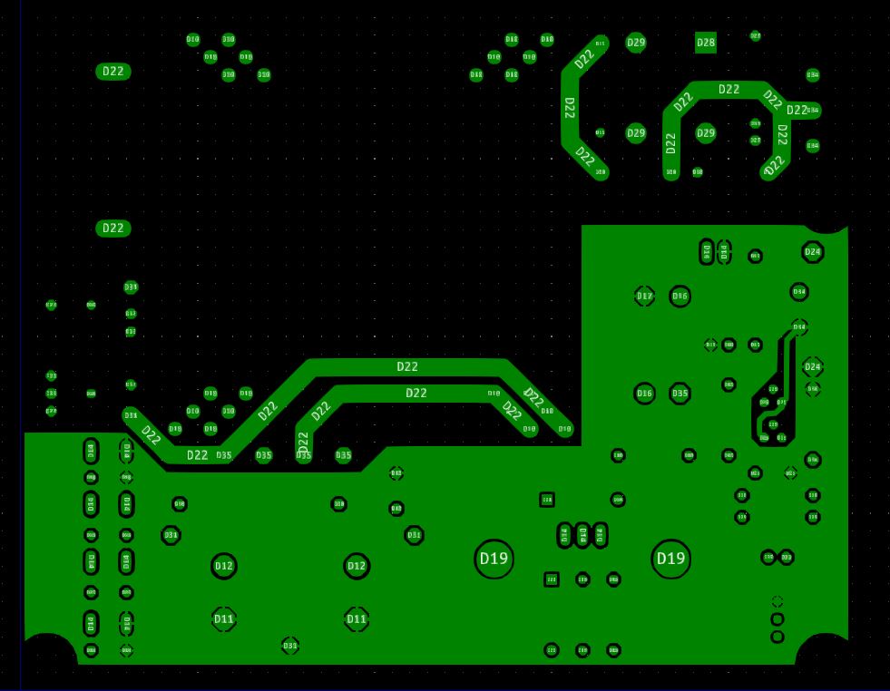

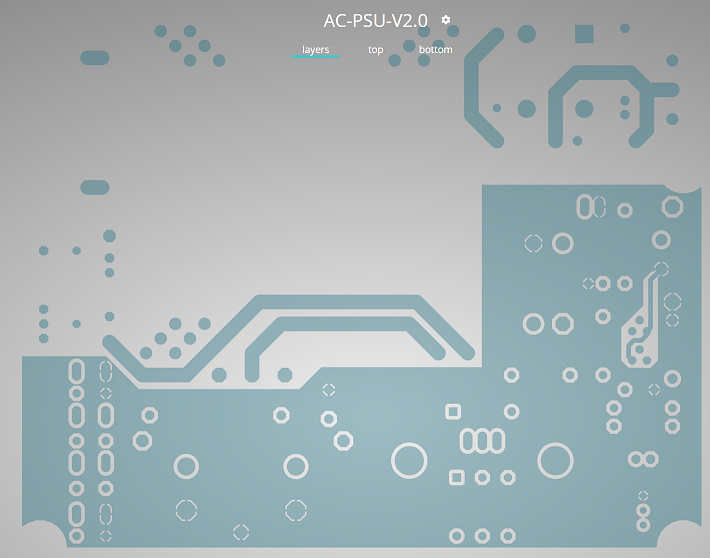

For some reason, the polygon pads look filled on the copper layers in most free online Gerber viewers but are correctly isolated on PCBway? Not sure why. Going to take this to fabrication in a couple of days.

Looks very good.
May I ask why will you order from PCBWay?
I’ve recently switched to JLCPCB. Your design is 40$ at PCBWay and 7$ at JLCPCB. I’ve ordered mine from JLCPCB and quality is excellent. Both ship with DHL Express at same price.

I'll probably use JLC. I bought your board from there, awaiting shipping.
Just wanted to check the Gerbers through different places. Only PCB Way showed the isolated pads.
Otherwise JLC, pcbxprt.com, gerber-viewer.com - they all showed filled pads on the copper layer. Not really sure why.
I did check wih KiCad gerber viewer and it shows as OK. There are some warnings of unexpected characters on job file, but that could be some difference between Eagle and KiCad.
If you don’t use latest Eagle version, it could be good to upgrade (if possible) and check again.

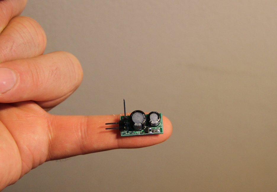

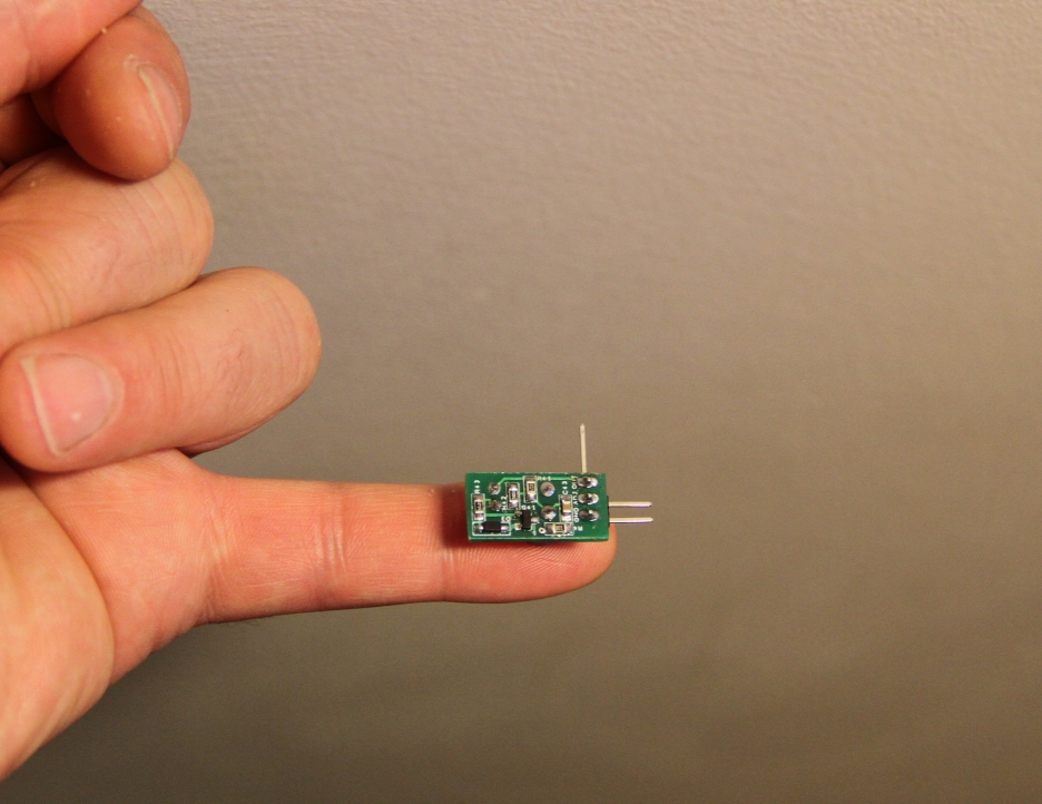

Thx for your effort and yes I think it is quite fun and learning from this as my great interest in electronics and hifi😊
Initially, what I had in mind when designing the project was a tiny (probably SMD) 3-wire add-on module that could convert any "normal" 317 regulator into a superreg (kind of), cheaply and easily.
I guess this layout is more according to Elvee's original vision 😀
Electrolytics are Nichicon low-profile (100u/35V and 22u/35V).
It is a dienoiser with denoiser stuff in the bottom and dienoiser add-ons on top. However dienoiser seems to be very prone to oscillations and I could not measure any real improvements agains denoiser in practice. So I will probably only use it as a denoiser.
YESSS!!! Exactly
Very clever
That's strange: I didn't use the dienoiser in reality, but I tested it on a breadboard (which is normally more demanding), and apart from requiring a larger compensation cap, it looked perfectly stable
That's so lovely! Amazing work of miniturisation 🙂
About the oscillation from the Sziklai Pair: Presumably you used a decent C4 value and reasonable ESR in/out caps?
