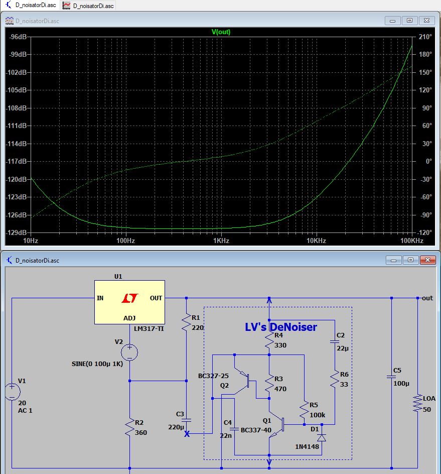

D-Noizator: a magic active noise canceller to retrofit & upgrade any 317-based VReg
Here are the values that simulation predicts to be good for the 3,3V output. It is roughly the same for 5V, except R2 value.

I can provide the single rail version (LM317) with Sziklai transistors pair, in this thread referenced as dienoiser. PCB uses both copper sides, for low impedance, and has proper Kelvin connection. There are positions for snubber parts as is hard to expect maximum performance without it. ATM, it is untested as well. I have ordered PCBs at last Friday from JLCPCB, but won’t assemble any immediately. Only after several weeks I could confirm if everything is in order with the design. If there is an interest or urgent need, let me know an I will attach gerbers if you are willing to try. PCB dimensions are 50 x 90 mm.

Just the base and the collector resistors, but there is only 1 ~ 2dB to be gained

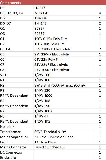

Preliminary BOM for adjustable 12.1 - 15.0V on Tombo56 Single Rail Board Here
attachment.php
Resistor tolerances very conservative. R5 is 1/2W to allow for 24-30V. R2 3W gets you to 950mA before burning. I haven't measured your lead or radial spacing so haven't exactly matched specific components, yet. Will post the full BOM when ready.
Other voltages
- Change capacitor tolerances, R4, R6, R9, and transformer.
- R4, R6, VR1: For quick reference visit https://www.diyaudio.com/forums/pow...fit-upgrade-317-based-reg-11.html#post6054925
- R9 dependent on voltage, to maintain constant current draw of 5-10mA. Classic equation of R9=V/0.01
Notes
- R1 can be fine-tuned for specific transformer, but 100ohms is a good start. See Simple, no-math transformer snubber using Quasimodo test-jig
- VR1 is also optional if you want fixed voltage (requires jumper).
- Add in some mains suppression X/Y caps.

This project was tailored to my specific needs and, becoming public, it needs some adjustments depending on output voltage and load current. This is well enough covered in this very good BOM list but some additional comments are needed.
For lower voltages, C3 & C4 can be of a bigger capacity, available up to 10.000 uF in the 16 mm diameter envelope. I will use 3.300 uF/25V.
C5, C7, C8 will likely need to be 50V variants to find ones with pitch 5 mm and 2,5 mm.
R2 should be 1 to 2,2 ohm or, depending on load current I would keep 1 V voltage drop across it. My intended use is low current, hence this high value on the schematic.
Heatsink is Fischer SK129 series with length from 25 mm to 50 mm

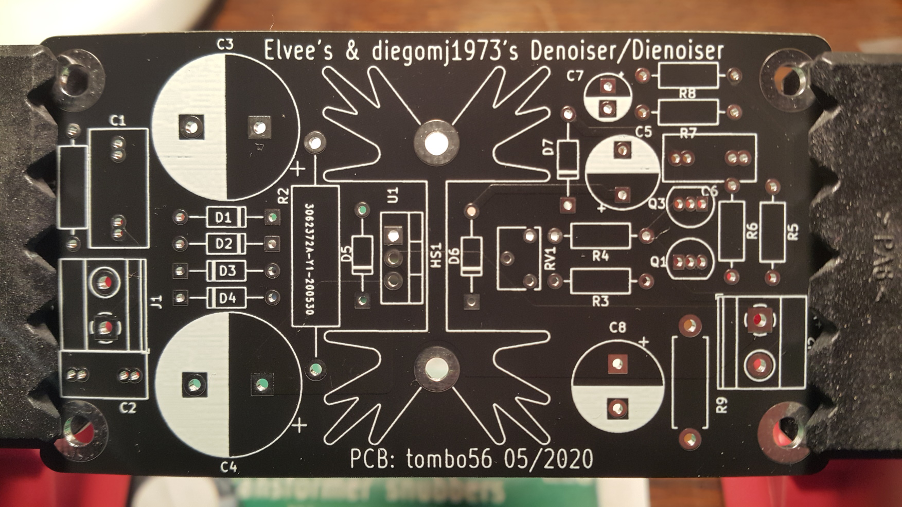

PCBs arrived yesterday. I hope that I will be able to confirm design working till next Thursday.

Thanks for the additional comments Tombo. Sorry, didn't have time to measure the Gerber lead spacing yet, so this is very helpful. Hopefully everything is covered now 🙂
I didn't want to get into tweaking the pi-filter too much, but yes increasing the capacitance is preferable. However, for same reason, so would keeping R2 reasonably high? (with a higher power rating sacrifice). A cut off around 5-10Hz seems reasonable? (a bit off topic, sorry LV)

Just a quick thought, sorry if I'm wrong but just wanted to double check. I was looking at my Eagle libraries. I'm trying to design something with transformer on board, and will release some details soon.
Is BC337 pinout incorrect in the default library? Datasheet says CBE:
1 - Collect
2 - Base
3 - Emitter
However, Eagle and your board seems to be configured for EBC.
Seems like a common problem: https://www.element14.com/community...ut-editor-pnp-transistor-e-and-c-pins-swapped
If so, obviously not a huge deal, just need to mirror the transistor upon assembly.

It’s morning and not enough coffee circulating my blood stream 😀 but BC337 pads seems to be right. Pin 1 is collector and it is connected to the R6. Pin 3 emitter is connected to the ground.
As for R2, there is no place for higher power rating resistor. I will use 2W. RC filter is not primary for increasing PSSR at 100 Hz but for maintaining good PSSR at higher frequencies, thus filtering HF noise from rectifier and mains.
One additional note: MUR 120 diodes are good up to 300 – 400 mA load. For higher current I would use SBYV27-200 diodes.
