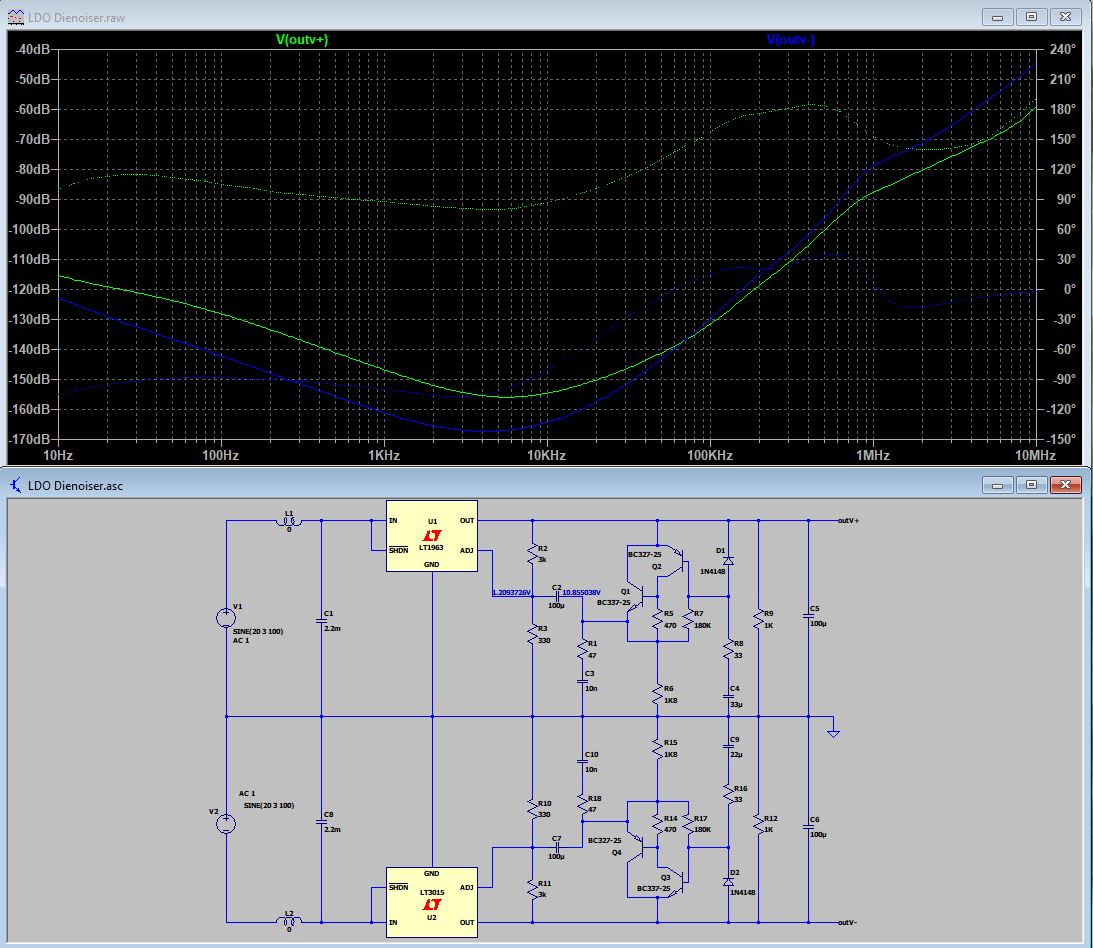

I was just checking my simulation files, and also doing a search (not page by page) of the D-Noizator topic, and I couldn't find a good implementation, better than with 317, for the LT1963. Is there one?
I’m using attached one from Linear Technology. Can’t say how close this model is to real regulator but, at least, it gives nice results.
LT1963 is green line.
I do have the 1963 model on my LTSpice library.
Can you send me the asc file for that simulation you uploaded?
