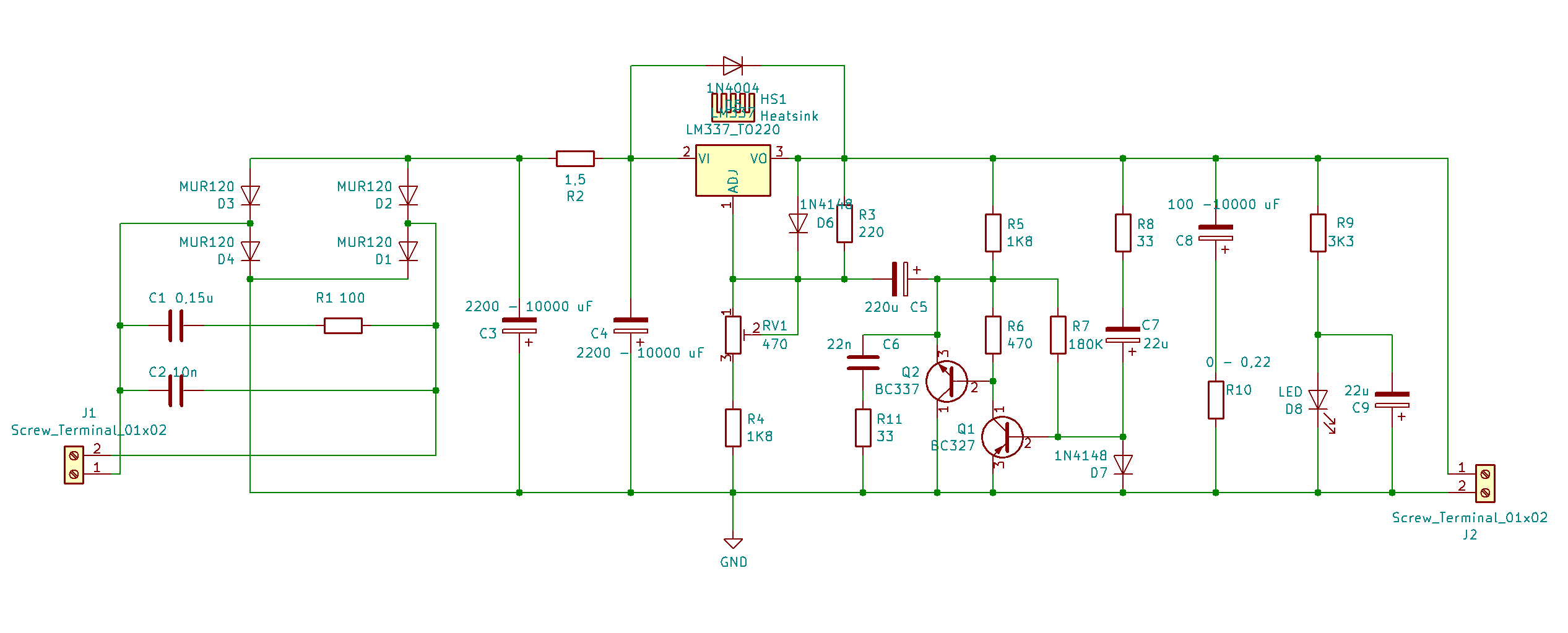

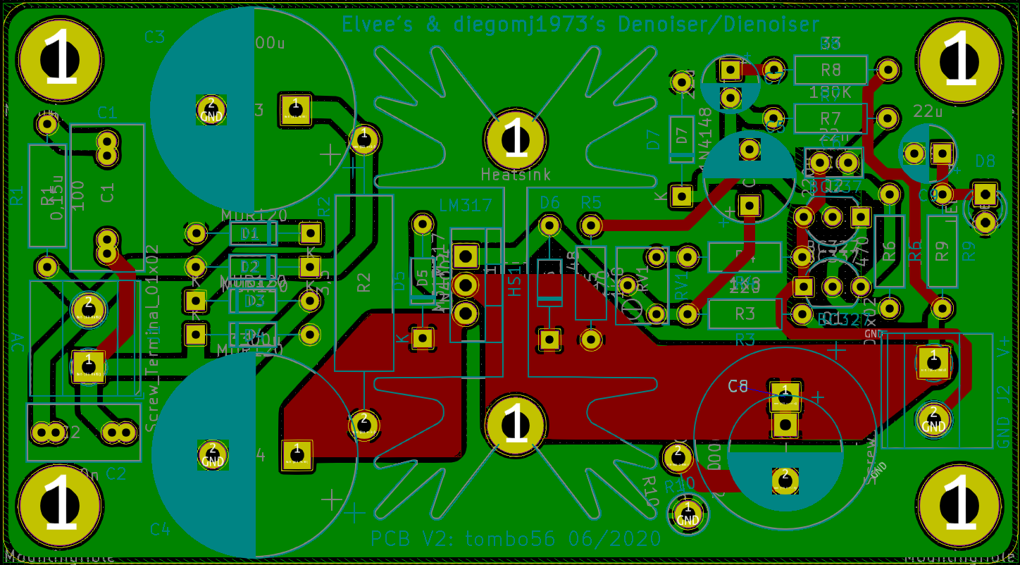

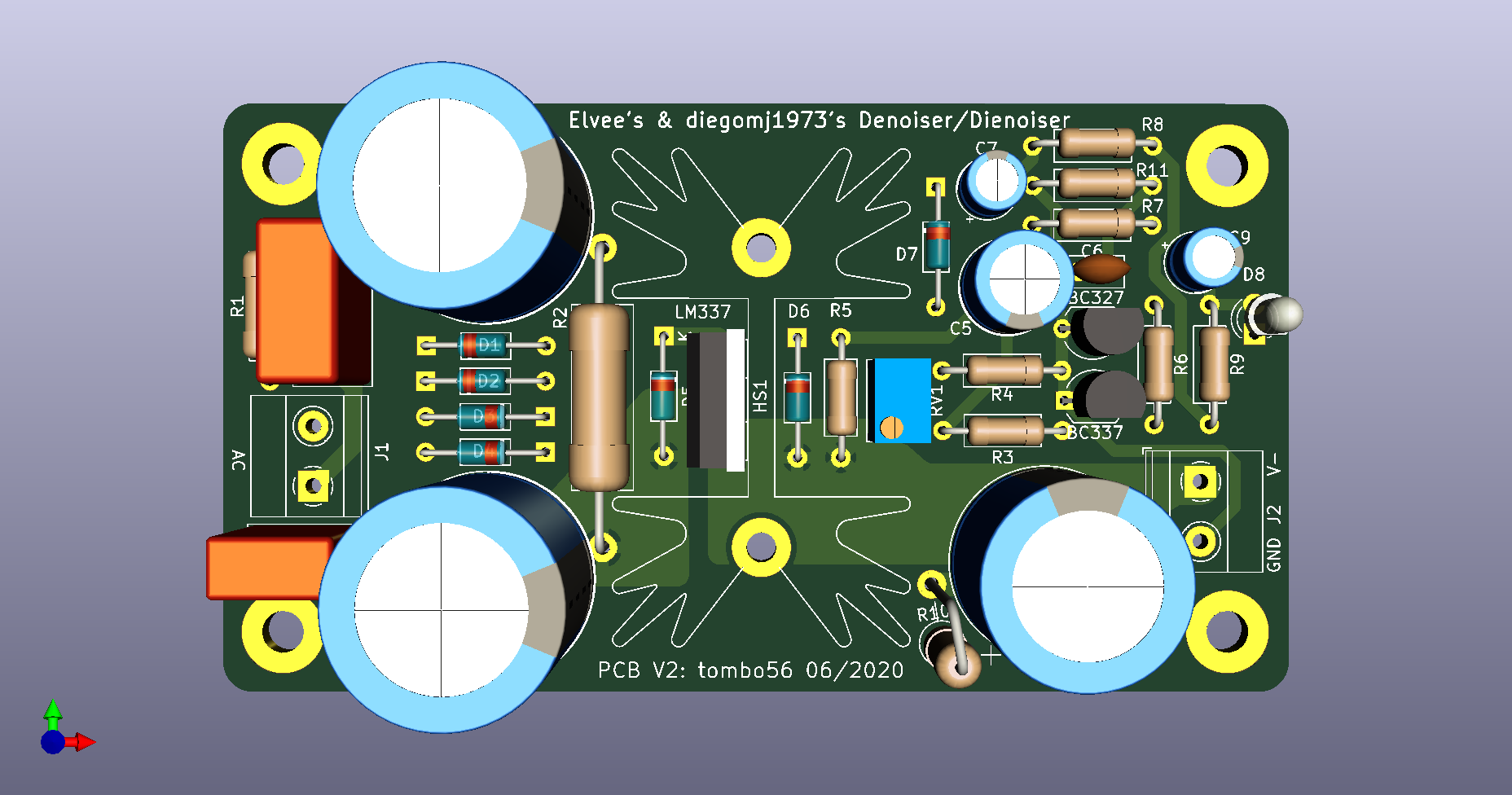

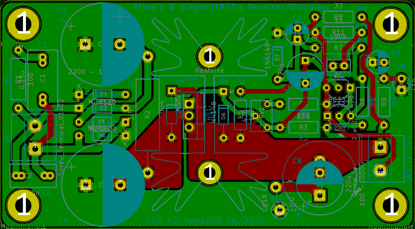

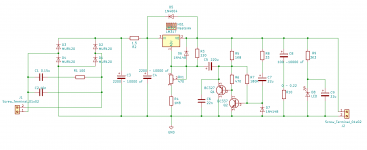

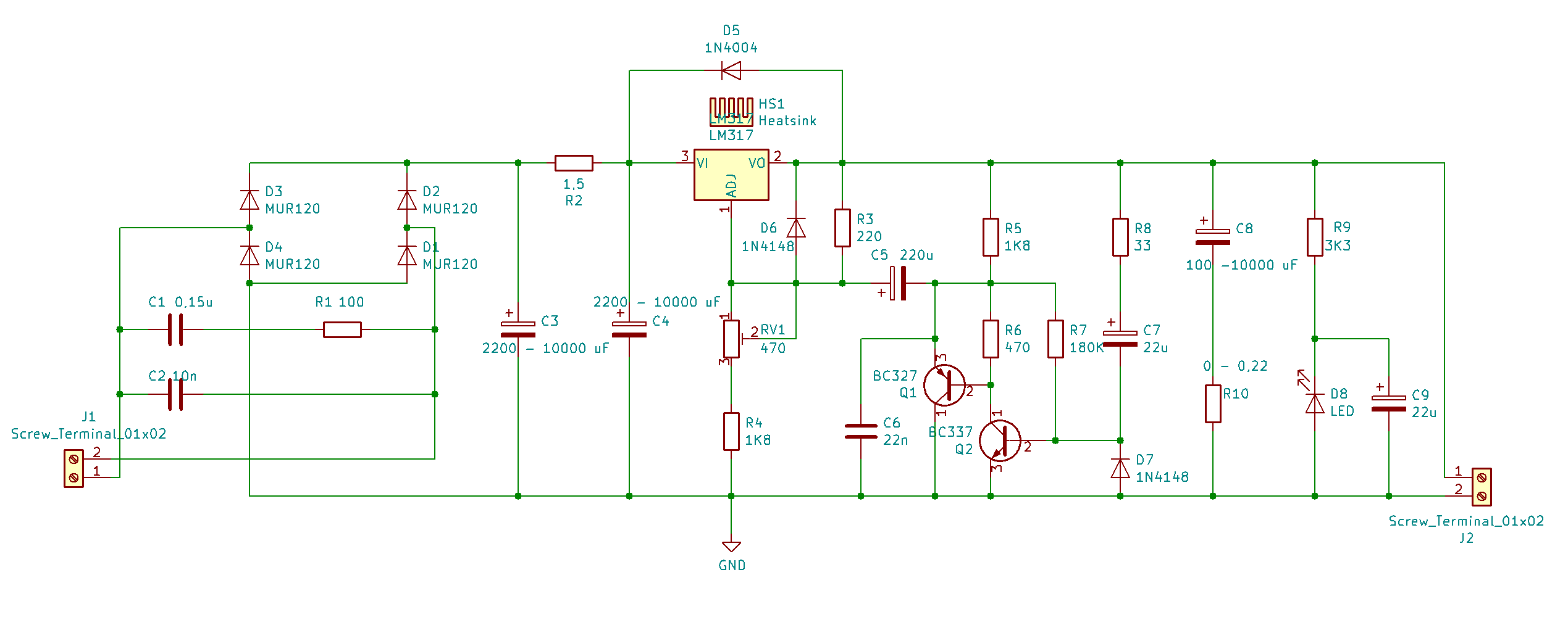

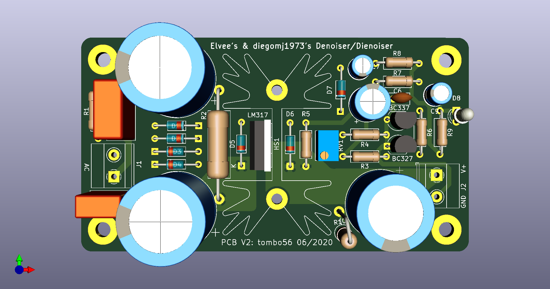

LM317 regulator design is supplemented with negative rail LM337 design. It uses same layout as LM317 with minor necessary changes. Compensation capacitor has resistor in series. As kumori determined, LM337 dienoiser is stable with combination of 20 nF + 27 Ω and output capacitor ESR around 300 mΩ.
I decided against both rails on the single pcb, as separate pcbs provide flexibility and I don’t have to design 3rd pcb. 😀

@tombo56 Thank you for your contributions to thread. Btw, separate pcb means two independent transformer windings (or transformers) without center tap. Two positive regulators is just enough if we are going two use two separate rails since we can use positive rail as negative one. Negative rail only makes sense in combination with positive rail with center tap transformers in practical aspect.

Please be aware: I always referred the de-noiser (not die-noiser). Also, the compensation with lm337 could be less eventually, for example 10nf and 10Ohm. I did not test all iterations, but was happy that it worked at some point. Of course your pcb is prepared for every scenario, so this should be no problem.

Reversed LED polarity error
While adding LED pilot indicator my brain decided, without notifying me, that LED diode should be reversed polarity like Zenner diode. Today, some leftover brain cell kicked in and I spotted mistake.
If anyone ordered the pcbs it’s no big deal. Just mount LED in reverse to markings on the silkscreen. Corrected gerbers in attachment. Sorry for any inconvenience.
