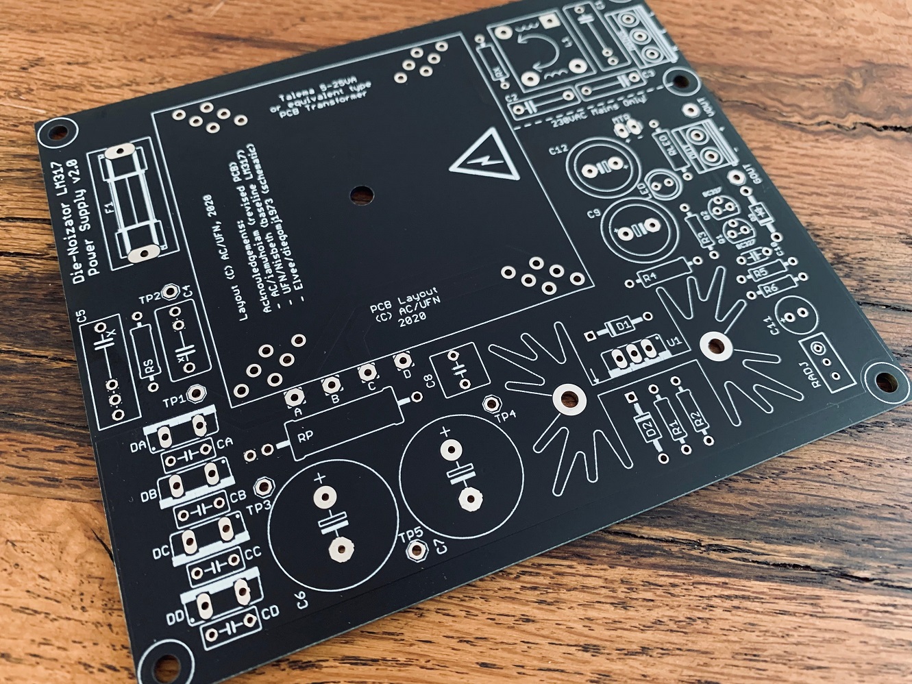

I've sent one to Nisbeth, and have two spare if anyone is interested to test them out (non-profit fabcrication cost only). They are 120x100mm on board transformer, single rail, 230v. More info a few posts back

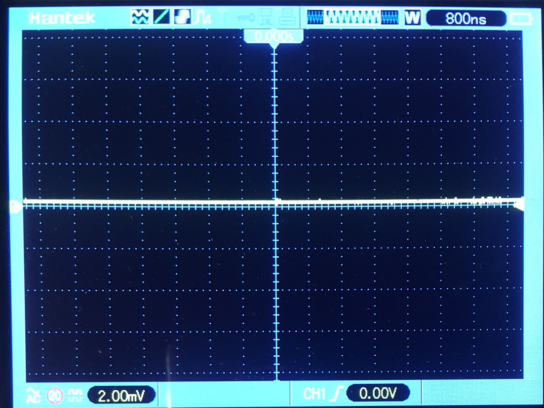

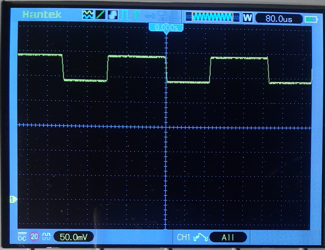

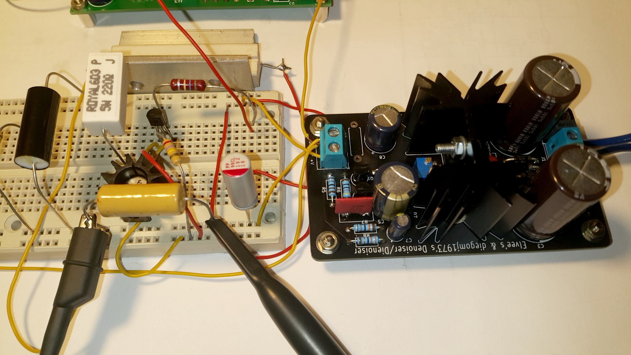

Dienoiser stability under very low ESR load
There was question whether regulator will be stable with attached load containing a capacitor with very low esr (organic polymer for instance). Short answer is: yes, it is rock stable.
After receiving today 1000 uF/8 mΩ organic polymer capacitor, I prepared test contraption worthy of best Grunf’s achievements. BTW, Grunf is comic book character famous for his inventions made of junk that spectacularly fail during secret agent’s missions.
Output load was 250 mA constant load + 2 kHz 50 mA square wave dynamic load. Even with 6 cm long supply leads to the load with 1000 uF/8mΩ capacitor, it was impossible to spot any oscillation using oscilloscope and small AM radio as sniffer. There was some small AM noise, as square waves are involved, but noise was originating from the proto board with load and not from the regulator.
Organic polymer capacitor was then moved directly to the regulator’s output connector and after that directly in parallel with 100 uF output capacitor. Again, no oscillations at all.
Output voltage is stable and visible noise is in fact environment noise picked up by crappy oscilloscope probe that came along with the device. I will order decent one.
All measurements were done with 1 MHz low pass filtering.
With 50 mA change, output voltage was varying around 1 mV.
As we were discussing instability/oscillation problems recently, those findings paint another picture.
That's not really bad, but it leaves to be desired: it represents ~0.02ohm, which must be about the same as the naked 317.
The denoiser should push that below 1milliohm.
There might be some wiring/connection issue degrading the output impedance

Just not to leave the cat both dead and alive, I made another observation on voltage variation under load.
Using 500 mA square wave load at 2 kHz, oscilloscope probe was placed directly at the regulator’s output connector. No discernable voltage variation was possible to spot, even using average of 32 to 128 measurements and low pass filter. So, voltage variation is below acquired environment noise level which was 240 µV PP with filtering and averaging. Therefore I assume that voltage variation is, at least, lower than 0,2 mV.
That gives the worst case output impedance of 0,4 mΩ @ 2 kHz, what is in line with expected.

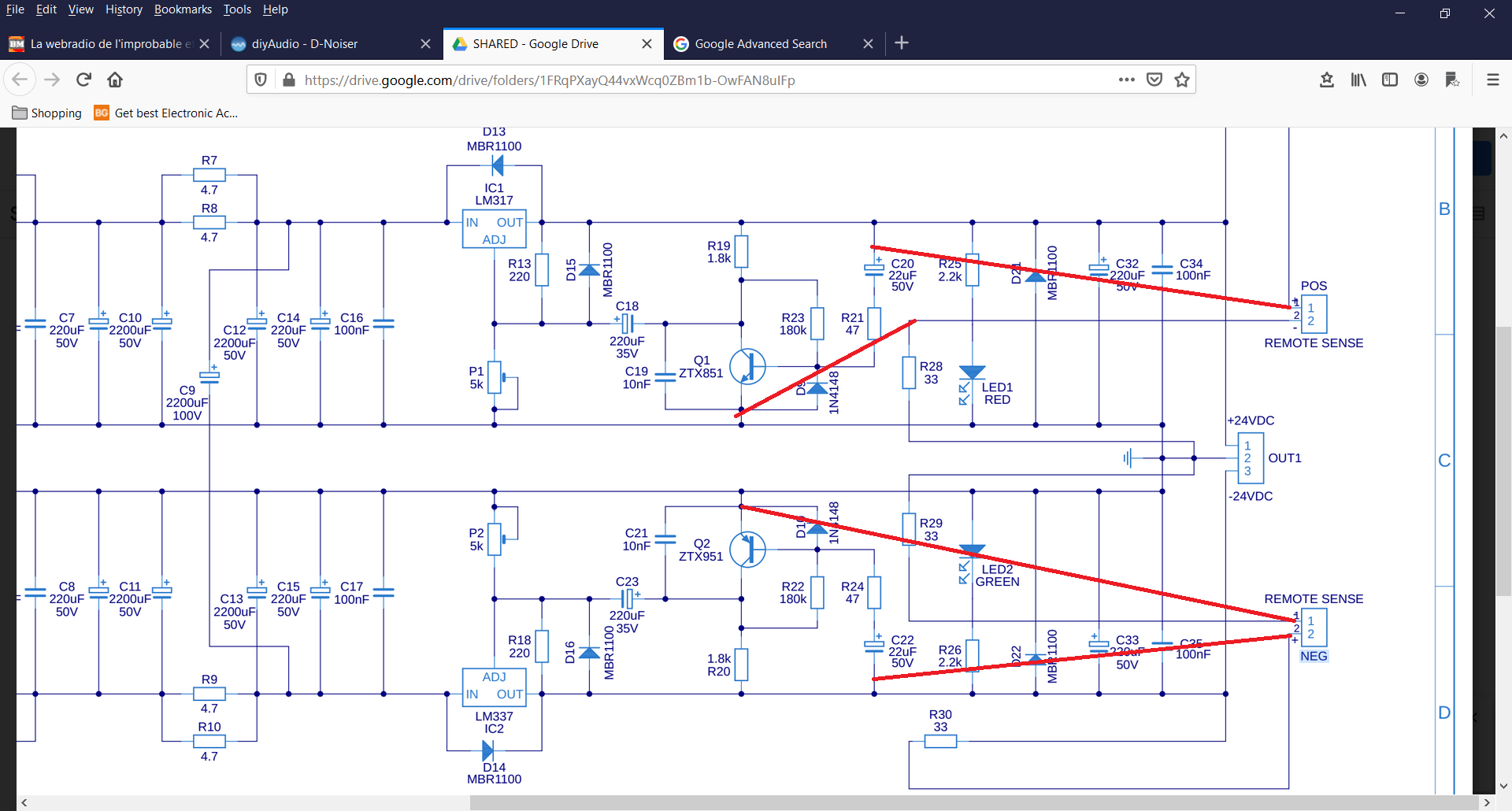

Here is the answer to a question asked via PM: how to implement remote sensing with the denoiser.
This has already been answered earlier in various forms, but here it is again:
attachment.php
That said, it is probably preferable to locate the denoiser remotely instead of using long wires to connect it: that is the way it has initially been designed for, and using long connecting wires could result in VHF instability (a few cm is OK, tens of cm could be problematic).
BTW, for general interest questions, it is preferable to post them directly on the thread, as it can be useful to other members, and PM's do not allow attachments
