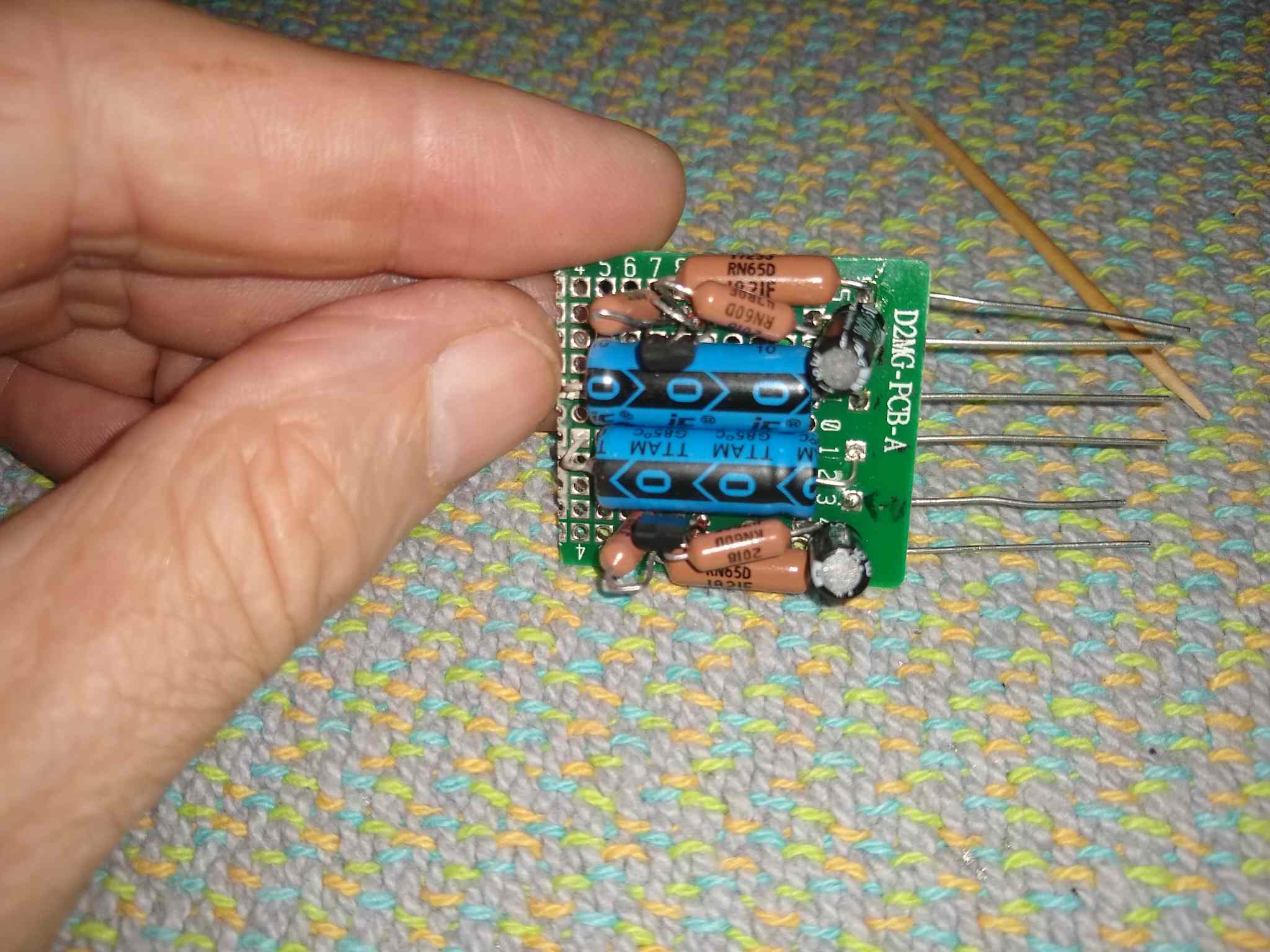

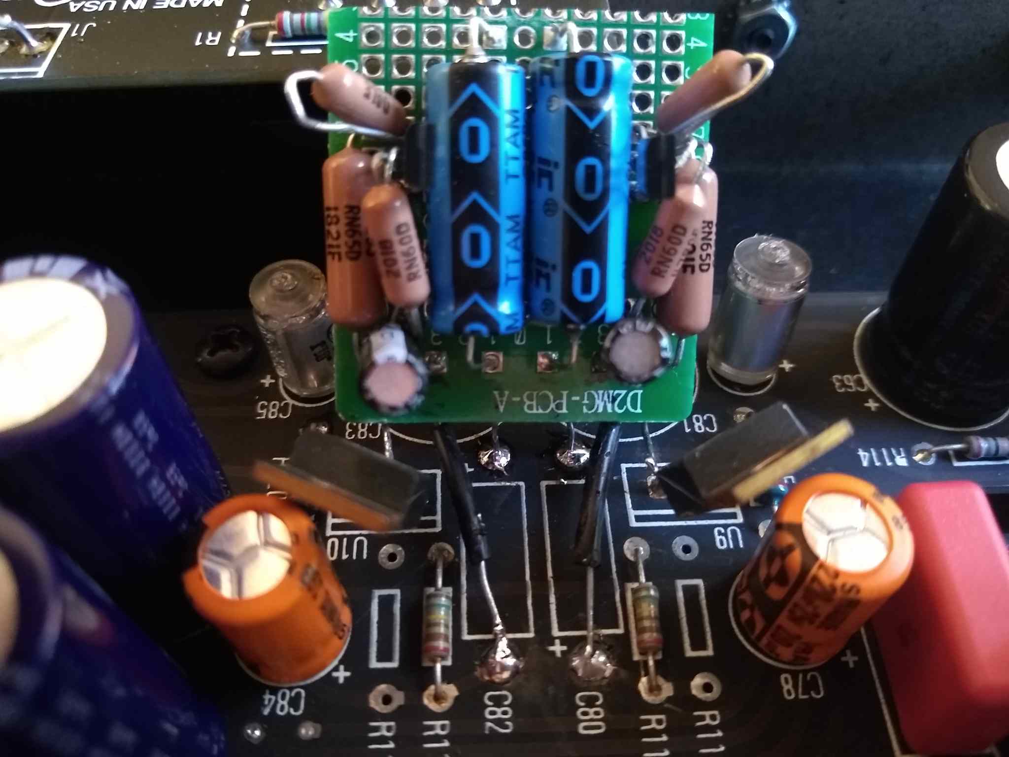

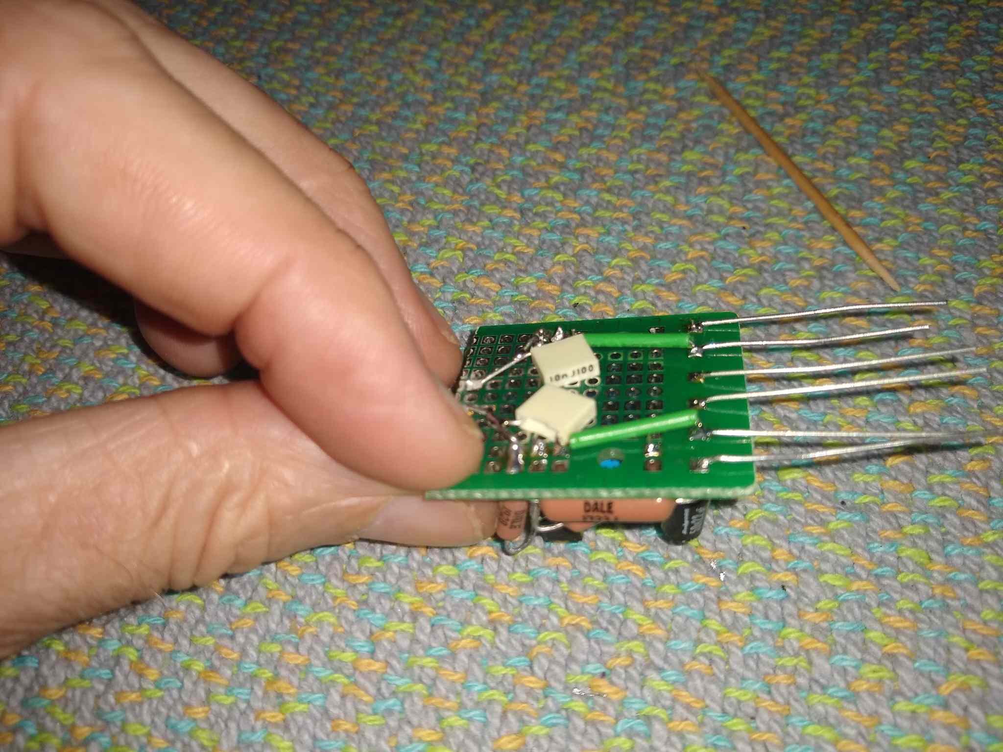

It seems we were implementing a similar way for the D-noizator and the Dienoiser, using prototype pcbs for them. I used DipTrace to place the parts and join the connections.
Only one side of the pcb was used for the solder side on both versions. It ended up quite small and clean.
I didn't get any comments about them.

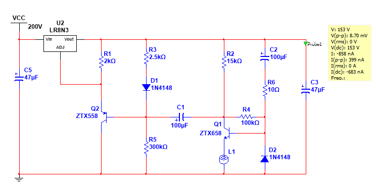

HV D-Noizator
I have a bunch of the LR8N3 HV regulators -- will only dissipate 0.75W (the TO-252 package will do 2.5W). Very handy as a high voltage current source, but no champ when it comes to noise.
This regulates, but I have yet to test it for noise, PSRR and Z-out. The first version I built oscillated at 61MHz! There is only a faint trace of oscillation in this version:

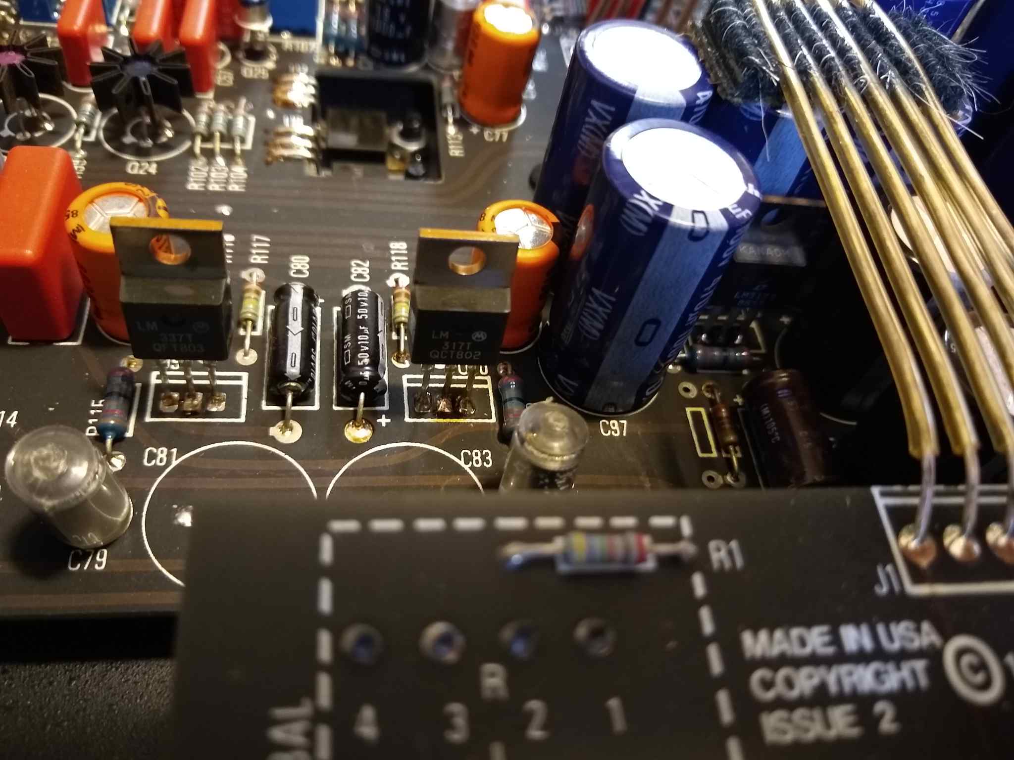

When Jackinnj pointed out very high freq oscillation experience, I started thinking my 10mhz scope may have missed something. Didn't see any problem oscillations. I re-read the thread because I remembered something about an optional resistor for stability in the lm317 denoizator. Some here built nice compact units, mine was made with through hole parts and no 33 ohm stabilizing resistor. Perhaps an example of a "Layout blunder", susceptible to oscillation. Sooo, after installing the 33 ohm resistor, I tried it out again, installing the one denoizator powering only the preamp portion. BINGO, now we are getting somewhere. It works. Just a suggestion that the resistor be included on any layout build similar to mine. Thanks LV and all for this nice enhancement!
Are you using LV's denoisers or Diego's dienoisers (i.e. with Sziklai pair)? IME and based on Spice simulations denoiser should be stable even without the compensation resistor. Dienoiser however is only conditionally stable so adding it to any 317/337 based power supply without careful study is asking for trouble. But adding the compensation resistor should make dienoiser more stable.
I'm using LV's denoiser circuit. The device PS I'm modifying has a 317/337 regulator for the entire device. This in turn splits into separate supplies for a MM, MC, circuits each with separate channel emitter followerer supplies, and also feeds another 317/337 set for only the preamp circuit. I first added a denoiser to the preamp 317/337 set. Some aspects of the sound improved, some not. I next added a denoiser to the overall 317/337 set. Within 10 seconds of listening, it was obvious something was wrong. Thus I searched for a reason why this had happened. I removed the denoisers, and the original sound returned. Upon re-reading the thread coming upon post 103 and 199 where it was suggested that a 33 ohm resistor could do no harm( final circuit). I added that 33ohm resistor, and re- installed the preamp denoiser. Clearly an overall improvement across the spectrum from the original circuit. Other than using ztx transistors, my denoiser is as in post 199. Certainly made my denoiser work well. Don't have the test equipment to analyze further. I will again add a denoiser to the overall 317/337 set after listening to accustom myself to the new improved sound.
