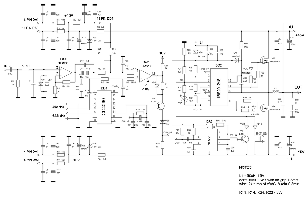

Hi Bender, your level shifter seems superfluously complicated. Zener+diode etc. Did you try simply dc856 +two res? BTW, BJT could be less warm, if its base =319_pin#3, emitter =319_output node, and 2kOhm from 319_output to GND. What is the goal of the R17;18? Try replacing R10 to 10kOhm, for 319 input current matching.
Hi IVX, you are right. Levelshifter came from early experimental proto (where i use low voltage BJT & experiment on rise and fall slope🙂),
So there is no any reason for such complicated schematics, 1 BJT+2 res function perfectly normal. Thanks for advice, i'll try to do it.
To be honest, i didn't think about R17R18
mehrdad, unfortunately i haven't free time for this project, i'll post all schematics & results later.

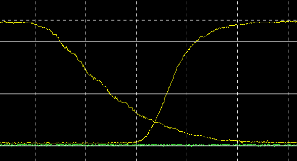

Bender.ru said:Too fast, too real![]()
What you mean? Too fast, to be real? 🙂 Actually it's absolutely normal speed for cascode.
I mean, that figure really nice.
For Trise=Tfall i use extra diode+res, i think it isn't necessary, but it was interesting for me🙂.
Bender.ru said:I mean, that figure really nice.
Indeed, this shifter will produce time assymmetry about 10nS (rising edge reached 1/2 Vcc for 10nS, falling edge for 20nS), that almost uncomparable to the total delay, e.g. lm319 already gave 80nS etc.

Hi mehrdad, you are right, SLayout simple editor, so there is no relation between schematics & pcb project.
Important note: central pin connected at TOP layer (GND) , but NOT connected at BOTTOM layer (TOTEM POLE).
Hi Gyula, here it is http://www.diyaudio.com/forums/attachment.php?s=&postid=1177100&stamp=1175843731
Good design. I also would like to design, but H-bridge with paralleled Schottkies at each FET, on two layers. But the track layout is still not so fine. I also would like to measure the current of the bridge, so current ringing must be minimal. Your design, with the ground plane behind the fets is so good. In the v2 design you doubled the fets, or put something new component to the board?

You use IR2110?? Hope to see schematic if you have it, and board someday...
I am compliting supply for my ClassD which also has IR2110, but isn't stable yet, making it now in SMD
