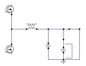

Workhorse...Just a question....How work your circuit at clipping, ie when their is no more carrier?

fredos said:Workhorse...Just a question....How work your circuit at clipping, ie when their is no more carrier?

Well good point, but I think Toino had given a Hint!
ECLER DT4800 monitors both the Inductor current and voltage across the Zobel capacitor to determine the conditions for triggering....
How can you have an image of current over the zobel capacitor at clipping when zobel act as impedance damper??? I miss something important???

It doesnot give you current image, but lets you to obtain the voltage across it....fredos said:How can you have an image of current over the zobel capacitor at clipping when zobel act as impedance damper??? I miss something important???

Measure the voltage and check the waveform accross zobel cap during clipping and also SC....
Hint: During Idle no signal 50% dutycycle conditions you will have a Triangle or sinus type waveform across that cap...but during abnormal conditions it changes....
Yeah, it follow modulation and give clipping image, but what about current image? Voltage accross secondary winding on output coil will peak at 25 and 75% duty cycle, with some variation depend of the load and reach zero volt at 0 and 100% duty cycle (clipping)...So how to protect an amplifier with this???

fredos said:reach zero volt at 0 and 100% duty cycle (clippingFredos
The Analog Signal Current is still flowing through the coil when subjected to short-circuit or overcurrent conditions
Check the waveform and measure the voltage across secondary, when amp is subjected to high Clipping+Overcurrent simuntaneously.......You will see a new thing....
I already try that, but core saturation at clipping make this signal to be loss...And core saturation is normal at low frequency clipping!

fredos said:I already try that, but core saturation at clipping make this signal to be loss...And core saturation is normal at low frequency clipping!

You have left one important parameter.....have you measured the voltage across the Zobel cap during Core Saturation[hard clipping into low frequency signals]....if not then do it...you are much closer to something....ECLER uses this both to get the info about SC/Clipping/OC/CS .....
