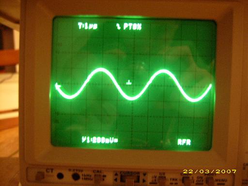

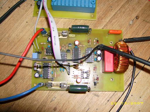

Hi everyone,
D amp Proto is running fine !
Dead time adjustments made...sound is great !
here are some pics of the proto:
post filter output voltage ripple 4Vpp@ 250kHz
no shoot through anymore ;-)
thanks Fredos

Hi everyone
just a little question for Fredos
with no load, the amp has sometimes trouble to start...
maybe because of the feedback loop : loudspeaker is part of the output filter ;-)
I think it's normal (amp with no load isn't a usual way to do !!)
Hi luka,
filter corner frequency is around 25kHz, and triangle wave is 250kHz
so one decade away...
LC filter is second order so 40dB/decade attenuation
So fundamental amplitude of output pre filter square wave is divided by 100 (40 dB)
so it should be around 2Vpp (instead of 4vpp).
DC bus voltage is +/-82V at idle
and +/- 74V at max power 4 ohms load

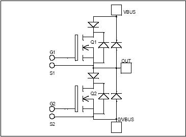

A much more promising device
Check This Out
www.microsemi.com/datasheets/APTM20AM10STG-Rev3.pdf
Series Schottky Silicon Carbide Diode + Anti Parallel Fast Recovery Diode + NTC+ 200V 100A Mosfet in HalfBridge all in one isolated package and also low EMI radiation
makes this device an ideal for high power Class-D Audio amps...I am going to order these for sample evaluation....
Hmmm... I wouldn't say ideal.
Check capacitances (input capacitance: 14nF) and the diodes characteristics...
Not really suitable output device for class-d amp.
I'd rather use simple high power mosfets. There are many good devices on the market.
The choice is yours!
All the best,
