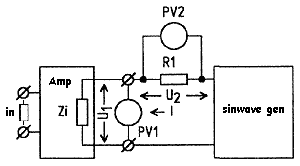

And how do you measure Routput? I can't just measure it with ohm-meter. Do you need to know Iout, voltage drop cross inductor + fet?
