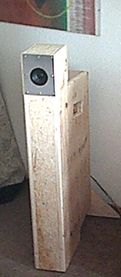

lohk said:I finished my new Cyburgs Needle a few days ago. I implemented the Tangband W3-871S.
I used the Tangband without the much recommended notch filter. Well all loudspeakers (and amplifiers) do actually sound so different one from the other, I do not hear any unbearable emphases with this one.
Thanks Bernt for that one.
Klaus![]()

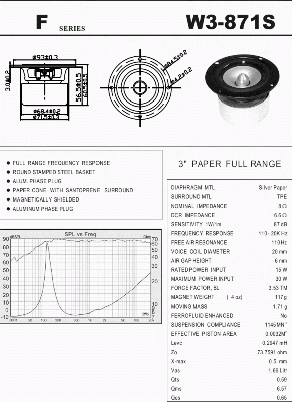

Klaus, I may be buying the W3-871S and plan to use it with t-amp, where can I get the demension/size and plan, is there a website?
thanks

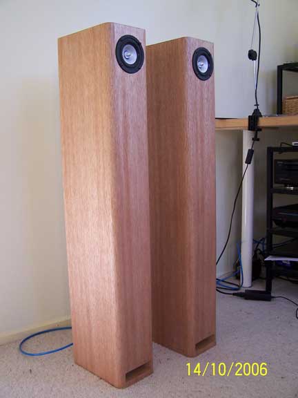

Here's a pic of a pair of needles I built a few weeks ago and for more construction pics follow link below
http://www.greenie512.net/greenie512/html/needles.html
Great little design - thanks Cyburg
