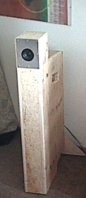

for small speaker try:
cut out larger than the driver,
glue the driver B or FL on
3-4 mm aluminium,
8 srews hold the felt
alu baffle.
like my TROMBONE

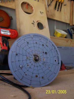

Routing out Baffles for Cyburg's Needles
Adamthorne,
A couple days ago you asked about opening out the back of the baffle on Cyburg’s Needles.
I used a 45 degree ½ inch chamfer bit with a guide bearing. Because I had routed out a recess running the bearing on the remaining thickness wouldn’t have given much of a chamfer (see right router bit in diagram attached).
I therefore cut a hole in some scrap the same diameter as the speaker hole using a home-made router compass, put it underneath the baffle and ran the bearing round it (see left router bit in diagram attached).
The photo under the diagram shows a test piece I made. You can see I’ve left material around the bolt holes. The pencil circles are approximately ½ inch diameter. These are a visual ‘stop’ when routing.
I don’t think this weakens the baffle much. There’s plenty of material left for whatever small compressive load you get from 4mm bolt.
If you need any more information please ask.
Mark

Doing it wihout a router ?
Hi Mike,
I think I've spent as much time so far making bits from scrap timber and MDF to make a better job of making the Needles as I have assembling the Needles themselves. Bits include :
- a router compass to cut the speaker holes and recess
- temporary extensions for the guide bearing when trimming the sides and tops
- an offset router base on which I rest a weight to stop the router tipping when I'm trimming using the guide base
How did you manage to make the speakers without a router ?!
Mark

greenie512 said:
Mike - don't know if you've got one but I wouldn't be without my Jasper jig for cutting driver openings.
I packed up yesterday totally "routered out" - see WIP shots http://www.greenie512.net/greenie512/assets/images/HT8-20.jpg (this ones not a full ranger)
tried to resist buying the jig but jig saw is not good for perfect circles in my hands. I have Hitachi router, hope it fits.
gychang
gychang
Yep - for the life of me I can not cut any where near even a slightly accurate line with a jig saw. Jasper come with loads of fixing holes for various routers. If yours isn't one of them - with a bit of care - you can drill fixing holes. It comes with a centring plate - so that should help.
I was somewhat suprised that I managed to get speaker mounting holes cut with a jig saw. Not that the lines look particularly nice, but the driver fits.
The dremel opened up breathing space for the driver quickly and easily, with the sanding drum. The MDF didn't put up much of a fight, I imagine plywood might have been a bit tougher.
I'm torn between trying to get a real router or the router attachments for the dremel. If you get (or already have) the dremel-router lemme know what you think.

I don't have a dremel, but my impression is on a plywood, does not work, since the project is too large.
I finally gave in and bought router and jasper jig, jig is on its way.
gychang
-A
I have a dremel router attachment, .. it works okay but a bit of a pain to use, . .mostly because the dremel is underpowered for this kind of work and takes a long time to eat away wood stock. I prefer my plunge router 1000% over.
Low-tech tools
Hole saws are available in sizes suited to make the speaker mounting hole, are inexpensive and safe to use.
Start the hole from the front, go half-way through, and complete the hole from the opposite side. Be patient (slow rpm, don't overheat the tool) and clear the sawdust very frequently (every few seconds).
A coarse round file works well to open up the back side of the hole and it is easy to leave wood where the mounting screws go. Drill a golf ball to make a file handle.
