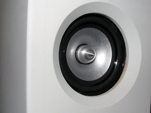

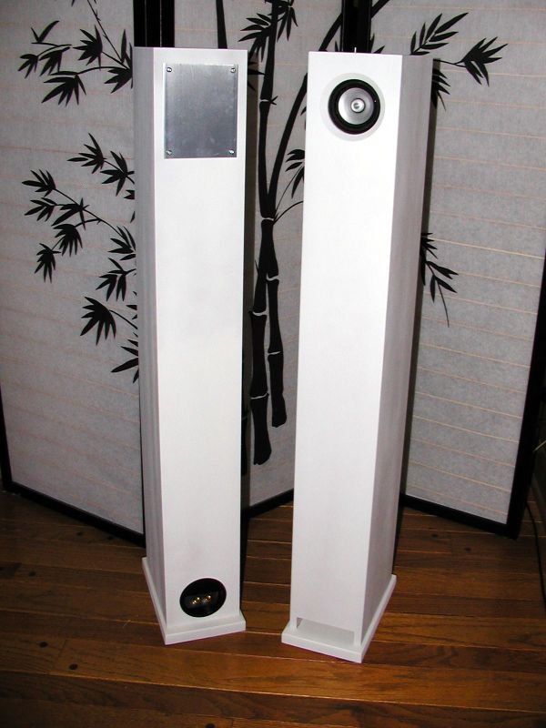

Behind the baffle
My Needles were constructed according to the posted
plans except that the W3-871S were mounted behind
the baffle.
I can't say what effect this might have on the sound,
however, I am very pleased with the project. As others
have said, the bass from this design is impressive
considering the size and cost of these little speakers.
Shown with a coat of white primer in the photos

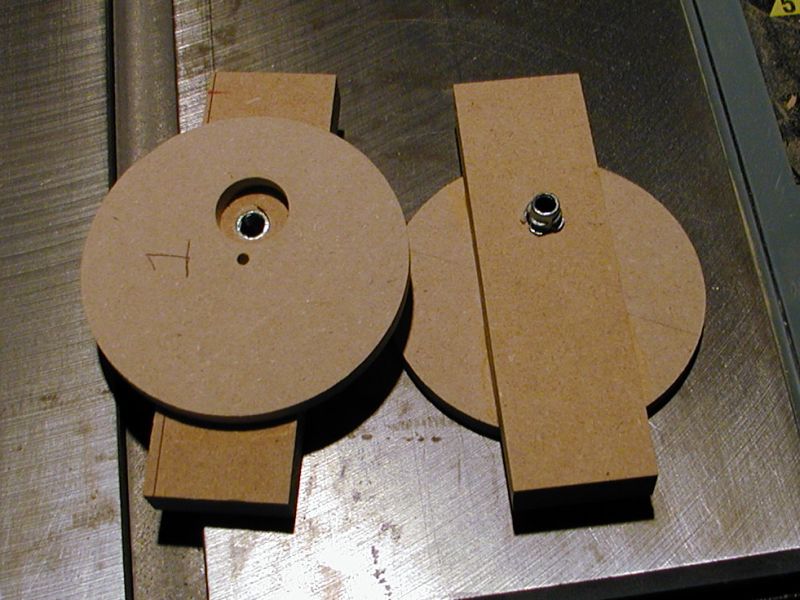

Metal Plate
Thanks, Svein_B -
The metal plate is 4" x 5" aluminum, 1/16" thick. It covers an opening cut in the cabinet back for access to the speaker and the assembly that presses against the rear of the speaker to hold it in place.
One of each of the two assemblies in this attached photo fits just inside the opening in the back of each speaker.
A threaded rod is used to apply pressure between the
inside of the back of the cabinet via the threaded insert assembly and a rubber pad on the back
of each speaker.
The speaker and all parts holding it in place can be
removed/inserted/adjusted for pressure after the cabinet is finished.
I saw speakers mounted from the rear first, I think, on S Linkwitz site - although not done in this way.
