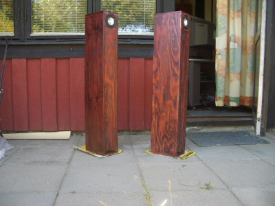

Hello all,
I'm planning on building a pair of Needles -- I'm very curious about their sound. They can also be made to look very pretty, as we've seen earlier in the thread. Here's some things I'm unsure about:
1)
If I were to put the notch filter in front of the amplifier, would I keep the same resistor, cap and inductor values?
I assume that parts specced for lower wattage and perhaps voltage could be used.
I'm thinking something similar to biamplification here (but as there's only one driver per speaker I guess it's uniamplification 😀 ) What I mean is a passive notch filter on the line-level signal -- I won't be putting the filter in an opamp feedback loop.
My idea is actually to build the vanilla notch filter into the speaker, but with a switch to bypass it, and then experiment with an RLC line-level notch filter, and some form of digital "crossover" in the computer as well. (BruteFIR or something similar.) Just to get extra education out of the project and a feel for the difference between these three methods.
2)
Would plywood be OK? Would any thicknesses or measurements need to change?
I'll probably use MDF, but I seem to have numerous friends with carpenters for dads. They might have scrap plywood, so that's why I'm asking.
OK that's it. Thanks!

Void free is recommended. I won't build any serious speaker out of MDF any more... with plywood you can most often get away with thinner material, but here i'd just use the same thickness to save having to figure out the changes needed.

I'm working at a brewery and when we get PET-bottles delivered they are piled on top of each other with chipboard in between for stability. Every now and then the supplier run out och chipboard and use whats handy instead. To keep this short they used 12mm thick plywood some weeks ago (5 layers) and those are now made into a pair of needles. In other words, I used scrapped 12mm plywood for my Needles, also at the top and base.
I drive them with a LM3875 gainclone with my computer as a source and this works fine. Since you probably, as me, will get the scap plywood for free just try this at first and if you like it then apply some nice finish. If not, put it in the scrap pile again.
Total cost: approx 60€

I actually came across your needles yesterday, I think it was over at hififorum.nu . They are NICE. They made me even more interested in trying plywood. Plywood has such a nice look sometimes, those swirls are really kind of psychedelic.
Put the notch filter "in front of the amplifier"?- I suppose it will work, but definitely not with the same part values, because you handle much different impedances there. Here you very likely will need an active filter solution.

lohk said:Put the notch filter "in front of the amplifier"?- I suppose it will work, but definitely not with the same part values, because you handle much different impedances there. Here you very likely will need an active filter solution.
My rudimentary research into the matter indicates that I will indeed need an active filter. It is seemingly possible to construct a line-level passive notch filter, but it would require an inductor several Henries in size.

I use my needles with a T-amp. And they sound wonderful, no doubt. But the overall loudness is low, the handling of complex heavily compressed music (most rock or pop music nowadays) is not very good - it sound very different to "normal" settings. I have tried it with and without the passive notch filter, the overall solution to a general use is still not fully acceptable for me, I could not "live" with a set like these as main speakers alone. The bass is not the problem, it is not dynamic enough overall. I also think - more a thought than scientific proof - that the combination here between loudspeaker and amplifiers is much more difficult and the different combinations sound often very diffferent indeed. Sometimes oddly different...
Your idea leads to a probably more practical solution. An active equalizer should be much better able to handle those discrepancies, baffle step and loadspeaker idiosyncracies included.
I do not have a practical solution myself, maybe to "rebuild" the notch filter as an active equalizer is not the best idea to start with. Maybe it would be better to start with a fully adjustable (professional) equalizer to (empirically) find out the right frequncy balance. But all that will definitely be more expensive than the passive filter.

I have never heard a Needle, but has done som alanysis, as many people are not satisfied with the Needles. This ended up with my own contruction, which I am very pleased with.
I named it TABAQ, Tang Band Quarter Wave.
Tang Band has my article about for rewiev for the time being, and I hope to me more informative soon.
I used Martin´s software to design the cabinet and the notch filter.
http://www.coolcat.dk/bjoern/needle_analysis.pdf

I have made a notch filter by 1.0 mH in parallel with 3.9 Ohm. This is for my enclosure, and might not fit the Needle. Placing the speaker at the wall, this is the right filter to use. For a free standing placement, 6db attenation will be needed. I do not recall the values, as I am at work right now.

I personally prefer the Tangband over the Visaton FRS8 to a large margin. It sounds quite ok in my Needle, but no better than that. The Tangband W3-871 is another league.
I also still prefer them without extra EQ and without the notch filter. My probably already suffered professional hearing ability do not tell me that they are shouty or bright, nor are they muffled. I could probably live with a pair for a while as sole speakers, if I would only listen to classical chamber kind of music. There are limitations.
I recently moved them into my main listening room - which I have not done before - and setted them quite of the wall. Bass is not heavy but there, and the uppermost treble is still not comparable to good tweeters, but the coherence of the musical flow and the soundstage projection of that little beast is really nice. They have to be connected to the right ancillaries and put in the best room and place - as always to show their best abilities. I use them at the moment with a PD NonOS DAC and "Orginal"PD Premiums, with a passive pre (a pot...) and nice DIY cables for interconnects and L'Espace HaPhranKim loudspeaker cables (the only real esoterica here...).
I actually wanted to sell them - one cannot house so many speakers! - but I shall keep them now. The speaker with by far the best price-value ratio yet.
