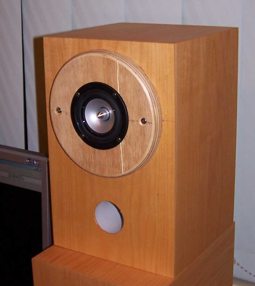

My Cyburgs
Recently got my cyburgs-needles up an running...all they need now is sanding and finishing. Built as near to specs as I could do using only a jigsaw and a dremel. My tool collection could use some work....some pictures:
http://static.flickr.com/50/144911660_b45f3dfeb7.jpg
http://static.flickr.com/45/144911661_ba6434c362.jpg (a lot of electronics mess in this pic...the sub is my girlfriend's for HT, no need to use it with the needles at all from what I can tell. The 2-ways are JBL S26's that I got in college and are my trusty party speakers)
VERY pleased with the results. Driving them with an SI T-amp for now. Can't wait to tweak a little more by adding the notch filter, getting them in the perfect spot in the room, maybe damping the driver basket. In comparison to my JBL S26's, the bass is more under control and a lot rounder, if that makes sense. They also sound a lot warmer than I expected. They're still breaking in. Thanks to everyone who has posted on this thread for the inspiration. I'm a giddy DIYer....

And the finished product. Finished with four coats of Tung Oil. Continually amazed at the low end of these things.

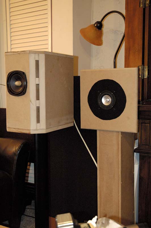

Now you should try them with a baffle, I have had fantastic results with this. This is a 13 inch baffle. If you do this, I would recommend a baffle of at least 2 1/4 inches thick with a 45 degree bevel for the first1.5 inches of it. It should also not be square really. Stop sign shape is good and round like a ball would be better. I also felted the front of the baffle and this cut back the shouty nature that the baffle can introduce. I am not by any means an expert with this but I have had great results with this project. The Needles are the ones on the right (obviously!).
