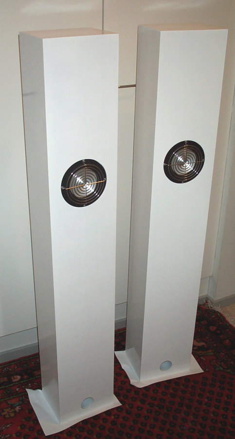

Hi gloss white is great. Here's my JX92'srevell said:I just finished painting my needles, so it's picture time.
Hi gloss white paint makes them look like expensive design speakers😀
Can you just use john krutke's (zaph) TB w3-871 correction network for these needles or is there more to it?

Your Needles look realy professional, I hope they are sounding a lot better as well.
Dear Matjans,
There are some details of the circuit for the Tangband/Needle combination at the beginning of this thread. See Berndts first few posts. Though you could use the FRS8 🙂

@revell:
Very nice design, I like white as colour for speakers very much.
