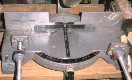

Also, do you have clamps that hold the work against the fence, not the base? As shown, the blade is applying what amounts to twisting forces on the clamp.
I try to avoid any setup that might conceivably allow the work to close on the blade. Even if the cut is safe, the squareness and finish may suffer.

The clamps I'm refering to would go in where indicated, and apply the force on the blue spot (directly opposing the pulling of the blade).

I retract my suggestion... and you will never see me make that cut. I'm relying on my experience with all kinds of material, in all thicknesses.
If you want to see why... place a thin piece of angle in that setup, and cut it too quickly. Heck, just clamp it in, and try to pull it out... B will work fine if clamped against the fence, but against the base, there is no solid indexing. Fit and finish will suffer, and the chances of shifting are multiplied.
Worrying most about the cross section is only important if the machine has too little power, has a dull blade, or is being fed too quickly.
Try them all w/o power, and attempt to shift them with your hands, in the direction the cut will apply it's force. Go with what that teaches you. Do NOT listen to me...

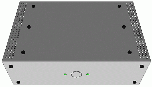

Ok, I updated my model. I've added round ventilation holes instead of slots. Man, is this GF2 Pro slow! I can't even decently orbit around the model, it's just start shocking, horrible...
Anyway, I've got another problem now. I don't know what style I like most 😛. On the left side you see from inside to outside: 6mm - 5mm - 4mm hole, on the right side: 5mm - 6mm - 7mm. I don't think that the smaller holes on the left will be a problem, there's more than enough of them to allow vertical air movement.
Oh btw, ekd (or whoever it was who proposed the following, can't remember who it was), I tried it with holes above the cooling fins too, but I really didn't like that. I find that the sudden appearance of the cooling fin in the hole disturbs the "unity", the "slickness" of the chassis. Well, I don't know how to say it, but maybe you understand what I'm trying to say 🙂.
So, tell me, what style do you guys like most 🙂?
This is how I set 'em up.
Clamped (at both ends) directly opposing the forces to be applied. With the overhead clamp, and the B config, you are relying on the traction between the base and the piece to oppose the cut. With this alternative, you will have to tear the fence off (or strip out the threads on the clamp) to allow even the slightest shift. Neither is very likely...
A good, slow, and steady feed will not reveal any problems with any of these setups. But one distraction, or anything that causes even a momentary overfeed, and this will become all too clear.

The best way to make the cut first proposed would be to use the B config (for the reasons T stated), horizonally clamp it only as firmly as the material will take w/o flexing, and then vertically clamping it as firmly as possible. The fit and finish will be superb. Safety wll be at max. Satisfaction as well...

"There won't be problems with those hole sizes with vertical air movement, right?"
Nah. Just opening the trap covered it.
I like the right, too. The proportionally sized holes look better than one size. Either way.
Your drawing skills sure make this forum stuff easy, huh?

I usually do B and never use a clamp.
But again, I'm cutting a lot😉
Mitre cuts are usually not accurate, and I'm doing final trim on table saw with 90deg mdf corner for proper alignment. Also in B position, as my blade doesn't raise that hight for 2" angle. Without any clamp, I imagine it's the safest position.
Chris, I'm betting that the existence of the mounts for the side clamps is an indication that they may be available. Heck, the ones from my Makita look like they'd work on yours.

I also get a bit peaved at the guys who write manuals. Simplistic is one thing...dangerously vague is another. .250 thick angle will clamp strongly and cut beautifully in B comfig, .062 could be jerked, by hand, right outa that setup. Try it.
And if anyone thinks that because it's thin it doesn't need to be securely clamped?... imagine if the power is interupted for a second during a deep cut. Let's say just long enough to grab the part... and then comes back on.

Measure the hole highlighted in the pic. If it is .700" ID or bigger, the Makita clamps will work. They have a really neat quick-release feature that makes fast one-handed clamping a breeze.
And until you can clamp in both planes, don't do large tubes without a V-block.

Well, I though some more about it and I think the left ones will be a lot nicer in real life because the heatsink fins become smaller the more they get to the outer edge. I also find that the left style makes the chassis look thinner, more elegant, while the right one makes it look somewhat bulkier.
There aren't too much skills involved, well, except for the skills I needed not to become frustred by the slow 3D card 😉. But I agree that it's a lot easier to make things clear.
