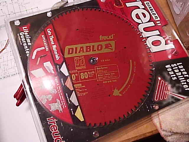

Freud makes a special " Non Ferrous Metal Blade" that can be got for that price and this blade is designed only for non ferrous metals. That's what I've been using all the time. I bought mine from Busy Bee Machine, but I believe it can be also obtained from HD or Rona on a special order, if not available off the shelf.
I have no experience with that red Diablo blade, although it may be very good.
Devil!

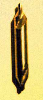

Drilling holes. There is no way to get a hole in position without giving it some method of starting in that position. Without a little help, the drill moves .5mm to the side and then starts downward. BAD!
There are three ways of getting the drill not to "walk" (move laterally before "digging in").
1. Punch the hole location with a sharp object leaving a small crater that the drill will not walk out of.
2. Use a "center drill". This is a drill with a very shallow included angle on the tip that prevents it from moveing laterally. It is only meant to drill 2-3 mm deep. It is used to start a standard twist drill.
3. Use a drill with some sort of "special" point geometry... a split point drill. This is a drill where the chisel point is ground to eliminate the typical flat spot on a the drill tip.
In most cases, all that is needed is a healthy whack of a hammer on a sharpened punch to produce a spot where the drill will start and not go sideways. This is even necessary when drilling on a rigid press or mill if you are using a conventional drill point. The drill will certainly move outside the boundries that we have established for a "close fit" and perhaps even a "free fit".
<snip>
I'm sure the Freud non-ferrous is better, especially for the money. That said, I have the red Freud 60T and it cuts aluminum like butter.

Irrespective of any one case, the thing to remember about drill length is that they -all- flex and they all walk. The center drill that C refered to (shown) is shaped to eliminate as much as possible, and it's only job is to start the hole.
Let's put it this way... A hole that is made with a 8" drill, and prepared the way C says, will be twice as fine as one done with a 1" bit on an unprepped surface. Every time.

The blades made for non ferrous metals are tripple chip with a neg rake. This means the teeth alternate between square tooth and square tooth with the corners ground off. The negative rake means that the facet of the tooth more or less parallel with the radius is leaned back to not dig in.
The typical "alternate bevel tooth" blades that have one tooth angled to the left and one angled to the right tend to flex the blade back an forth as they cut and bake the blade wobble and make a rough cut. The ones with positive rake tend to try to dig in and self feed.
80 tooth for a 10" is pretty good.
One bit of advice on cutting extrusions. (I have professional experience here) Cut so the blade first contacts the loose end of the extrusion. Also cut so that the loose end will disengage the blade when it flexes. And if your saw has a brake, bee sure you are all of the way through your cut before you release the switch.
Good luck and keep your fingers.
Upon closer inspection of your pic, I think that you have a decent blade. Freud makes some nice ones. I can see that it's recomended for Alu, brass, and copper. tripple chip and looks neg rake. Cut away
