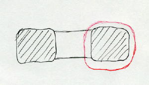

Just to make it clear for everybody. This is a cross section of toroid. You can't create a loop, either with chassis parts or any conductive potting compound, that goes through the center and is closed around the core (like shown with red line).
http://www.diyaudio.com/forums/attachment.php?s=&postid=400857
Otherwise, you can wrap it with aluminum foil and nothing should happen.

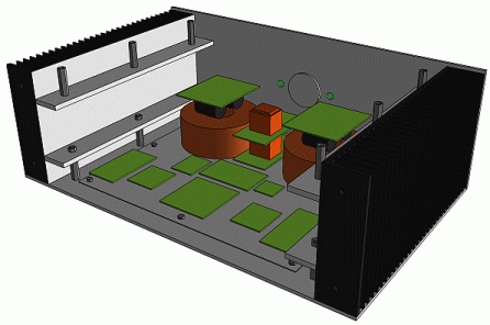

Those bolts should be OK to hold the bottom plate and whole chassis together. What I wouldn't adviise is covering the fins with bottom and top panels, as this reduces the heat dissipation efficience. Unless of cource, you are building chip amp and then it doesn't matter😉
I hope to get the panels CNC cut, so having ventilation slots in the panels shouldn't be a problem. Thanks!

May be M6 is strong enough I do not know. But I just see that the way your planning really rely on the bolts strength to take care of all forces not just vertical pulling off the threads. Now your heatsinks can be acting like a lever to bend all the bolts if enough side/horizontal/angled forces rather then just vertical downward force. To bend a screw or bolt with the help of a lever is very easy. I am no enigneer just day to day common sense of diy taught me this particular thinking when bolt metal together at right angles.
IMHO
Chris
But wouldn't the side/horizontal forces be eliminated by the front/back panels that are attached to the heatsink with bolts too? How exactly would you attach the top/bottom plates then? I don't really get it. You suggest to use a metal tube spacer, what exactly is that?
Just for clarity, here's a newer & clearer image of how it might look once finished. If you look really good you can see 2 holes in the right heatsink, that's of course where the back panel will be attached. Yes, there's lots of PCBs in there, but that shouldn't be a problem, I still have a lot of space to stack them if it should be necesarry.

What is the purpose of the "bars" on the sides of the heat sinks. Are they part of the heat sink?
I believe you would achieve a more rigid structure by using aluminum angle for the heat sink and the bottom/cover. I think the standoffs on the bar lack any lateral stiffness.
"But wouldn't the side/horizontal forces be eliminated by the front/back panels that are attached to the heatsink with bolts too? "
Only if those bolts have zero slop (not easy to do). If the standoffs are as large as possible (OD), they will translate the bending forces into pulling (tensile) forces. Maybe enough...

He might use bigger dia for the standoffs and that will increase stiffness. But as long as he's using front and rear panels attached with screws to heatsinks, this provides enough vertical and horizontal stability. Bottom and top plates prevent "warping" (as long as standoffs are at least 1/2' in dia..
It seems like the heatsing bars are part of the extrusion.

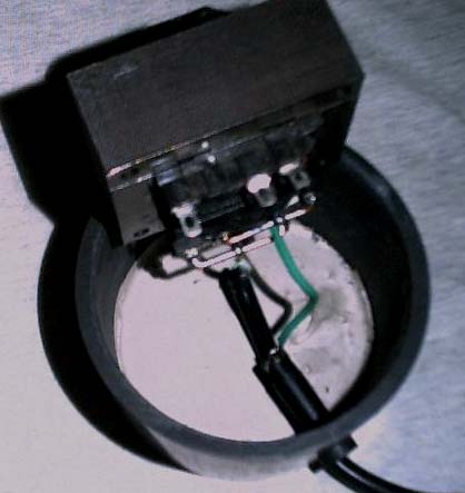

Pipe is cut, the interior is roughed up with 50 grit (better adhesion to Bondo), and holes are punched. A thin floor is poured (should'a done this to the first one, trans settled to bottom during pour). 14 guage solid copper wire bridges input coils, fuse holder is installed, and everything is solidly attached and then soldered.
More soon... 😀

...I believe you would achieve a more rigid structure by using aluminum angle for the heat sink and the bottom/cover. I think the standoffs on the bar lack any lateral stiffness.
Hm, yes, I thought about L-angles too. However, how would I fasten things then? It looks to me that there will be no way to fasten the last bolt & nut, since I won't be able to hold the nut under the panel in place once the case is closed. I'm probably wrong (again 😉).

What do you mean by zero sloping? The OD can be quite large, but I guess it's limited by the ID right? Unless I make them myself of course...
The drawings are made with SketchUp. The only problem with it is that I can't model engraved text, so I guess I'll have to remodel everything in AutoCAD or something eventually if I want to have it CNC'ed 🙁.

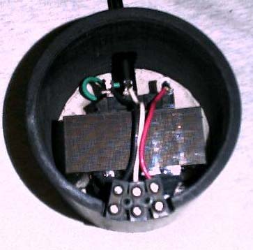

I used a flexible term strip for the outputs, triple checked everything, and poured.
Got a few minutes before the Bondo is ready for rough shaping... Just enough time for a can of something...
