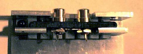

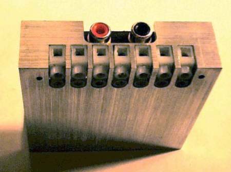

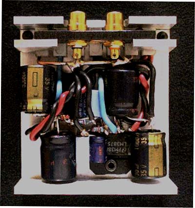

Guys, your ideas helped a bunch. It's darn close, but it all fits. I freehanded this together to try it (kinda sloppy), and the pics say it all...

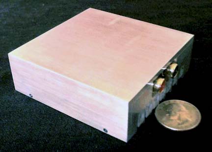

3" x 3" x 1" 6063. Clamshell. It's cut to form a light press fit, so it will spread the heat. Solid billet would just make a bigger mess, there really isn't room for thicker walls ( the top literally clamps stuff down when attached).
It will make a pretty sweet monoblock case, but fitting 2 channels in takes pretty tight machining (the RCAs -just- fit). Would be perfect for active speakers, it'll fit anywhere.
Psu next, then heat it up, and hunt down the ultimate vent pattern.
Gonna need more help soon... 🙂

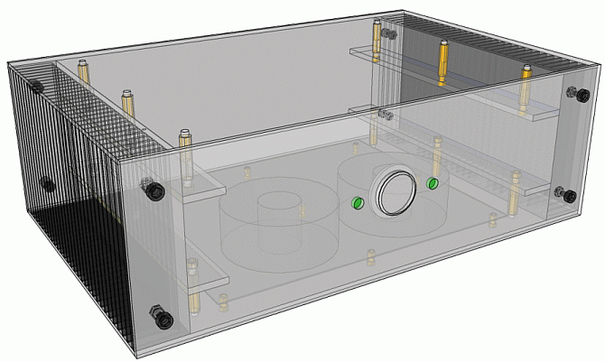

A friend of mine gave me some new idea's on how to attach the front, back, top & bottom panels to the heatsinks of my soon-to-be JLH (I hope 🙂).
Would this be a good way? (check the attached image)
The top & bottom plate would be attached to the heatsink with screws that go into stand-offs. The gold coloured things in the image are the stand-offs, the screws aren't there yet. I'm thinking M6 for the screws, will that be enough? I guess that the amp will weight a maximum of 15 kgs when it's finished.
Also in the picture, you can see a small plate, mounted with short stand-offs on the bottom plate. It would be attached the same way as the top & bottom plate. 3 screws on each side. I'd like to mount all PCBs on this, so that I don't have to drill all the holes in the bottom plate. The only think I don't know, is what thickness this "mounting" plate should be? I need to mount 2 torroids on it, I guess they weight +- 3kg together. Would a 1mm aluminium be OK, or should I go for something else?
I guess mounting the front & back panel with 4 M6 screws into the sides of the heatsinks is fine?

IMO the way to mount the bottom plate you are planning may not work well. Imaging all the weight resting on the bottom plate plus heatsinks themselves, and you lift it up with just six small screws with small diameter and limited threads. Why not use 4 bigger bolts with metal tube spacers go all the way from the bottom of the bottom plate to the surface of the lower extrusion of the heat sinks.

IMO 2 mm would be ~adequate. 3mm would be perfect.
Ok, thanks! Anyway, I had another idea. What if I used 1mm thick alu. It wouldn't be a problem for the PCBs, since they weight virtually nothing. The transfos would be mounted onto this thin plate, but a bolt with a thick nut would go through the plate and thus the transfos would actually rest on the bottom plate. The thin plate would just hold them in place. Could that work? It's just that I don't want to spend another €35 if it can be done cheap.

Hm, well, what do you consider big bolts? If M6 isn't enough I can use M7, M8, whatever... And basicaly, they go from the bottom of the lower plate to the top of the bottom extrusion. It would be like this: nut - bolt (trough bottom plate) - bottom plate - stand-off (M6 or more inner diameter) - heatsink extrusion - nut (screwed onto the end of the stand-off, which would be M6 too). The stand-offs, or spacers, I imagine would be pretty thick, considering it need to be wide enough to allow an M6 bolt to be screwed into. Or am I totally wrong here?
Hello,
May be M6 is strong enough I do not know. But I just see that the way your planning really rely on the bolts strength to take care of all forces not just vertical pulling off the threads. Now your heatsinks can be acting like a lever to bend all the bolts if enough side/horizontal/angled forces rather then just vertical downward force. To bend a screw or bolt with the help of a lever is very easy. I am no enigneer just day to day common sense of diy taught me this particular thinking when bolt metal together at right angles.
