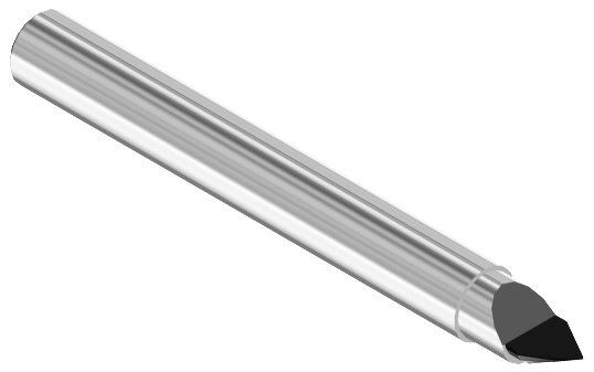

As I will probably have my front, side & back panels for JLH amp CNC'ed at a school I was wondering wether it is possible to fill etched things yourself.
By this I mean: if I were to get the CNC machine etch stuff like "AC Input", "Left Input", etc. into the alluminium, could I then fill this with regular paint & then clear coat it? Would this give a professional result or not? I'd use car spray paint for it.
Oh, some more things. What's the smalls detail a general CNC machine can cut? 1mm wide, 0.5mm, ...? And is there any free, decend CAD program in which I could draw my designs for the CNC machine?
You indicated "etch" but if it's removed my machining it's called engraving. They are available in sizes from very small to large, but basicaly the depth of the toll controls the width of the engraved line.

Making the "letters"... You could do it in Autocad, save as a DXF and then feed it a program like Cadkey, Gibbs, Bobcad (affordable) or Surfcam (there are dozens) for "post processing". That's turning the data into "G-code", i.e., instructions that move table in X, Y, and Z axis.... an example.
