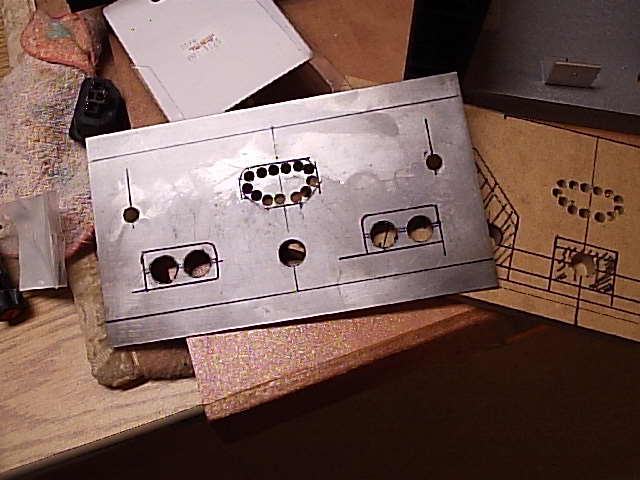

1/2 inch drill bit
After 2 hours of drilling it is time to do filing. The longest and hardest to drill are the 1/2" holes on this 16 guage steel panel. I got scared and did not want to force it that' why it took so long. When I saw the 1/2" drill bit started to bend I eased off and put a drop of engine oil in the hole and continue drilling slowly and also my left hand was holding the shop vac host to vacumn it and I think the sucking of air help cooling the bit too. Oh yes I have set the drill press to the slowest setting.
Now filing will have to be another day I am feeling tire from standing and the noise from the shop vac.:xeye:
