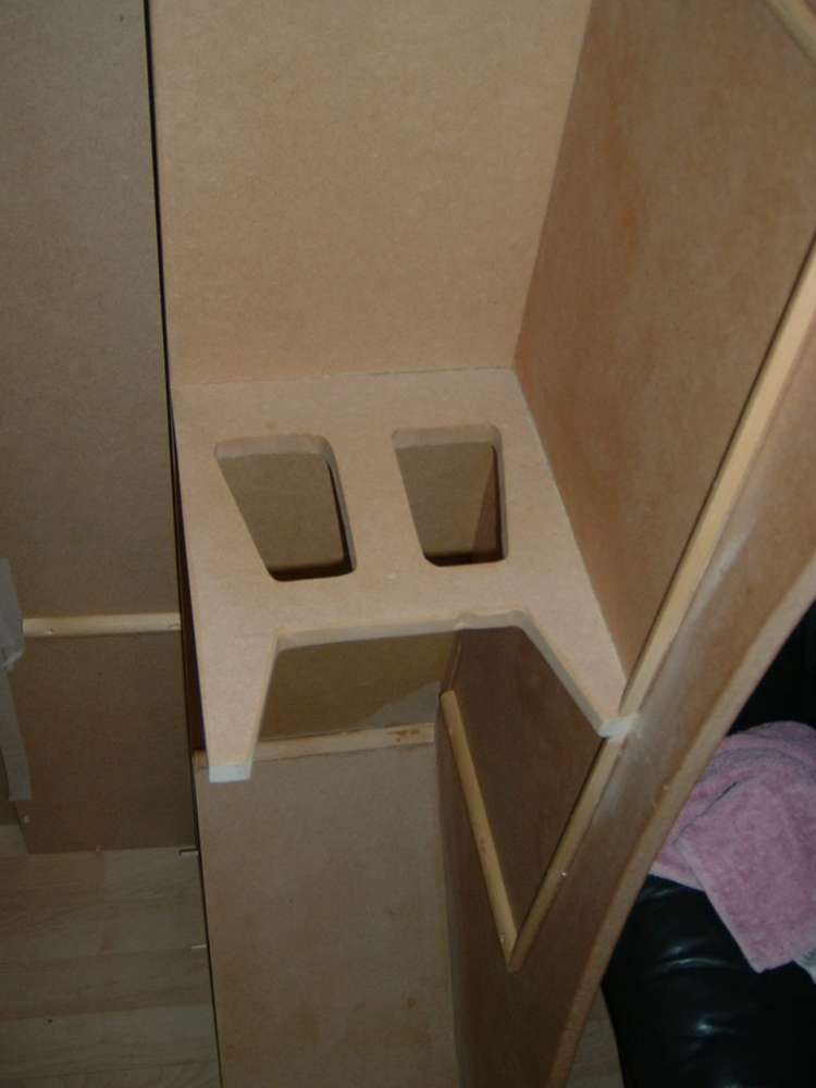

After suggestions from Dave and info on other posts below is my magnet brace, designed to spread the forces away from the baffle to the rear and side walls. As I was making 2 I first made a jig out of 6mm MDF and routed the actual braces (hence the little nick where I wasn't watching my router 100%.

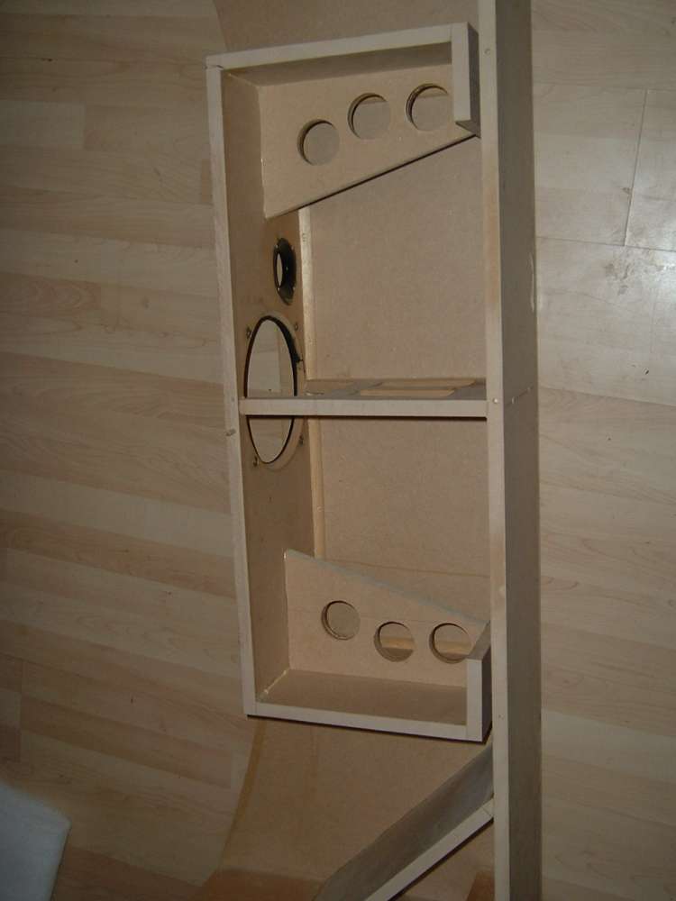

Next I glued in the compression chamber assembly to the main unit. the holey baffles were put in a while ago to stop things flapping around, before I did a lot of reading, and would change them, but when the sides are on its solid.

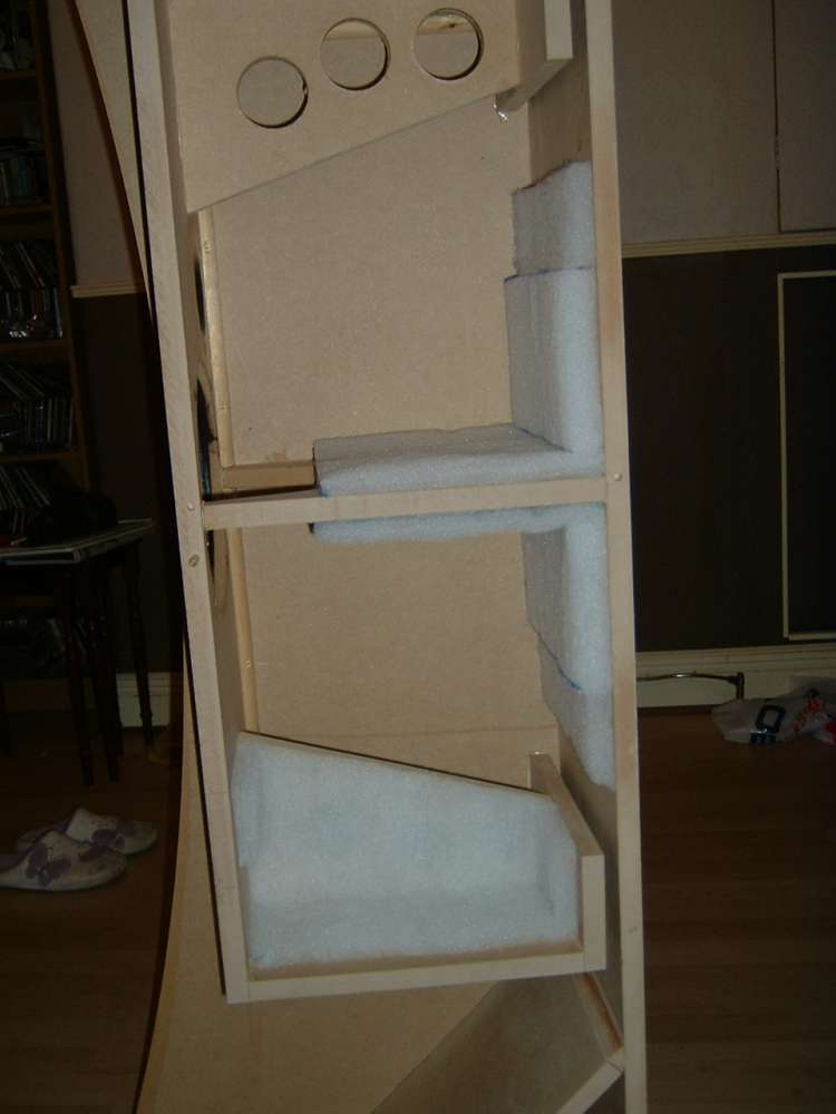

Here I've started adding the fluff (wadding), its not actually BAF, but the standard polyester wadding from my local habberdashery store. I've got a couple of different thickneses, just to experiment with. The idea is to have only half the total internal surface covered, with each pair of opposing sides consisting of an uncovered and covered face. directly behind the driver and area's I suspect will be more prone to reflections I've used 8oz, other area's I've used 4oz.
Your attention to detail that will never be seen but most likely audiable is remarkable. Your set is likely to set a reference standard for others to follow.

Dave gave me the pointers for how to brace a speaker, I just think the triangular section looks better than holes, and has some mechanical benefit in guiding (steering) forces.
The idea for the stuffing is a further development of your advice Scott on only covering one side, top etc. I was stood in Boyes ( a shop that sells everything)
looking at the selection of wadding, when I got the idea of going further and trying different grades. Having origionaly over stuffed my 166 BLH's
I learnt the hard way that to much stiffles the sound, and less (or just right) is best.

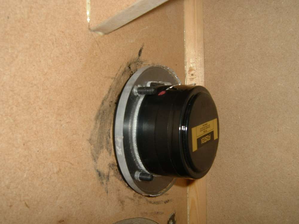

On the subject of bracing, I must admI'm going to be wiring up over the next couple of nights (or I'll forget and glue it all up, have a look where the wires come out of the FE166's!!)
and would appreciate some advice, ie do I run seperate pos and neg leads or do I keep then twisted.

I'd be inclined to have them twisted internally, although that's more in case you're running an unshielded driver. I doubt you'd hear a difference to be honest.

No the braces are offset by the width of the material, the dowel hole in the rear panel in post #167 is dead centre. I didn't want to do more on the magnet brace, I was worried (probably unessesary) about the offset forces on the magnet and speaker cradle.
As I said earlier having now seen some BB-ply I want to re-build these in that material, but this time with a bit more thought and engineering. I would also run a vertical, or two vertical braces, offset either side of the centre all the way to the magnet brace, again using trainular shapes to give maximun bracing, maximum holes, minimum material.

right I'm off to do some wiring up, i think for reduced capacitance seperate runs would be best, I just dont fancy untwisting the cable.

just had another look at the picture, going to check when I get home but I think I've only offset by half the material thickness🙁

I dont think I got the offset quite right, what I did was measure my centre line and use that to line up one edge of the braces, so I think I've only offset half of the material thickness, which now worries me a bit as I have a panel supported by an edge down its center line !
