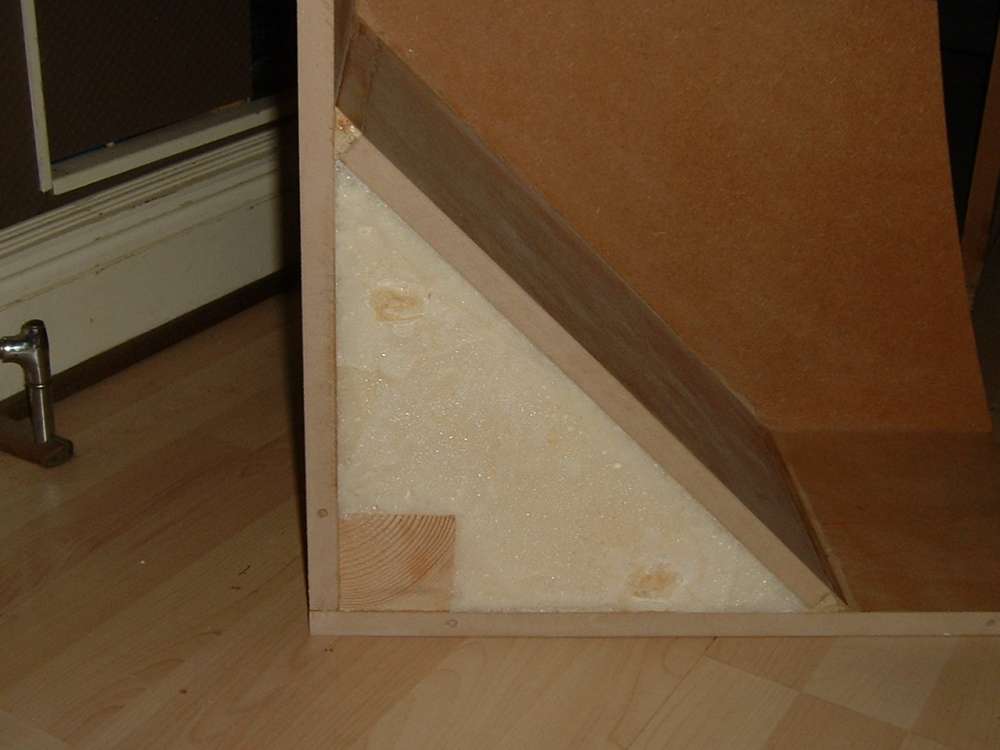

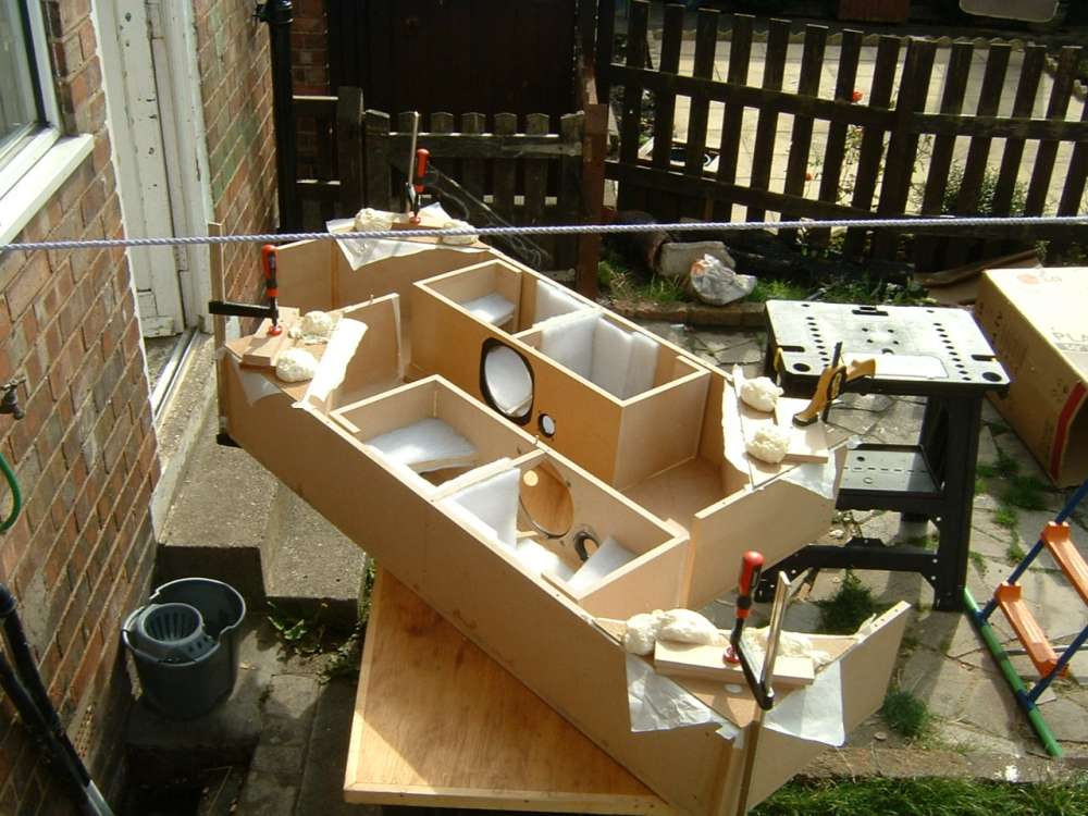

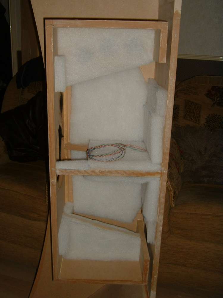

Right back to the build.
Fistly filling the voids behind the deflectors with foam. The voids are covered with some hardboard tempory covers to contrain
the foam so it fills all the gaps and increases its final density a bit, also act as a pressure release valve. I'd rather do it
this way when I can control the volume and pressue instead of when the sides are glues on, as this stuff can be vicious.
The final lining scheme, after a few variations, this seemed to give the best effects. The holey braces are lined both sides with the light wieght wadding, a method described by Dave (Planet10) on another thread (sorry cant remember where) where as the wadding with the holes absorb higher frequencys. (not the best description)

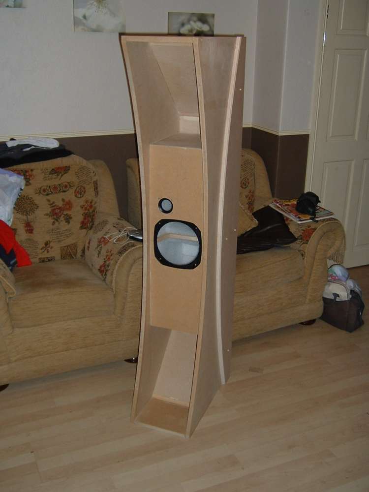

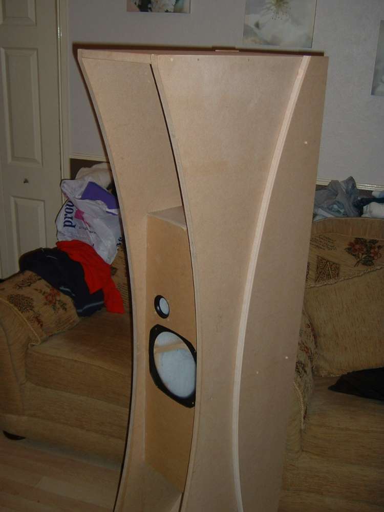

It wasn't till I took these photo's that I got a real
appreciation of how large these baby's are. I've always been
close up working on them and have never realy sat back and
looked at them as a whole unit, then when taking these shots
my beloved walked past the speaker, and seeing how the speaker loomed over her, put into focus the size. (That and the collective hernia's I,m developing carrying them in and out of the house).

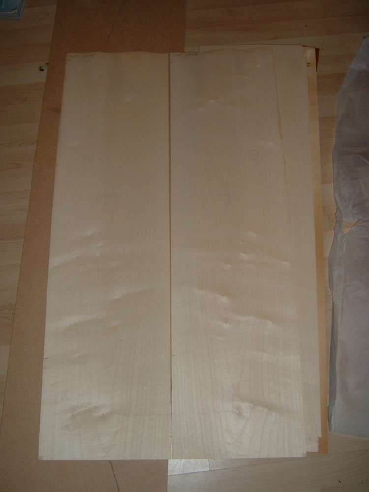

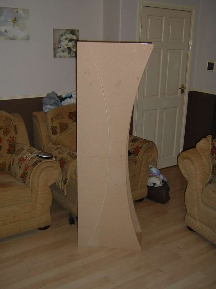

So now the fun part, finishing. I am tempted to veneer the hour glass shapes on the sides, double bookmatched, ie mirrored both horizontally and vertically around the centre lines, the more I look at it the more I want to do it, its just cost of veneer.
Forgot to mention, I've wired it up using 4 twisted pairs of CAT5 cable, after much deliberation, this gives me the most scope for trying different schemes and different wiring combinations, when (if) i reach a final scheme I can get rid of any excess runs.
Wowie zowie! The Curvey Chang is a very cool design. Where else can you find a speaker of that size, design and performance for less than $5k or more commercially. Great job!

I actually see very little reason to square the upper and lower rear deflector panels.
Its bacially a BR port firing into an expansion. If you needed extra support then vertical stringers would work.
As far as looks ( i am NOT qualified in this subject), i think just following the 45 degree angle on the cab sides and building a floor standoff with a supporting platform would look better and be an easier build.
At least thats the way i would do it.
