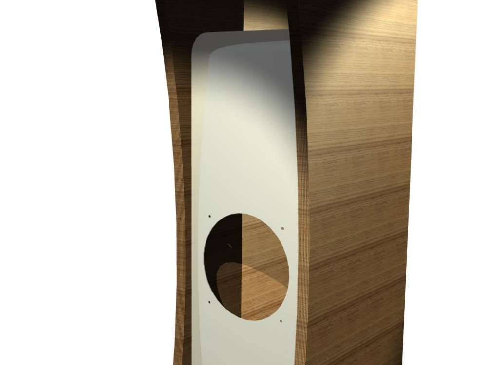

Marce, I had a look at your sketch of the steel baffle. Was that dimensioned so the outside is the right size or so the inside is the correct volume?
What do you think of using 1.6mm brushed stainless, stick 18mm panels of plywood on the flat sheet with silicone with gaps in the areas to be bent. After the silicone has cured clamp either side of the gap and bend it by hand, the plywood backing can be used to stick to the side panels of the cabinet.
Stainless is quite springy and should give a nice smooth bend.
Edit: Spoke with my old boss, a sheetmetal guru. He suggests 0.6mm stainless bonded to the ply with contact cement and clamped to death during curing so it doesn't show any lumps or wrinkles.

Quick play at what OzMike is proposing, Think it would be an interseting experiment gives a modern 'industrial' look.
Attached a render for you Mike, haven't done the top and back as to get the correct look the laminations on the ply are built up one by one.
Must draw some FE drivers, once I've approximated one the others should scale up and down.

marce said:Quick play at what OzMike is proposing, Think it would be an interseting experiment gives a modern 'industrial' look.
wow!, very interesting.
since I want to save my back, how about "metal film" just glued on??

Pretty cheap if you use the stainless sheet as a cladding over ply.
The stainless is only structural on the curved corners which could be foam filled anyway. I have been told 0.6mm sheet of stainless is only about a hundred bucks.
