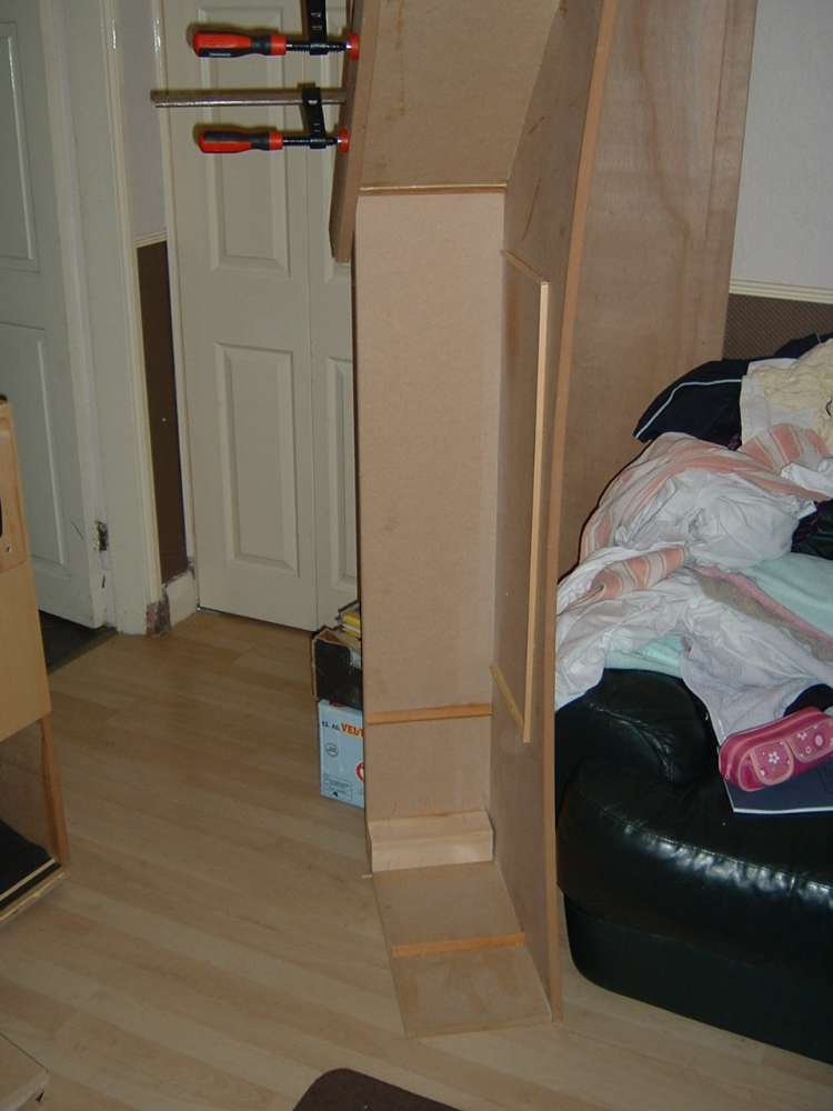

Gluing the first deflector, once a side was glued I was surprised how stable the semi-clad CC was.

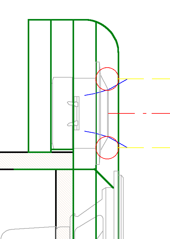

Just re-read your answer Dave, sorry what I meant was how should I finish of the flare for the tweeter.
Chris and i were just considering the detail as we work towrads fitting 207/FT17 into Demetri.
Drivers will be mounted on an eliptical supraBaffle which we will make out of MDF due to ease of shaping. We;ll start with a quarter round using the router (red curve) and then just sand until we eyeball that the curve matches the curve inside the horn. (Blue curve). At the mouth we will increase the flare.
dave

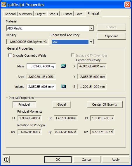

I am hoping to install Autocad 2008 and Inventor 2008 later this month, ther is susposedly a major improvemnt in the interface between the two packages on the DWG front. The trouble with inventor is it is a full 3d package and I havn't found a way to get solids into Autocad, I will do some more research and have a chat with Acad support). Saying that it would be relatively easy for me to import your basic speaker drawings and createa 3D model. These could then have basic rendering done. You could then use these in DWF format and create any view you want. The other interesting thing is that once in inventor the mechanical properties of the material used can be specified, this would allow various data to be extrapollated including initial estimates of speaker weigt as well as more mind bogling stuff as shown below.
I only scratch the surface of what Inventor can do, but since I've changed from 2D (Acad) to full 3D (Inventor) doing 3D moddeling is much easier anhd quicker.

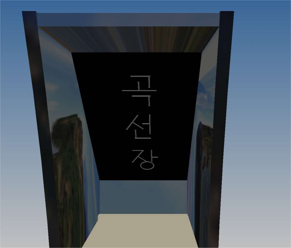

This is my initial render of what I planned out over the weekend for the text GY provided me with.
You have the writing like a true native Korean, much better than my handwriting for sure. If agreeable u may want to thicken the lettering but looks great!
I am eagerly waiting for your build.

GY, I have drawn the text in Acad so I can print it out on sticky paper and create exact stencils with a craft knife, I will increase the width of the letters. If I have enough veneer I will try the letters in a contrasting veneer.
