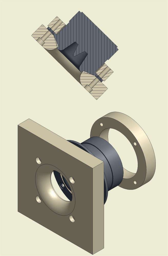

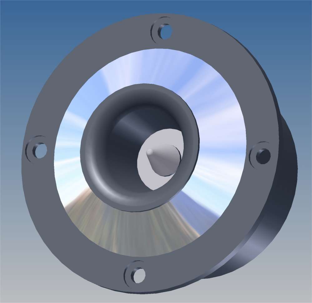

The atached picture shows my method for rear mounting the tweeter.
IMO the ring used to fix the tweeeter is necessary to spread the torque
of the bolts to enshure a decent seal. The flange of the FT17 is plasti
and would possibly distort if used on its own. I use closed cell
neoprene gasket 2-4mm (grade 240 soft) to make gaskets. I find this is hard
enough to make a decent seal without putting undue stress on the drive
unit.
Note for Dave.
I drawn this up in Autodesk Inventor, I'm going to measure up a FT17
with my micrometer to get my model more exact, I will then be able
to convert some of the info to DWG format so you can use it.
I'll look into DWF viewers when I get chance, then you dcan use a
3d dwf file to create any view you want.

Marce: if your build is half as good as that rendering I'll be well impressed! The horn boffins should have a look at that step in the horn expansion, it might cause some strange things.
Knowing the real shape of the FT17H horn (spherical, tractix, whatever) would be helpful for calculating the final diamater of the flare when 18mm is added to the front.
