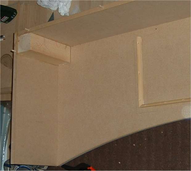

marce said:I was cogitating the build last night, and have decided on some structural engineering, involving cement sheets etc. Two main reasons, firstly obviousley to reduce resonances
but also, after the work you've all put in designing it, and the work Dave does in customising the drive units,
I'd be a bit apprehensive about cement board -- if properly braced (i may have to add that as mandatory in the drawing, instead of just the comment in the notes), cement board will take you in the wrong direction. An educated guess is that you'll end up with something dead sounding. Have you glued them up yet?

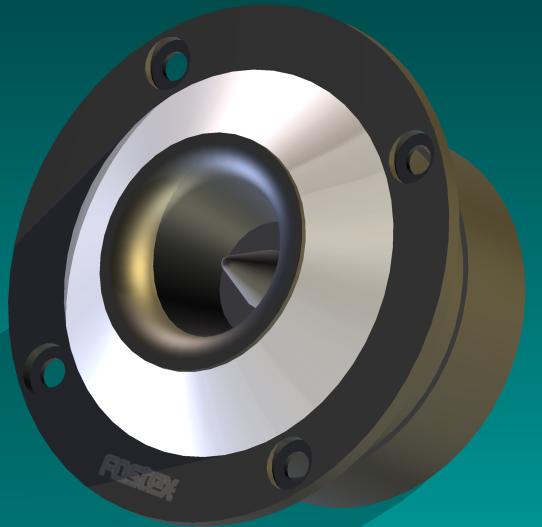

marce said:And here's a pretty rendering of an FT17.
Does inventor not do bezier curves (ie curves are approximated with polygons?)

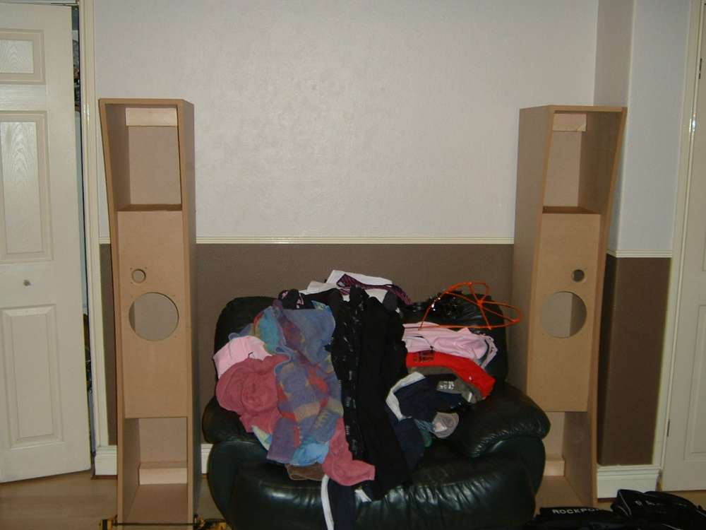

Hi All,
started final assembly the boxes, got one rear and one side in each cabinet glued up, so it finaly feels like I,m getting somewhere, though didn't get as much done as I hoped, some bits had to be re-cut. Final glueing up is so final I spent a good half day convincing myself I was ready to start.
Will get some more photo's sorted soon.
After talking to Dave I'm going to do some study on threads on bracing.

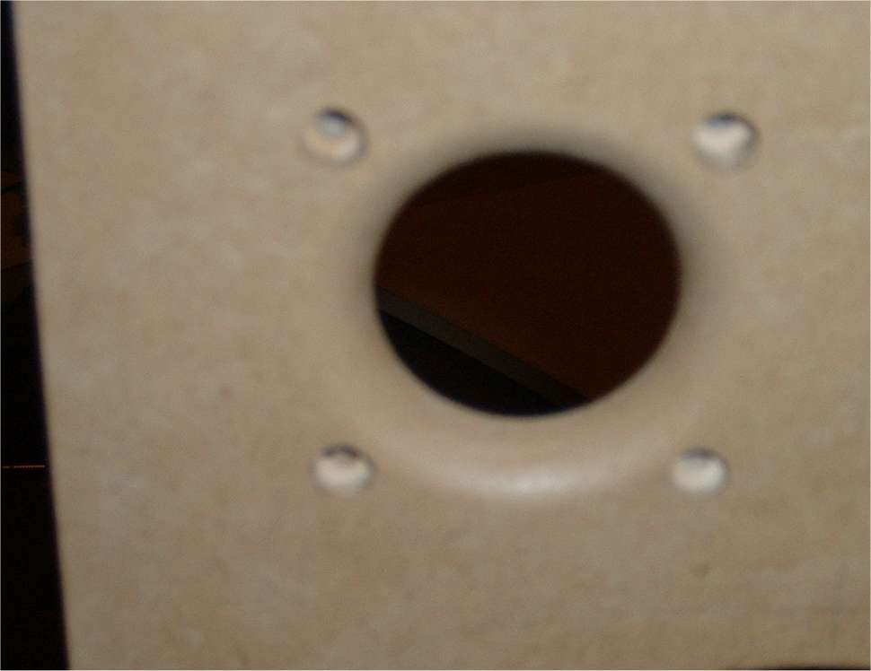

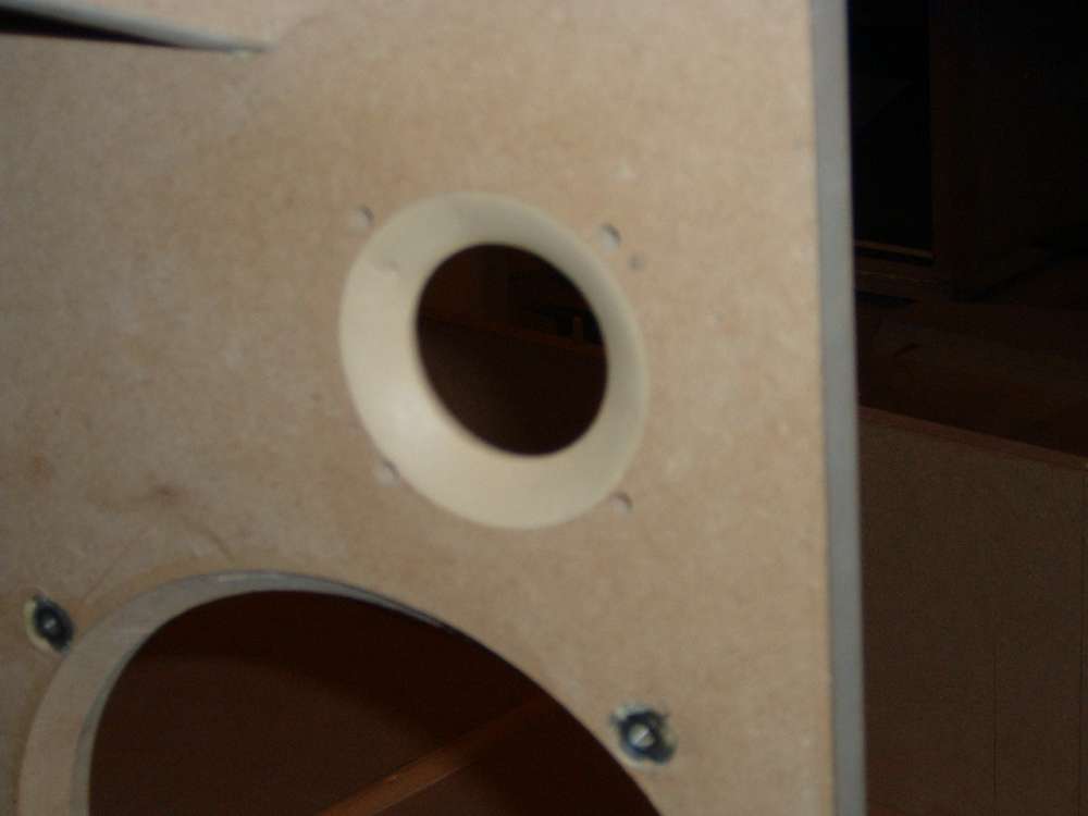

I worry about the flare of the Horn. At the moment it has just been rounded over with a roundover bit.
So again any info would be gratefully recieved. Also how the horn mouth should be lined, if it should.
Hi Dave, inventor does beziers. If you have a dwg of the horn mouth I could use that directly and revolve it

marce said:Cross with myself because as I said earlier had to re-do some pieces, and only because I rushed some parts
thinking I would save time and of course I hav'nt.
I know what that's like I have to cut some more to correct my mistakes on the Suzy Chang cabinet... should measure twice and cut once.
we are looking forward to your build. Pictures will be appreciated.

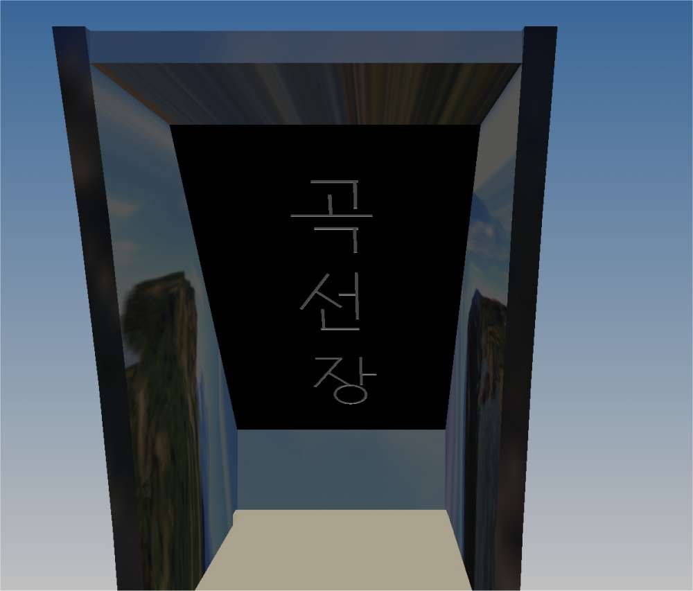

Just working on drawing up the Hangul text you so kindley provided GY. I'm thinking of putting it on the angled deflectors, verticaly. When I get it drawn up I'll post a picture.
When I get time I must learn how to do quotes! OxMike mentioned finish earlier, I am under strict orders to finish these cabinets before I put any drive units in! The finishing part is the part of anything I build that I realy enjoy. Its the part where all your effort and time start to come alive, so hopefully I'll give the speakers the finish they deserve.

This is my initial render of what I planned out over the weekend for the text GY provided me with. I am not shure what colour combination I will finaly go for, as the background is gonna be satin black, I will possibly do the text in a metalic pewter paint.
Going to get some of that plastic they use for stencils and actually cut it out by hand.
Plan to do it on all 4 deflectors.
marce said:At the moment it has just been rounded over with a roundover bit.
That round over is as far as you want to go. The abrupt changes are part of the design. No lining in the horn mouths (they are actually BR ports)
I only asked because the FT17 render had some decidely polygonal artifacts in it.

Hi Dave,
the artefacts are mainly due to manipulation of the origional image. Autodesk Inventor has two levels of rendering, the basic working display one (the one all these images are screen dumps of, hence some loss of detail, resolution etc) and a full blown rendering studio!!! I am still learning how to effectively use the full blown renderer.

Just re-read your answer Dave, sorry what I meant was how should I finish of the flare for the tweeter.
