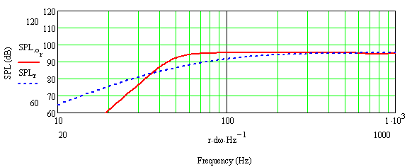

As Greg says, the fancy drivers would need a specifically designed cabinet to get the best out of them. However, as far as I can tell from a quick look, the Lowther PM6C can be used in Chang to fairly decent effect -just remove the internal panels that lengthen the slot-vents, so each is simply 19mm long -the thickness of the build material, & use a high-ish resistance speaker cable. A cabinet designed specifically for them would obviously reap rewards of course.
Given the nature of the cabinet & the limitations of the MathCad worksheets, these graphs should be taken with a pinch of salt, but they do at least give a good basis & the response appears decent, with excursion nicely controlled.

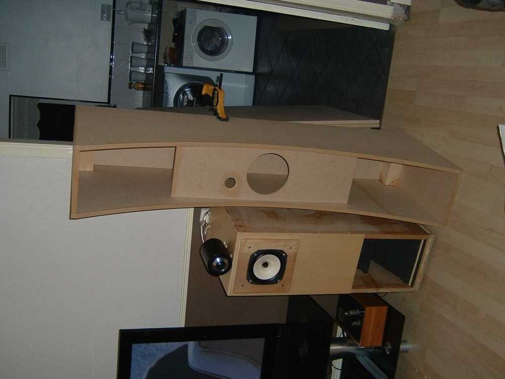

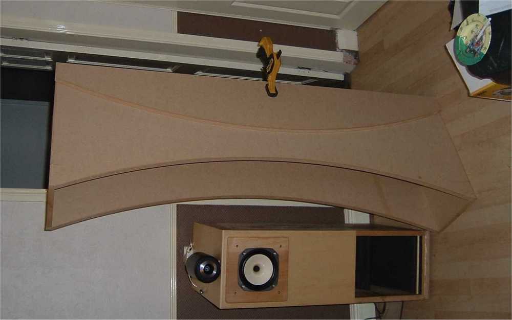

Hi All.
build going OK, some problems with such large panels but fun!
I've used dowels to help align all the panels together, this has allowed me to dry fit everything together so things can be checked. It will also allow for quick alignment of the panels when glueing up. I use polyurethene glue as it expands and fills the gaps (!) nicely, trouble is you only have a minuite to get everything clamped up, so dowels seemed the solution. It has worked well.
Got the tweeter rear mounted as per Dave's earlier suggestion. I am using 4 x M5 bolts through the front and a ply ring with inserts
to sandwich the tweeter in. This will allow easy removel etc through the main driver hole if required.
One last domestic issue, and I'm hoping Planet10 can help (please), as I'm finishing the CC's in black, my other half wants the drivers to be black, could you do a pair of FE207's coloured like the blue ones you did for Scott.
I have done the sides like on the picture posted on GYChangs thread on his build, they add strength and break up the squareness of the cabinet, with an hour glass shape.
I reckon a black pair of 207s would look rather impressive -I can't see the colour being a problem. Remember to get the phase-plugs fitted at the same time. Saves doing it later. 😉
Don't forget bracing in the back chamber -it's a big old box & could do with some to stop the panels singing away. Especially with MDF as a build material.

back in the real world after a enjoyable holiday "playing with wood" and visiting relatives. I've got a few phhoto's there just to big to upload, so I'm going to work out how to shrink them and then I'll post them. Sent some direct to Scott so he can see the real Curvey Chang as opposed to a virtual one.
Having dropped a panel on my (now broken) big toe, I am a bit worried about panel resonance.
Soon as I get chance I'll document the build so far.
Managed to do tweeter like Dave's earlier sketch, it does look neater.

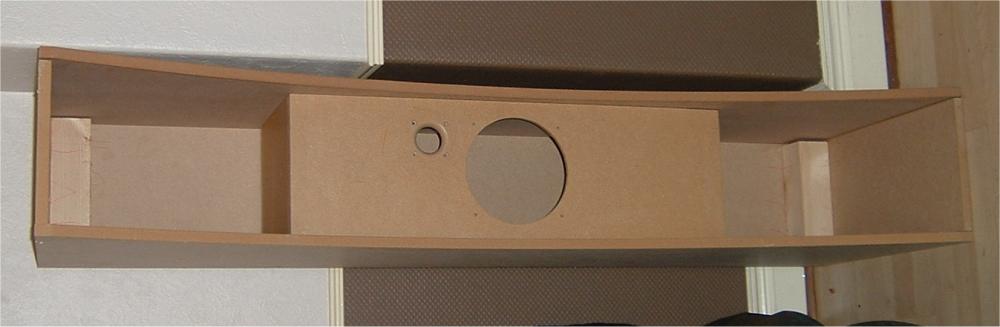

most recent view, almost ready for final glue up, apart from BAF wadding and panel deadening with bitumen sheets.
PS Sorry forgot to rotate image in Paintshop, bit of a Luddite with all this modern technology sometimes.

I'm going with the 45deg panels, they are cut, I havn't got round to dry fitting them yet.
For the tweeter rear I used a coving router bit to get the basic fit, then used some 2 part Wood repair (an epoxy based product) in the hole that was left, covered a tweeter with cling film them pressed it into the gunge to create a tight fit of the right shape, a bit of sanding and its done.
Thinking of using either 2mm bitumen or 6mm butyl rubber to help damp the panels, any advice please, cos I've got a bit neurotic over the size of them after reading other threads.
On the subject of bracing, would radial hardwood braces around the large driver help, I was thinking different sizes so the was no fixed pattern.
