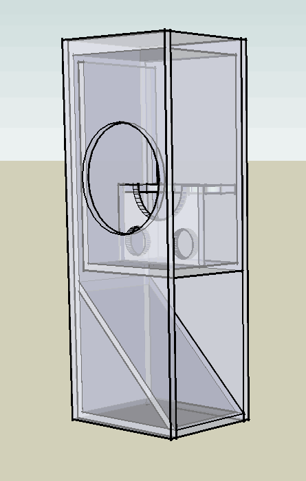

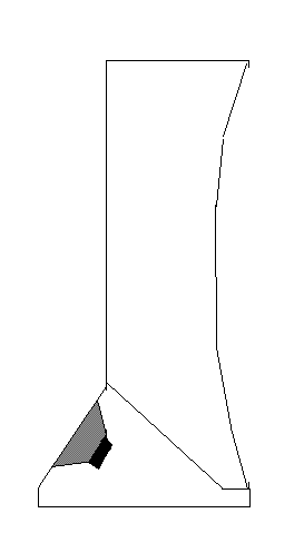

I used to have a Carsboro bass bin, sooo I wondered if it would be possible to combine a curvy chang with a bass bin inside sharing the same mouth flare.
I did some rought sketches and reckon using 8x4 sheets for sides you could get quite a beast. Obviously totaly impractical for normal domestic situations but fun to think about.
Funny you should mention that...
I was wondering how to assist the extreme bottom end with an integrated (sub?) woofer.
Add three inches to the height, then use the void in the bottom for 12 inch driver. the volume would be close to 30 litres, need to design in conjunction with driver selection of course.
about 100Hz Xover.
This might make a real mess of the coherence of the bass. Please let me know if it's a dumb idea.
Greets!
It's not a dumb idea per se, it's been done by a number of boutique horn manufacturers in recent years with the advent of relatively cheap electronics, though as a bi or quad-pole layout to get efficiency up while keeping construction simple/light without enough vibration to excite the horn's modes. The XO point needs to be low/steep though to blend with a proper horn's ~24 dB/octave final roll off as well as keep it out of our acute hearing BW and why it will work better with a typical BVR than the slower rolling off BLHs designed to hopefully mate well enough with the room's gain curve. In the days of passive XOs, the 'sub' was instead typically a BP to keep the XO simple/cheap, though it was huge due to the drivers of the day having a very high Vas by today's standards.
GM
This idea is very similar in concept to the Stealth Woofers for the Frugel-Horn. If you can find a woofer (8 or 10 or 12) that fits into 30 litres and gives reasonable/worthwhile extension do let me know. The Extremis fit into 22 litres (things are looking good for a replacement soon), but i'd really like to find a woofer where i could fit a pair in push-push in a similar volume (i can actually spare 28 litres for the FonkenWoof)

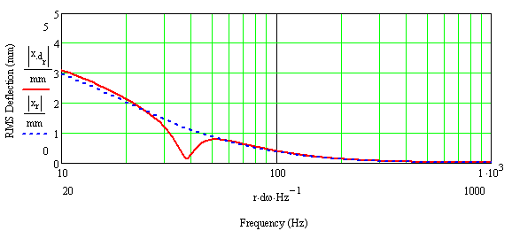

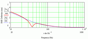

To those who are experienced with the FE207E:
Has anyone measured the frequency response of a phase plugged one around 10-15kHz?
I ask because about to order some parts for some line level XOs.
The Chang's calculated response looks great all the way to 40Hz, This seems too good to be true. What does excursion look like below 100Hz?
I ask this because I may as well get the parts for the low end if I tri-amp with a helper sub later on.
OzMikeH said:
If Chang ever gets a woofer pal like Calhoun it's going to be huge. (I won't need one)
If you like those 16 Hz peddles -- a pr of ShadowSD12 should take the bottom down well below 20. And with authority.
If you want huge then double the width and have a pair of push-push SD12.
http://p10hifi.net/planet10/CSS/CSS-SD12-subduction-data.pdf
Make a nice 3-way system. Active at 50-60 Hz.
dave
