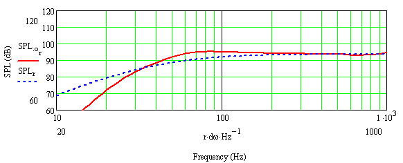

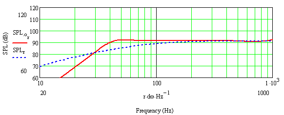

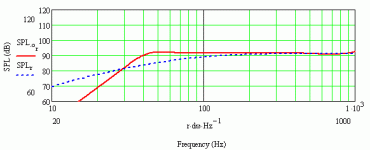

Re: Is Curvy Chang suitable with F200A
Sorry for the late reply, I'm struggling to keep up with things at present as I'm deep within my thesis so not much time for audio.
The F200a? Now you're talking! Fostex themselves suggest a 45 litre box for it, ironically enough (same as for the 206), so we're really in business here. It looks like it goes into the box rather well, with a max-flat 1/2 space response to ~40Hz.
They'll sound completely different to Bob's (excellent) FTA-2000. The latter is a TL, & should have a nicely damped sound. This is a reflex cabinet with huge horn-loaded vents, so it will sound (much) bigger, though with similar delicacy -huge vents have their advantages compared to the small ports used in most reflex enclosures. Both are great, but are really aimed at different people / different uses, so whichever you favour really.
whallen said:I know the Fostex F200A is compatible with the "Bruce" of the spawn family of enclosures, or at least I gather that it is from looking at the Frugel-Horn website. I like the Bruce, but I love the looks of the Curvy Chang.
One last thing, anybody have any idea on what
differences I might expect between the FTA-2000 and
the Spawn familt of speakers.
Well, Ron designed the curved front for the cabinet with the FE207E in mind I believe. In this case, the F200a and the FE207E have an almost identical response, so they should be a straight swap. Which is nice.
The curve should bring positive benefits over the regular flat-front version however, whatever the driver used (assuming it has a vaguely reasonable response); the effect will simply be lessened for other units as they aren't ideal for the enclosure in the first place.

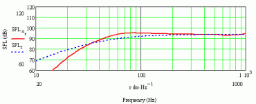

FlorianO said:Nice plot but, that again, Ron optimized this for the FE-207, right ?
The original Chang was developed 1st for the 207 and adapted for the B20. As will most of the BVRs the big vents seem to really help broaden driver tolerence.
Ron added the curved front to optimize the shape of the sonic bubble leaving the box. Keys here were the tall height of the main baffle and the centred position of the driver.
So the Curvy Chang should just get better than the Chang with any driver that works in it.
dave
