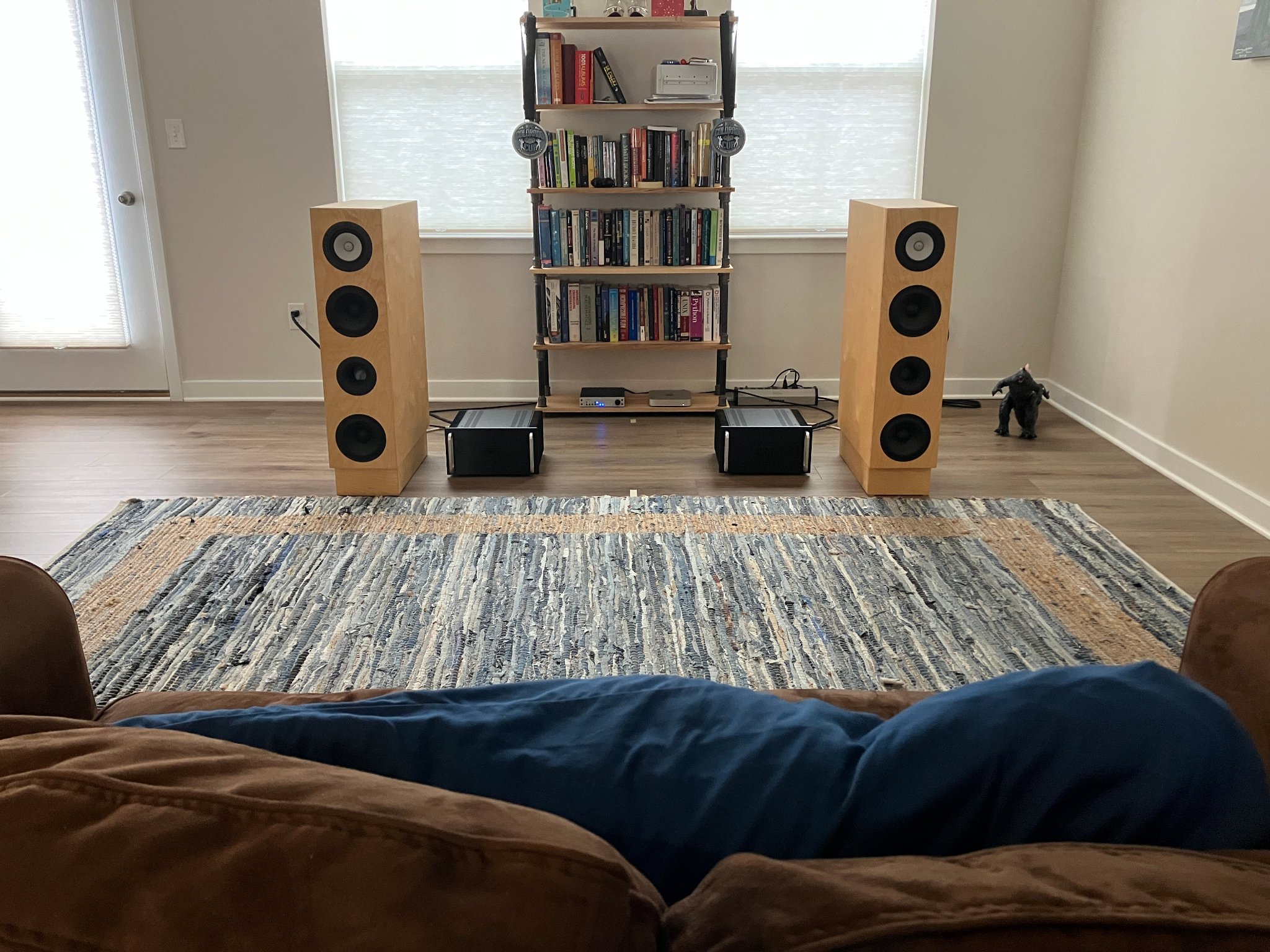

After getting some ACA MinMaxes done to use in place of the 1st Watt F4s in the summer, I put them in the system. One channel was louder than the other so I decided to take a break from the amps. Out of frustration in not being able to give the MinMaxes a good listen, I decided to attempt finding optimal speaker placement again. Inspired by visiting a friend's I just plopped them down as close as the F4 placement would let me and pointed straightforward. I put on some music, ready to start experimenting. Instead, I just heard this wall of sound with so much fullness and detail. I ended up sitting down and having a listening session for a couple hours. This morning, I tinkered with walking them apart an inch at a time. Settled on them being 6 feet apart, still pointed straight forward. Even the GF noticed a difference commenting they sound so much bigger and warm. Working on meal prep in the kitchen is even more of a joy, food and music.
having fun with a signal generator. Getting useful output down to 32Hz. High end, I can hear up to 12kHz. The GF can hear up to 16Khz. Pretty capable speakers.

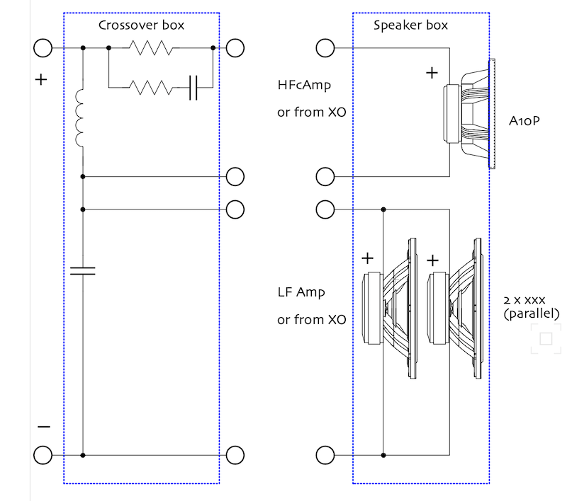

Time for a new design with CHP-90 and similar woofers. Hopefully design can be further optimized. XO is always the hardest part.

I've got a crap tonne of amplification channels on hand, I've been considering playing around with active x-overs since I already have the cabinets and drivers. But I've also got CHP-90s among a bunch of other drivers sitting around waiting to be played with.

Congrats. Would appreciate one piece of information/confirmation: the 12/16kHz upper limits were off-axis how many degrees approximately? Thanks.having fun with a signal generator. Getting useful output down to 32Hz. High end, I can hear up to 12kHz. The GF can hear up to 16Khz. Pretty capable speakers.
BTW the new MA200 listened-to off-axis 30-45° was essentially flat to at least 15kHz; by-ear and confirmed with umik-1 (which was spec'ed only to 16kHz).
It i a good idea. You will lose some sensitivity which could help for those with the less sensitive woofers (the replacement)
Some adjustment might be required to get the levels right. In a series XO mucking with anything affects everything. And specific filtering would need change.
