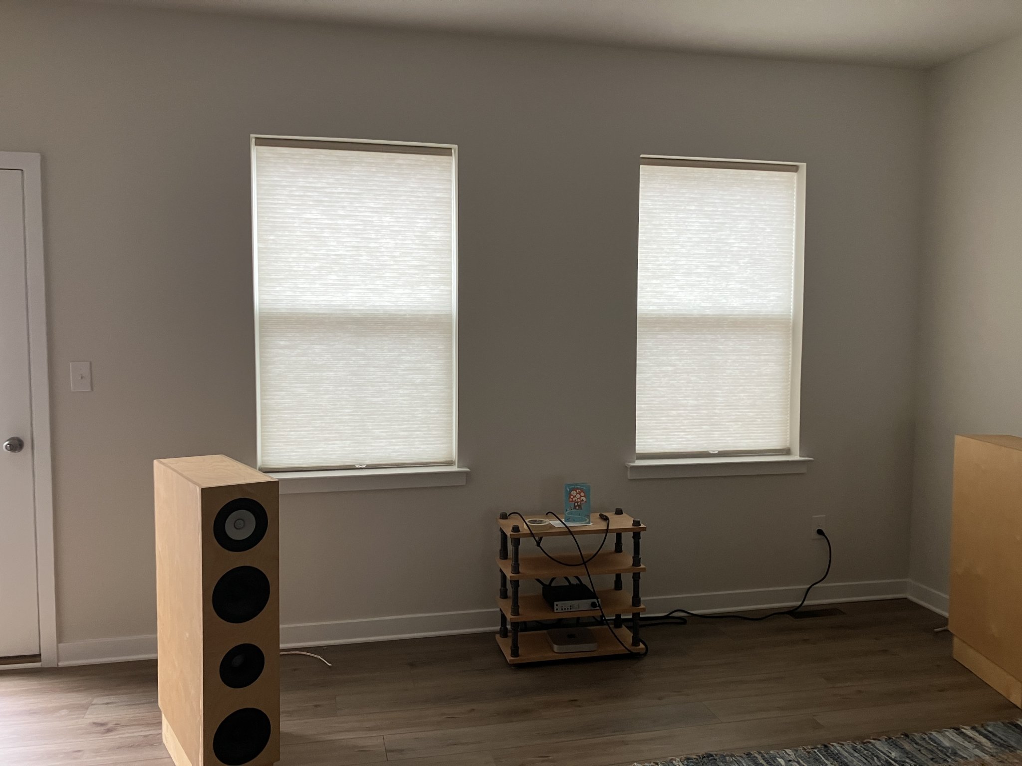

The Halcyons have a new home. Very nice having a much larger space to let them open up.
Lookslike you could use more “stuff” in that room for the acoustics.
What amaps are sitting onthe floor?
dave
dave
Yar, Dave. The room is a bit "live".
The amps are 1st Watt clone F4s running in balanced.
Definitely will highlight the liveness of the room. Acoustic treatments is a couple projects away.
got some blinds up. Still need to set the system back up to see how they help with any glass reflections.
next on my list is a bookshelf to go smack between those windows. Got a bunch of STEM books needing to be unboxed to make me feel more settled in.
