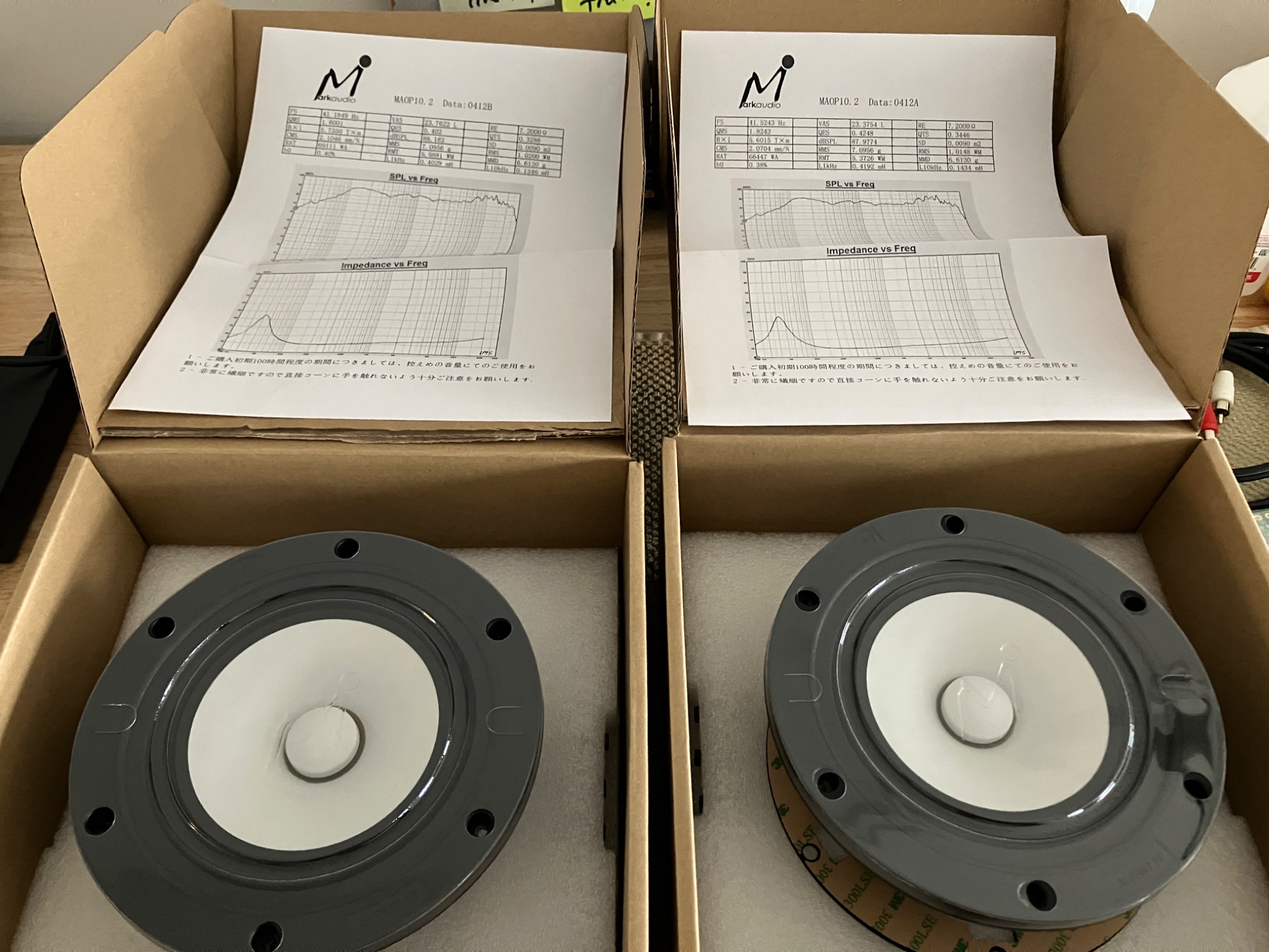

Got the last pair of MAOP-10s from Madisound. Working out next steps. In the least, will just pop them in to see how they sound with Curt's x-over. Then to branch off, get some measuring equipment and take a hand at putting a twist on the Halcyons.
I am most anxious to hear what you learn. I also have a pair of MAOP-10s sitting on my shelf to try. I also recently upgraded my SoundEasy software to do some measurements but the project is down the list a bit. I have high hopes this path will cure my one complaint with the Halcyons.
-david BTW
-david BTW
Yup, and that is exactly what I am going at this with active DSP adjustable crossover for the first pass. Also the original woofers had a different sensitivity than the ones I purchased from Madisound, so there is one more specification difference to tackle.The A10p is more sensitive by a couple dB.
