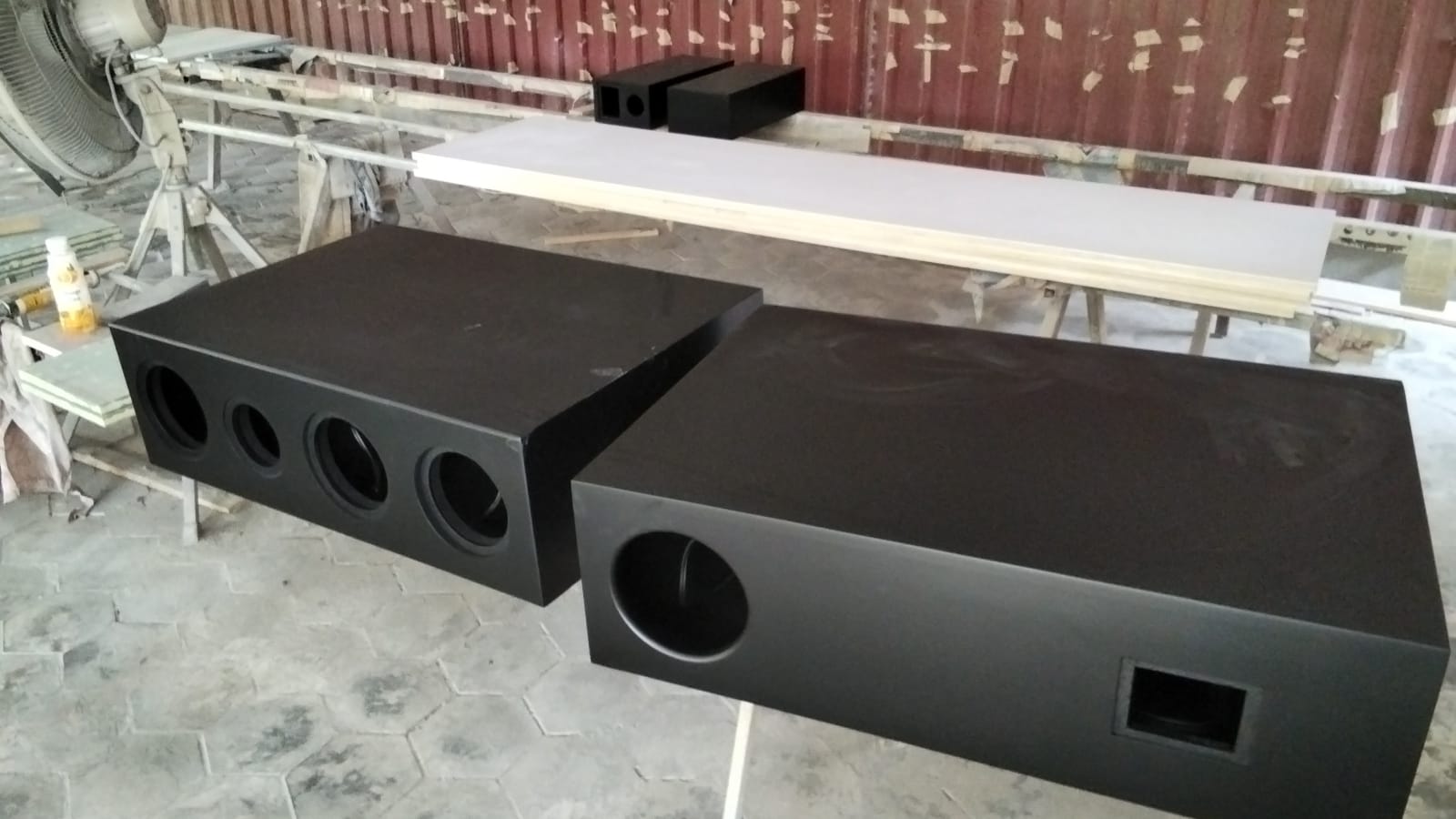

Now how about that - it has taken some time - but is now a couple of days away from completion. Matt Black.

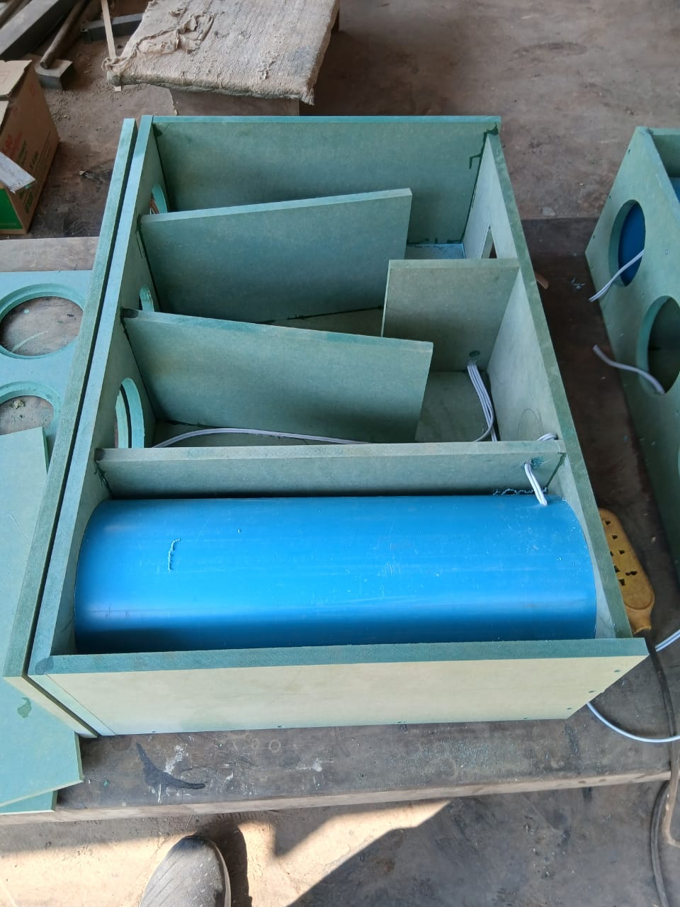

For builders outside of the USA, it looks a like a large diameter poly pipe is the way to go. I have fancied building the Halcyon from time to time, and have contemplated using a poly pipe. My understanding is that a pipe with decent wall thickness would work in this application.
Interesting color for your MDF - that is the water resistant type?

I suspect that it is a waterproof variant. It is not the nest I have seen but not a lot else available.

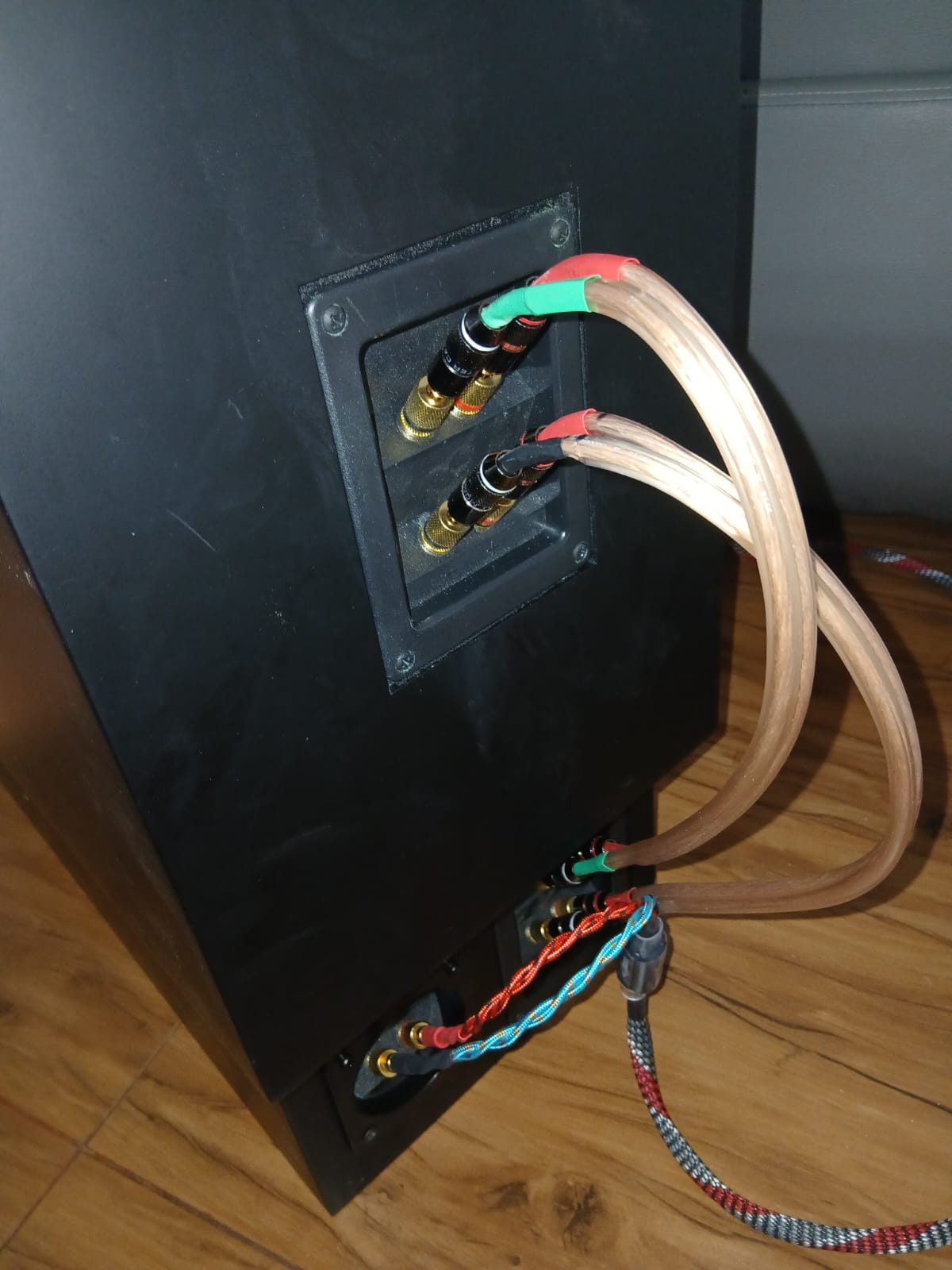

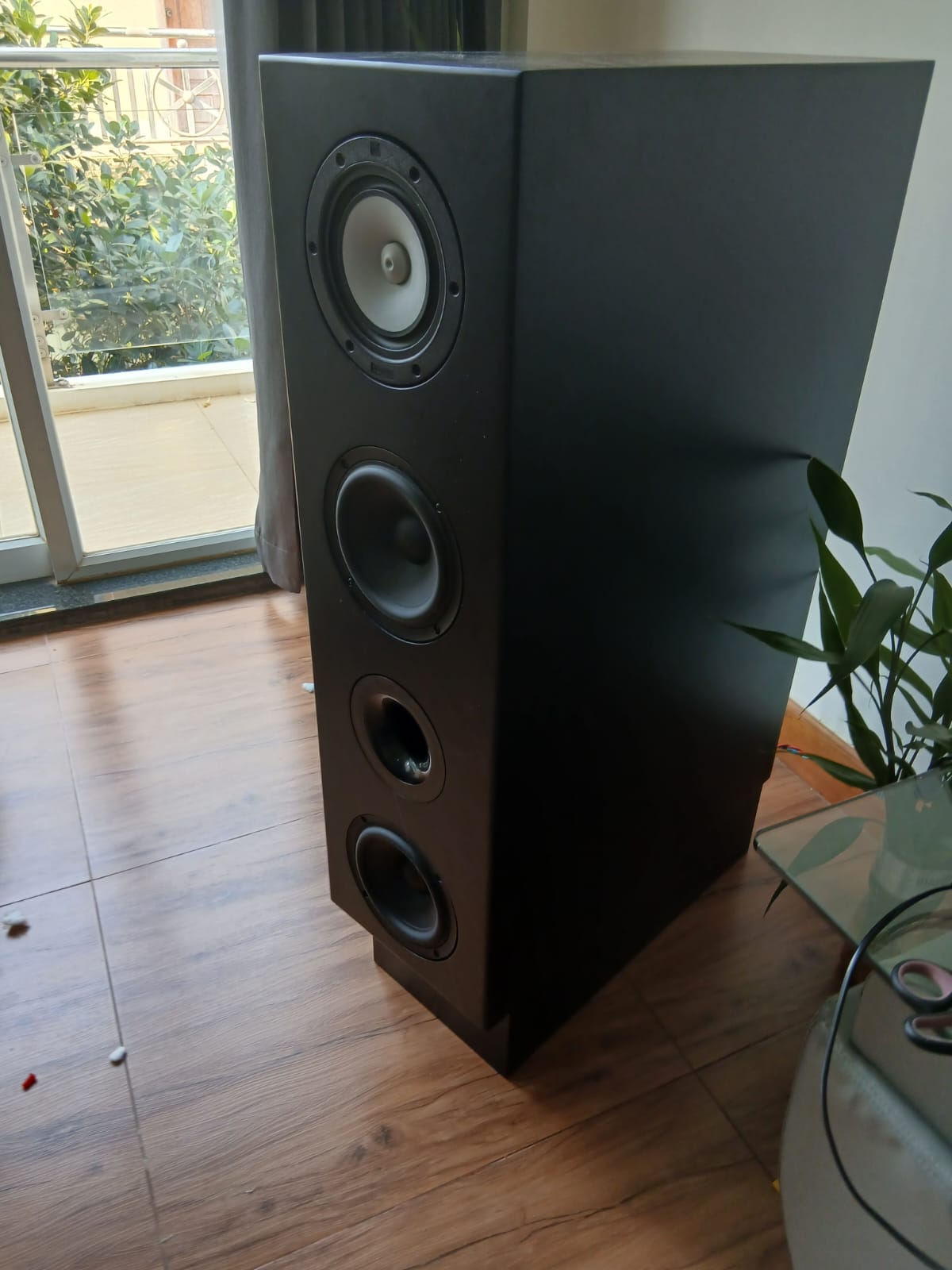

Thought you might like to see the progress. a Couple of days away from completion. Matt black and starting to look pretty good. Baffles are pretty solid as you can see. Of course all the components fit nicely!

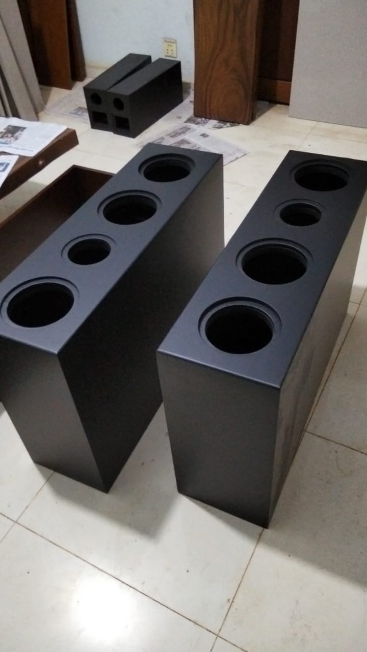

Good to see more progress. Now that the cabinets are done, you should be up and running soon.
The black finish is looking matte - what process did you follow?
The smaller boxes in the background that placed on a rack - those are for housing the crossovers?
yes smaller boxes in the back are for the Crossovers. Matt was all sprayed, sand and repeat. to remove all blemishes. All glued and screwed. So should be nicely sealed and robust.
I should get mid week - but am pretty busy right now - so in around a week all components should be installed. I will provide some detail regards the final painting etc and a load of photos. Happy to provide said boxes at cost - but the freight and packaging from Cambodia might be prohibitive. Takes around 2 months to build and finish. I rather think that this is just Ver 1.0.... if the sound is to expectations then might well try a few variants.
