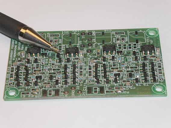

Current feedback high speed headphone amp with diamond output buffer
The soldering iron is hot.... not finished yet... but soon I'll hope.
The design is very basic, like the ones you can find in examples of current feedback amp theory, which is available on the net. The rest which I have added can be seen in integrated devices.
I will post results when it's finished. Meanwhile you can check my diamond buffer which has a very nice performace.

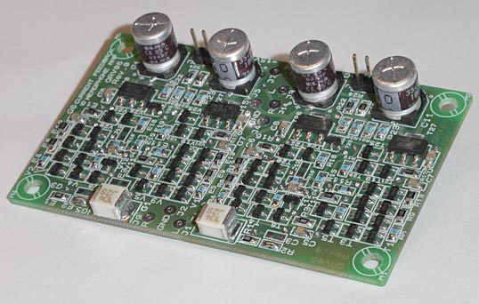

I have tested the amp now and it works, directly from simulation! Distortion seems lower in the real world. It's not significantly different from the soundcard 0.0088% and the soundcard alonde 0.0083% where hum is a part of this.
Step response is excellent. Risetime is much less than 75 ns which my signal generator has.
I haven't tested with my other signal source yet. 1 MHz square wave, 10 V pp is identical with the input signal. Offset only 3 mV out! The other channel has more but I haven't investigated why yet.
The sound is splendid :nod:
RightMark distortion analyze files are available, send me a message for the html files. File size around 1 MB.
It seems that not very many, except for Jocko, that have experince of current feedback amps, but I can really recommend it. In the weekend now I have listened to my speedmonster (compared to voltage feedback) and I simply like it. But I think I'm influenced by the looks of the amp. It feels right to touch it!
About simulation: I had a small ringing at a very high frequency, this without compensation cap. Only a very small capacitor removed this ringing. The simulation didn't take that!

The distortion figures must be taken for what they are. The are in the level of the soundcard and they are better because I had a litt bit hum also in the total signal. The distortion is measured at 1 kHz.
The pcb has two channels. The single channel one is only a diamond buffer.

I have now listened even more to the amp and I am really pleased the sound. Razorblade sharp impression, bass deep and firm, treble like a Sarek creek. I have also tested low omhish output and with 100 ohms. I'm amazed about the very very very small difference with original length of my headphone cable and Sennheiser HD545.
More should try current feedback. It's very easy to get working. I have used the classic topology topped with high speed technique from integrated current feedabck opamps. According to simulation it's very good to have cascodes in the diamond buffer. If not used you get a sharp peak at 10 MHz or so.
