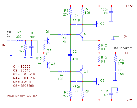

Hi Christer,
I hope we are talking about vaguely similiar circuits...
Getting most of current swing from the added transistors allow all transistors in the diamond to operate at fairly constant current.
This, IMHO, is the main source of improvement.
Depending on your output current needs, it also becomes possible, to have the same transistor pairs in both stages of diamond, and at the same Iq.
For a power output stage this may require actually using darlington outputs, like in this circuit:
http://www.double-diamond.de/scratch/DARL-BUFFER.pdf
Sorry, that one may look confusing, not only because of my lacking drafting talents, but also because the stage is designed to have small gain (4dB).
Peter Jacobi

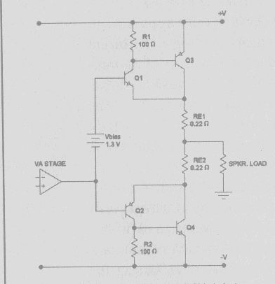

Peter,
Thanks for your response. Your latest circuit is starting to look like Hiraga's Class A amplifier.
In your original circuit, I suppose the Darlingtons would help and replacing R5 and R6 with adjustable current sources would help adjust bias and offset.
Jam
Jam
Peter,
Yes similar but not identical. I don't use Darlingtons and I didin't
add any resistors. I just replaced the output followers with CF
pairs. There should probably be a bias resistor, but I was to lazy
to put it in and it worked fine in the simulations without it.
I have always thought of a CF pair as a CE output stage with
a complementary driver. However, perhaps it is more appropriate
to view the first transistor as a follower output and the second
one just as a kind of current booster? That seems to make sense in
the Diamond buffer case.

Sounds like we mean the same thing. Below is a picture from
Slones book with his "definition" of CFP. In this case a push pull
CFP output stage. Does this agree with your "definition" of CFP?
If so, I asume we are talking about resistors R1 and R2?
Don't bother about resistor values here, I only follow the topology.
I used more than 100 Ohms, to get the same current as I had
in the CCSs in the first stage (good or bad, I don't know).

I've tried this configuration in Class AB push pull, and it sucks big time.
Sounds 'tired', 'washed out'. I came away from the listening tests absolutely amazed; I loved the topology, it is so elegant.
You need a small cap, around 100pF, between base and collector of the lower driver (pnp), for stability, and then, the music loses all life. Otherwise, the outputs lose their lives.......
The double emitter, with all its problems, sounds much better.
This comment does NOT apply to Class A, for which stability criteria are different. And a bipolar driver with a mosfet is far more stable, since the transconductance of the mosfet is far less than any bipolar.
Hugh
Hugh
Christer,
and what I speak about is the attached topology.
Q1 and Q2 are quite important. Replacing R5 and R6 by current sources makes the parameters even better. After the replacement you have Jung's buffer with CFP output. This topology can be used not only for the power amp, but for the buffer, too. My requirement for buffer circuit is to handle 100 Ohm load (50 Ohm + 50 Ohm).
Pavel
Pavel
Hugh,
Just some quick notes.
For use in a diamond buffer for headphones or line level we will
typically be able to run in class A.
Although the figure from Slones book that I posted uses bipolars,
he does mostly/always use a BJT/MOSFET combo in his finished
designs in the book. He do run them in class AB, though. OTOH
he has obviously decided to go for ordinary source followers instead
in his newer OptiMOS design. He is a strong advocate for CFPs in
the book, so maybe ha has later changed his mind?

Regarding Hugh's comments, I do not hear this attributes for class A output stage as shown, the opposite seems to be true for class A operation of this stage. But I do strongly recommend to place this circuit inside the feedback loop (without input capacitor and without C1). The NFB will be closed around very linear class A output stage, reduces distortion even more and increases damping factor considerably to more than 1000 (8 Ohm) at lower frequencies and to 500 at 10kHz.

Hi Pavel, All,
(Compare above Pavel's circuit and previously attached/linked ones.)
Whereas there can be no clear line drawn, in my opinion there are two ways to view this topology. Two different roles for Q1/Q2.
a) a CFP output with a unusual Vbias generator (doubling as buffer for the VAS if this is part of standard amplifier).
b) a diamond buffer with aux power transistors to carry the most current.
And (still in speculation mode, and unusually subjective) whether this works more as a) or b) depends IMHO on matching between the Q1/Q2 and the Q3/Q4 pair.
If they are comparable in speed and other factors, the circuit has more the characteristics of b), otherwise it has more the characteristics of a). As I am mostly aiming towards b), I try a close match of Q1/Q2 and Q3/Q4.
But this of course gives some problems, if this has to be the output stage of power amplifier with 'real' currents to drive:
Either
1) Q1/Q2 and Q3/Q4 must have large bias currents, which 1a) rules out high beta devices or 1b) requires each of them to be a darlington
or
2) the booster transistors Q5/Q6 must be darlingtons.
Am I lost in Voodoo-land here or can somebody see sense in this argument?
Peter Jacobi
Hi Pavel, All,
PMA said:[...]and what I speak about is the attached topology.
Q1 and Q2 are quite important. Replacing R5 and R6 by current sources makes the parameters even better. After the replacement you have Jung's buffer with CFP output.[...]
Either
or
Peter Jacobi
Christer,
Yes, I suspect you are right. Slone could well have changed his mind; instability is a problem in Class AB at the crossover disjunction; but of course in Class A this problem evaporates.
Pavel,
I concur with your findings in Class A. In fact, I use the bipolar/mosfet hybrid CFP in my Glass Harmony SE amp (which dissipates 3A/50V and produces just 28W) and its stability is unquestioned. In fact, its stability rivals QE2.
So, in summary, CFP is fine for Class A SE or PP, not so good for Class AB although it can be achieved at sonic cost with small caps across the base/collector of the driver. This is a great pity, as the CFP is very appealing from an engineering standpoint. There has been much crowing about the joy of a stable bias point, but in fact with just 1.3V I have found setting the bias to be almost a thermonuclear event, with outputs easily sacrificed to the silicon gods. Sonic and stability dictates show that the best overall results are still gained with the emitter/source follower, though my own preference will always be for Self's Type II double emitter follower.
Hugh
Pavel,
Hugh
