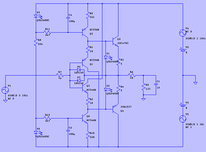

Of course the resistor version is lacking some power supply rejection - but only some. The symmetrical 100Hz ripple in both rails is still rejected fine.
I haven't simulated P-As amplifier, but I have earlier simulated
a stand alone Diamond buffer (essentially identical to the one
presented by Jung except for some swap of transistors, and
maybe bias current). I just tried replacing the CCSs with
resistors, taking care to get the same currents as in the CCS
case. I get a 20dB difference in PSRR for the negative supply
and 26dB for the positive supply. I would say that is more
than "some" difference. One difference, however, was that
the resistors gave a flat PSRR response up to around 1MHz,
while the BJT CCSs started to lose rejection at or slightly
above 100kHz. Of course it will vary from case to case, depend
on the choice of transistors etc. etc., and it is after all just
simulations. I justed wanted to show that the mileage can
vary here. I haven't tried to redo any distorsion measurements
with resistors, though. I might try that at some occasion.
It should be noted , perhaps, that I measured the AC response
at the buffer output when applying AC stimuli to the rails. I
did not measure the current variations in the CCSs/resistors,
since that is of less interest.

PSRR of the diamond buffer, CCS vs. resistor simulations
The difference I see is not so huge, 10dB (58 vs. 68dB) for the positive and 6-7dB (57 vs. 63.5dB) for the negative rail. And yes, I also saw that the CCS can lose its steam somewhat earlier but the absolute values I see are even after that better in the case of the CCS. Also, some current sources will keep the maximum PSRR as long as the resistors will do. It is interesting the fact the change of the type of the used current source does not make almost any difference in the term of the nominal (maximum) PSRR.

Just for reference, here is the schematic of the diamond buffer
I simulated.
