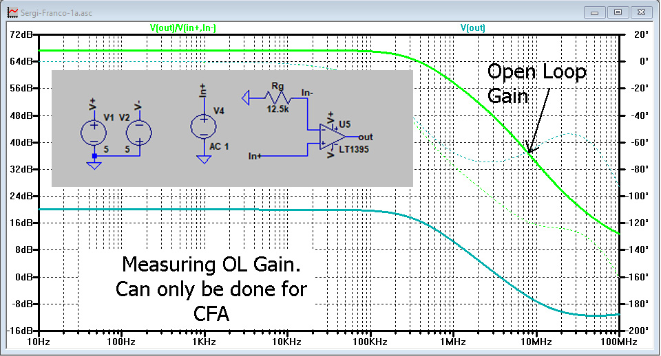

You can however come close to open-loop when applying a very large resistor Rf like 10.000 times Rg.
That’s what I did in the Sim I made for Ian.
It returned in that case still enough information to classify the circuit as a CFA.
But, in hindsight, it was a silly one off experiment that doesn’t look to be very useful for whatever purpose. So let's forget this one.
That procedure could be by using the circuit below, being really an open-loop, like mentioned in #1391.If there is some procedure that you propose for the open loop case, please state it.
Dividing V(out)/(V(in+)-V(in-)) returns the open-loop gain.
And I would like to repeat, this uniquely separates the CFA from the VFA because it only applies to a CFA.

Thanks for following through on my query in Post 1321 for Rf very large or the case of no Rf.That procedure could be by using the circuit below, being really an open-loop, like mentioned in #1391.
But doesn't your open loop test bring an apparent contradiction with it? How can you say you have a CFA when there is no feedback in open loop? Wouldn't it then be just a CA😀?
Or could it be that even in open loop it is still a CFA with current feedback active?😕
