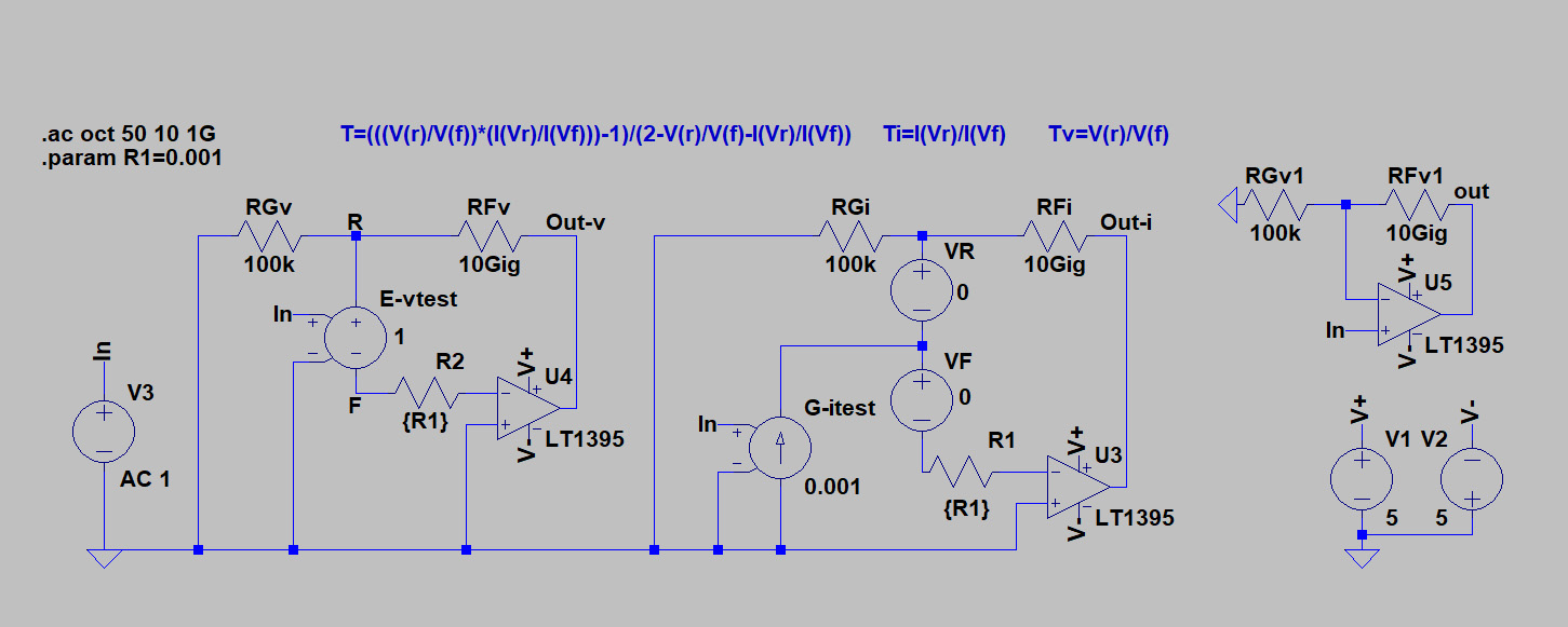

Hi Chris,
We are seemingly very good in miscommunication, but I take full and complete responsibility for that, but don't worry, at the end we solve all this.
Your control over the English language is so much better than mine.
In this case when understanding you correctly, your question is: why using DIT when different use may only cause more confusion.
But wasn't the whole idea of this thread to get a finger behind this CFA / VFA thing, does it really mean something or is it just some commercial invention ?
To come back to the first line of your posting: no, I was not referring to Middlebrooks open loop test.
I even would like to avoid the name Middlebrook to prevent misunderstandings and only use the word DIT, but as you can see in the Image, when making Rf and Rg 1K, you have the Middlebrook version.
I was all the time using the set up from the image below, only Rf and Rg were changed depending on the circuit being tested.
Here it is configured for doing an open loop test with the LT1395 CFA with Rf 10Gig and Rg 100k, the outcome of which was shown in #1338.
In the explanation in #1338, the names of Rf and Rg were accidently switched, but the test itself and the image being produced were O.K.
