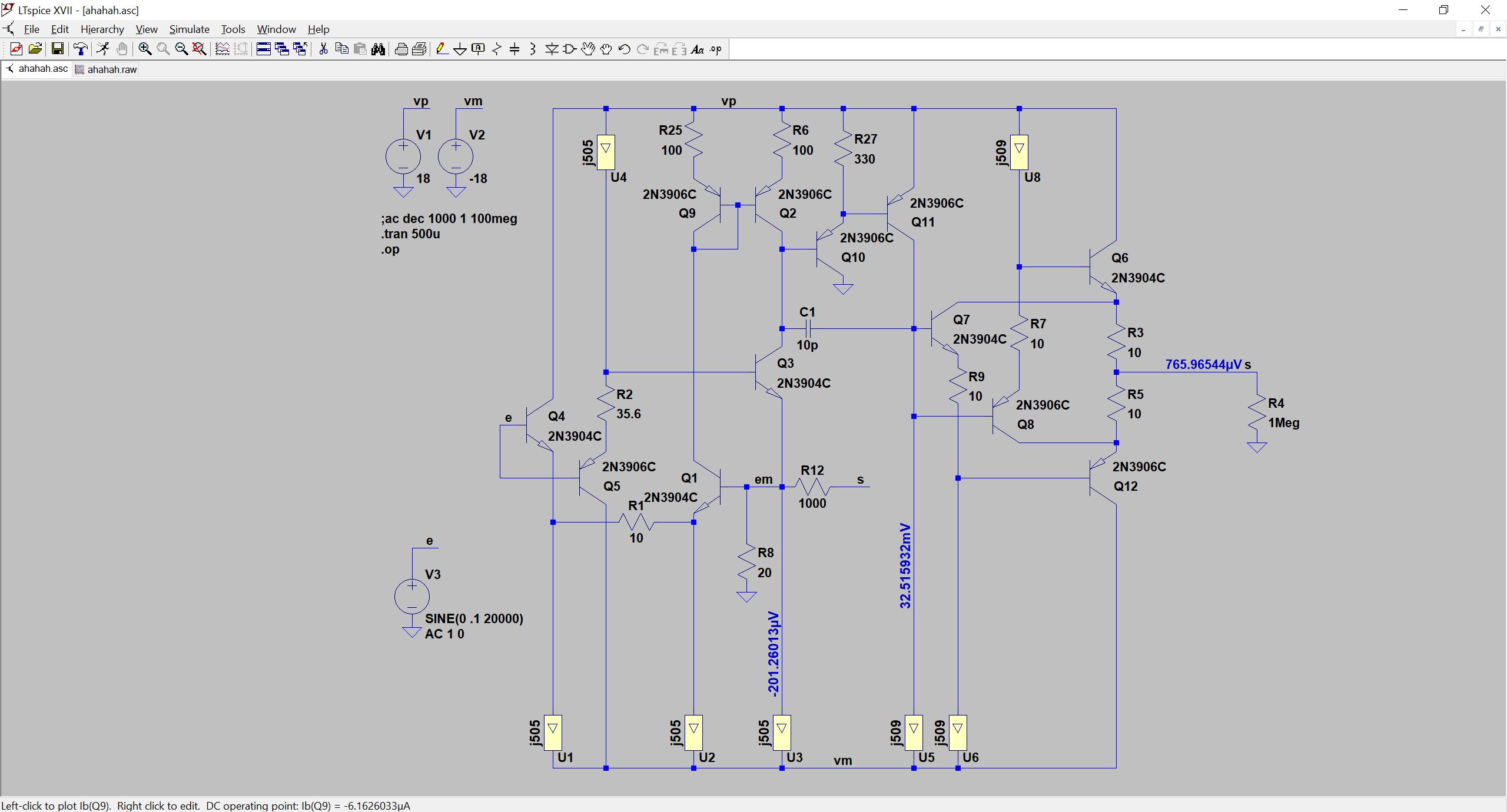

According to your criteria, the attached amp scheme is a VFA or a CFA ?
  • ahahah.asc
    ahahah.asc
My criteria would first deem this to be "amusing." If a practical use for it were found and it entered wide circulation, it might deserve its own name.

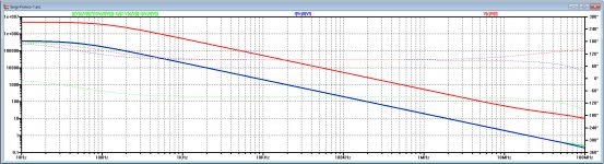

Could you please state the rules for using Middlebrook's DIT outside of a loop? Certainly there are valid tests that can be applied without global loops. But let's be careful that we don't start another (at least partially) nomenclature-based dispute! 😱

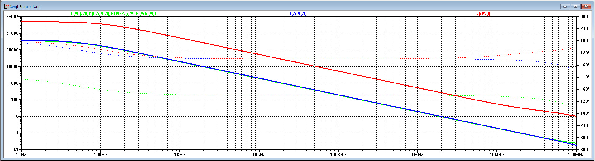

Hi Chris,
Let me try to answer this from my side.
You found an (unexpected ?) discrepancy in the transimpedance.
Next step made by you was to suggest to make the Early Effect responsible for that.
To start with, I invested quite some time checking all your findings, to which I agreed.
Then I changed your model by replacing Q1 to Q4 to ideal transistors with a parametrised resistor in parallel to simulate Ro.
With a value of ca. 140K for Ro, I could exactly replicate your measurements with the 2N3904/3906 model.
Although I agreed with you on your findings and your conclusions, I failed to see the relevance of this phenomena.
Thats one of the reasons why I also made the DIT model, to investigate to what degree this Early Effect had any importance on the working of the CFA.
The DIT simulation with your very model in completeness with all transistors, confirmed my suspicion that apart from some insignificant effect on loop gain, the Early Effect could be put aside as a complete unimportant issue.
But despite all my efforts, there were still many postings from you where you kept asking "I ask again for the umpteenth time: Why is ic/vbe different from I q / (k T)?"
The question was already answered with Ro but you kept on asking.
It must be quite obvious that I invested a significant amount of time in checking, building models and so on to answer your question and to show the irrelevance of the matter.
But for some reason it keeps popping up over and again.
That's why I suggested to close this book, without the intention of being unfriendly.
Hans
Thanks for the explanation, Scott. I agree that the balance of gm vbe to vce / Ro operation is not important to the operation of the amplifier. I hope you know that I never claimed it was.
I also understand that some of the folks on this post depend on a purely or at least mostly transconductance-based operation of the input stage transistor to support their claims of voltage feedback. Especially with the audio frequency high loop gain of a device like the AD844, these opposing currents are almost equal in magnitude. The Ro-related portion of the phenomenon is effectively a resistor between the inverting input and the low impedance current mirror input. The Ebers-Moll / Early and the Hybrid Pi model evince this, and we can also infer it from the behavior of a sim'd transistor in a feedback loop as the loop gain increases without bound.
Making it clear that the transistor's operation is not even close to that of a pure transconductor is the only point I was trying to make, targeting those who assert it is.
