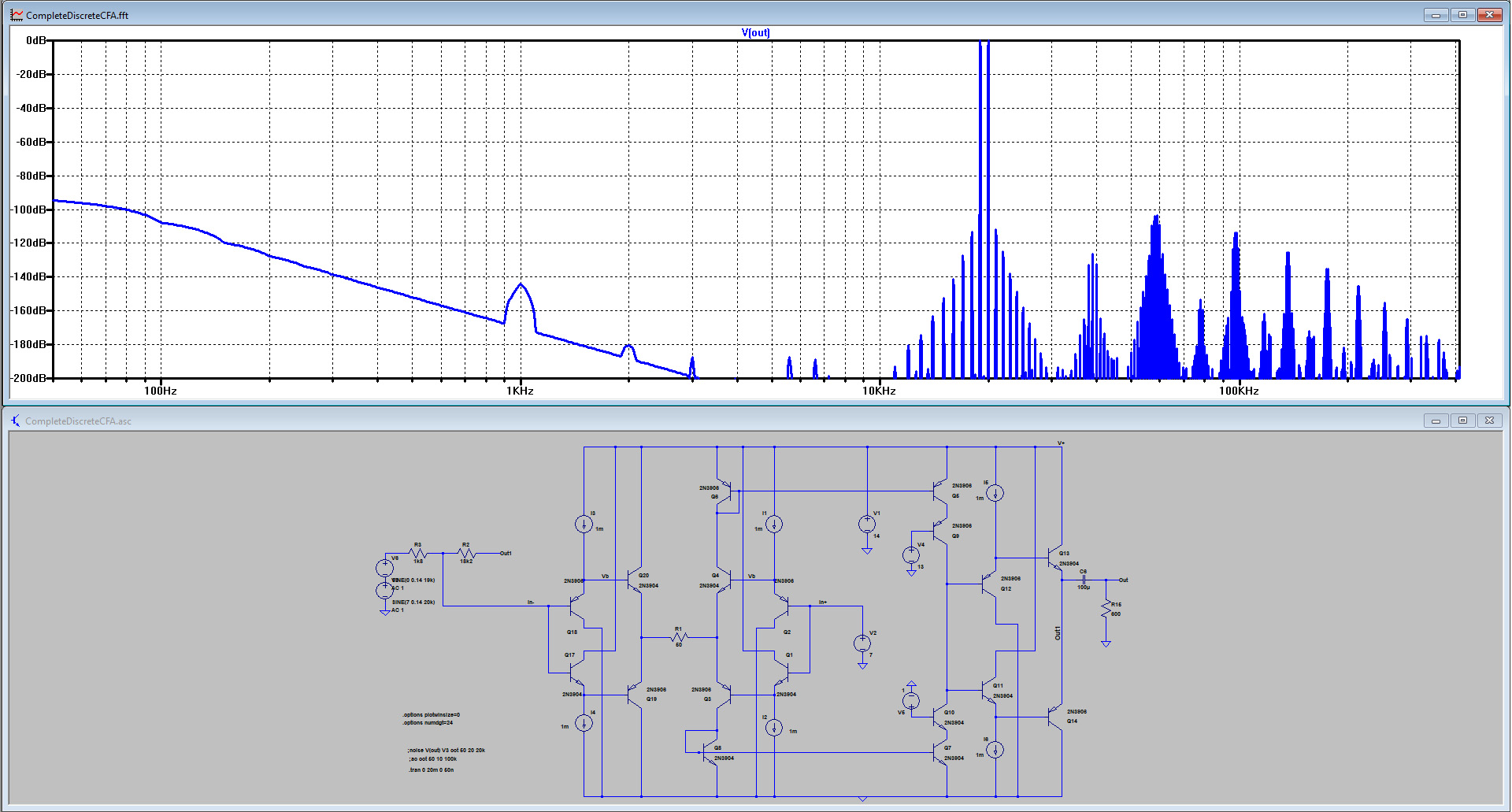

Oh. OK. Well in my original circuit its from the transistor C's and the topology causes their distortion contribution to cancel.
No FET's, and from a 10K source impedance at audio frequencies unlikely anyway. I don't care about the power budget just keep it equal and sensible. I just thought a diversion from the circular discussion might be good, probably a never mind.
For simple circuits, I can bread-board it as fast as i can pick and place parts and wires on the screen.
I had my circuit still wired and as expected**...from low Z source the thd is .0007% and almost 6 times worse when source is 10K ... .004%
Same thing happens if I add more device C to any transistor... creating a simulated mis-match in device C's........ the thd goes up.

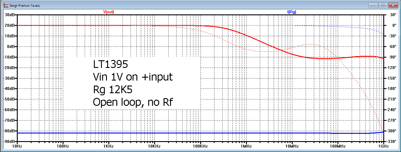

Chris,
A global loop is indeed not required for a CFA, quite contrary to a VFA.
Of course this makes only sense in a testing set up.
But, this could even be used as another significant different between the two.
In open loop, when only applying Rg without an Rf, a current equal to Vin/Rg
will flow when offering Vin to the positive input.
Depending on the ratio of Z(s)/Rf, a voltage wil appear at the output of Vin*Z(s)/Rf.
In case of the LT1395 LTSipce is using a Z(s) of ca. 125K//3.5pF.
So for frequencies below 100Khz, gain will be a flat 20 dB when using an Rf of 12k5. See image below.
The same can never be done with a VFA !

Thanks for the effort, that was the idea. I was hoping to show that an equivalent CFA does not do significantly better when both are optimized for an audio application, though typically the CFA will have more noise. BTW I suspect LTspice is overly optimistic vs. something actually built on a PC board so this might not as useful as it could. Every little circuit I tried can get down to ppm levels.
Here is my exercise which aimed to establish that CFA and VFA rely on the same fundamental mechanism. I added an ideally Buffered Feedback Amplifier (BFA).
It can be seen that the control is under the input device which receives the feedback voltage on its emitter, be it buffered or not.
Comments wellcome.
You have mentioned this before... noise may be worse. How much worse when opt for audio? And, is it more than a technical issue at line level signals?
For the CMA circuit typical of #1392 or otther?
Both with 10K source?
