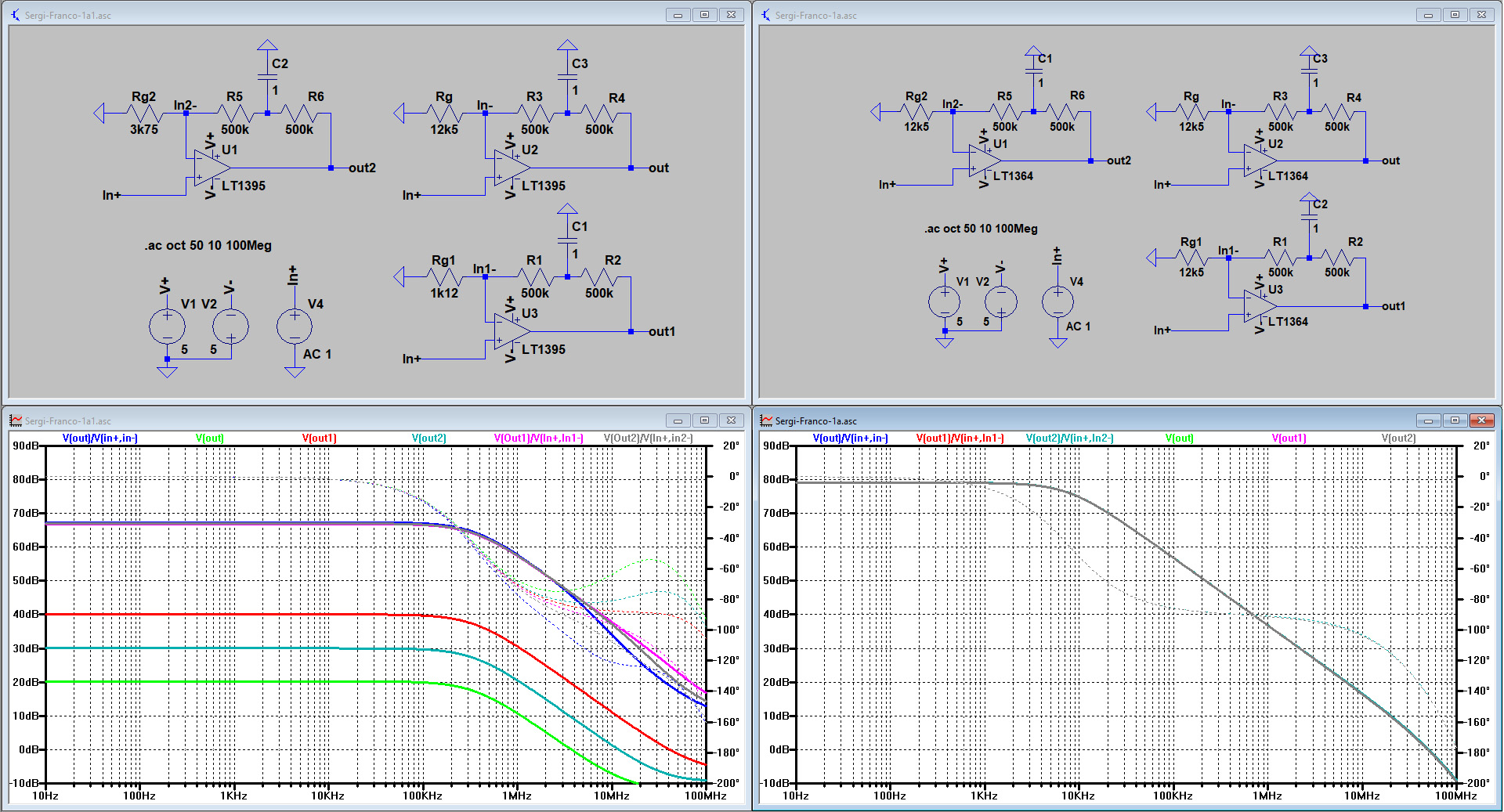

As you have seen, it's an excellent way to find the R and C values of Z(s). In case of the LT1395 resp 125K and 3pF.
To make this test universal, all that had to be done was to insert 2 x 500K resistors from output to the - Input with a 1F cap to earth in between.
The problem here is that the different places of the capacitor in the two circuits violates the Middlebrookian requirement that the return analysis be performed at the same point in the same circuit. I'm skeptical that something like this technique will help us determine the predominant form of feedback.
Look at the images, and you will immediate notice that for a VFA, in this case a LT1364 all curves are lying on top of each other, but nevertheless, you have your open loop gain available.
For a CFA, you will see different output voltages for different values of Rg, but the open-loop gain is always the same.
From this info you can easily calculate Z(s)
And above all, it's a very easy method to separate a CFA from a VFA.
Hans
Hans
Oops, a small error in the VFA image at the right.
The three Rg resistors, (Rg, Rg1 and Rg2) should of course all have the same value as in the left image,
But for a VFA this makes no difference at all, so I won't make a new image.
Hans
Yes, but you don't even need feedback to do that with a CFA.
Hans
