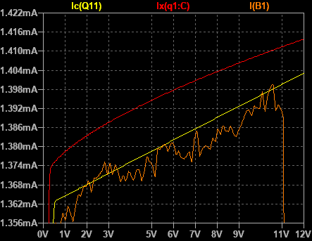

Nevermind, I did get some results. Early effect has a curve with VBIC that it didn't have before. Wrong thread though.
Did you notice that most of those models are from 1988? Vaf=100 for most of them. I decided years ago to ignore any such models because most of the time they are not very good or are even complete garbage.
Thank you for telling.
The models BC550C and BC560C that were needed in this case came from Cordell, the same as used by Scott.
90% of what's in this .lib is part of LTSpice and never get used by me, but I use this lib as a container and add whatever I need to keep everything together.
In general LTSpice is a fantastic tool, but it helps a lot when you know what you are doing. If not, don't expect to be able to build a Stradivarius.
LTSpice Sims helped me enormously preparing to build complex circuits.
It would be great if LTSpice came with models that were even closer to real life, but there will always remain a discrepancy.
Hans
