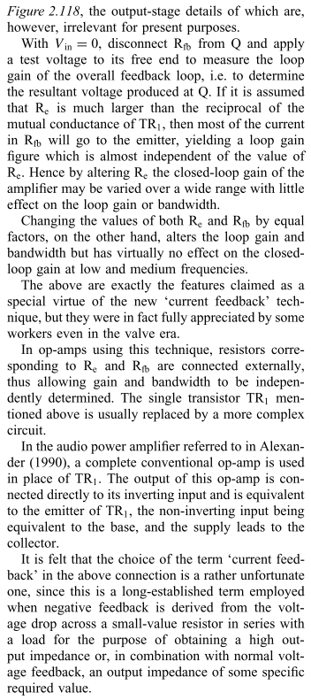

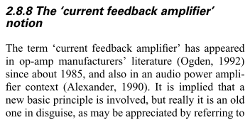

Peter Baxandall's opinion, excerpt from book by Michael Talbot-Smith "Audio engineer's reference book" 2nd edition, 1999, Focal Press, pages 2-128, -129.

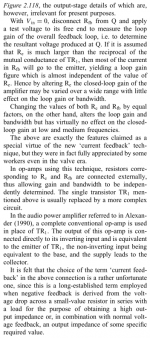

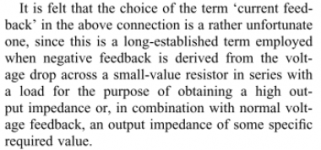

Baxandall, like Douglas Self, also thought complementary balanced amplifiers were ‘flawed’, and that JFET input power amplifiers were suboptimal.
Both clever, practical men, but not always right.
It's clear from the attached that Baxandall's objections were not based on circuit analysis or an understanding of how a CFA works. Rather, he bemoaned the appropriation of a term that was (improperly, in my view) assigned to describe a different circuit (see attached).
To see why I say "improperly", we have to agree on a definition of feedback, about which there actually seems to be some controversy (could this be related to our disagreement?) Here's my definition:
Feedback is the application of a signal derived from a first point in a circuit and applied to a second in a manner that influences behavior at the first.
The circuit Baxandall describes fails the test. As long as feedback is applied to a triode grid, a FET gate, or the base of a high-beta BJT, the only place that "current feedback" goes back to is ground (which it thankfully fails to influence. 🙂) This circuit is a classic VFA in which an element of the feedback network is the circuit's load. What is truly unfortunate is not that an historical term was used to describe the operation of a different circuit, but that the term was a misnomer in the first place.
Nothing in the citation of Baxandall indicates that his understanding of CFA operation differs from that of those of us who hold that a CFA employs current feedback. Baxandall's argument is etymological rather than technical.
