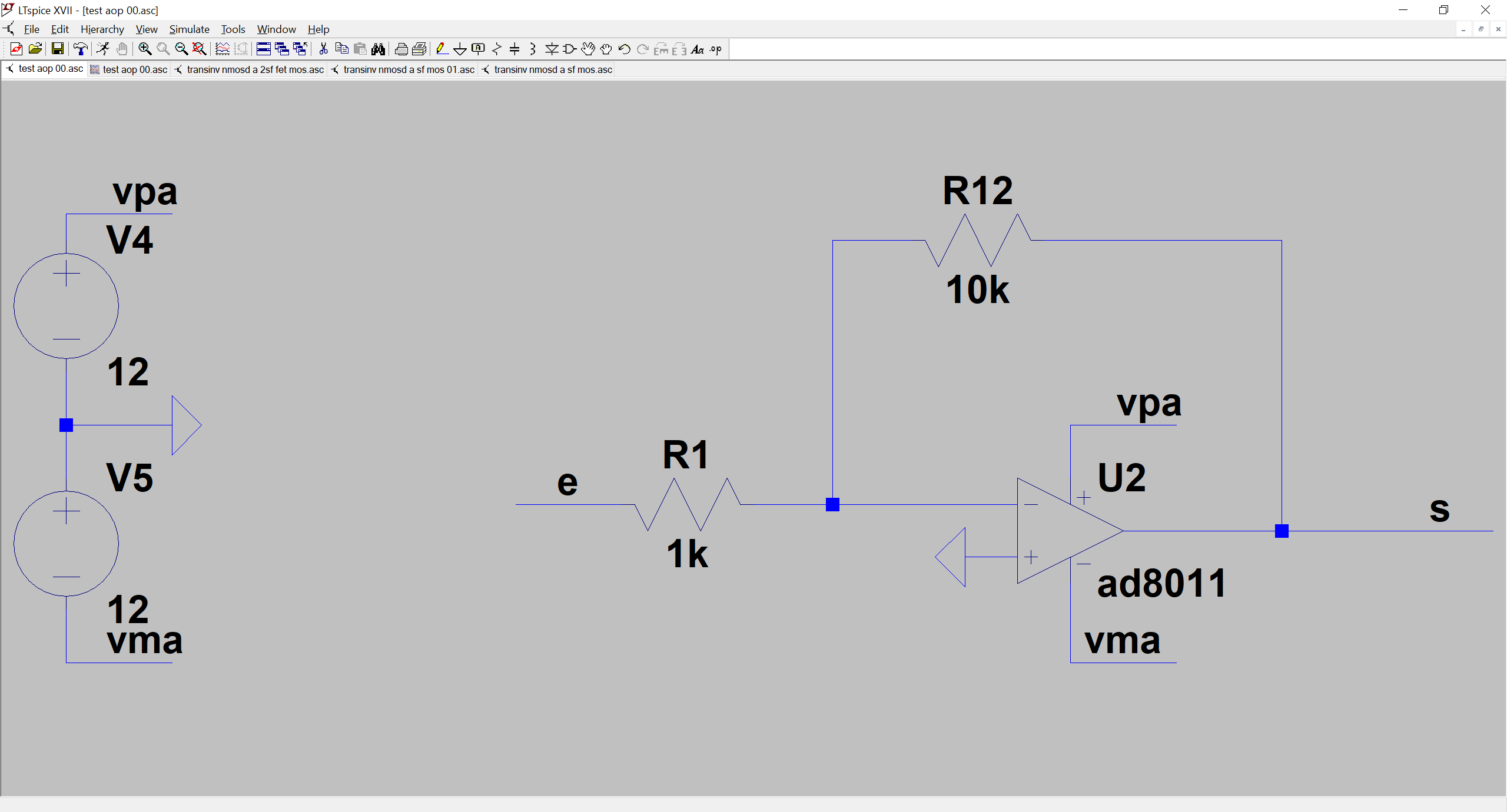

Thanks for your reply, Herve. Suppose you inserted a second voltage source between ground and the non-inverting input, one which presents a signal different from the first. What kind of feedback do you have now?
Suppose I zeroed the output of the first source but not the second. Then I reversed the situation so you have your proposed circuit. Does the type of feedback change with the levels of independent signal sources?
In the circuit you presented, The current flows from the output to the input where it has no effect. It also completely bypasses the op amp JFET input, and so has no effect on the op amp.
This does not satisfy the definition of feedback that I proposed:
"Feedback is the application of a signal derived from a first point in a circuit and applied to a second in a manner that influences behavior at the first."​
What is your definition of feedback?
That's a voltage feedback amplifier.
There is no current (other than bias current) flowing in/out of the inverting input. You can keep the ratio of the feedback network resistors the same, but change the overall resistor values by orders of magnitude and it will still function correctly.
Yes, and holding the ratio constant, but changing the magnitudes of the resistances, you vary the current with little effect on the circuit.
Some current feedback, when you can vary the current and it makes no difference!
But I'm interested in how someone who calls this current feedback is thinking.
Oups, sorry, I made a big mistake.
Voltage feedback amplifier :

Herve, for the circuit you provided, it can be demonstrated that Vout = I(in-)* Z(s). I(in-) flows through the input stage from the feedback network; I(in-) = I(R1) - I(R12). I(R12) comes from the output stage.
This satisfies the definition of feedback that I proposed earlier. What is your preferred definition of feedback?
You can of course, argue that I(in-) = (V(in+ - V(in-) ) / Z(in-) and that therefore this is voltage feedback. However, this adds unnecessary complexity, and does nothing to deny the case for current feedback.

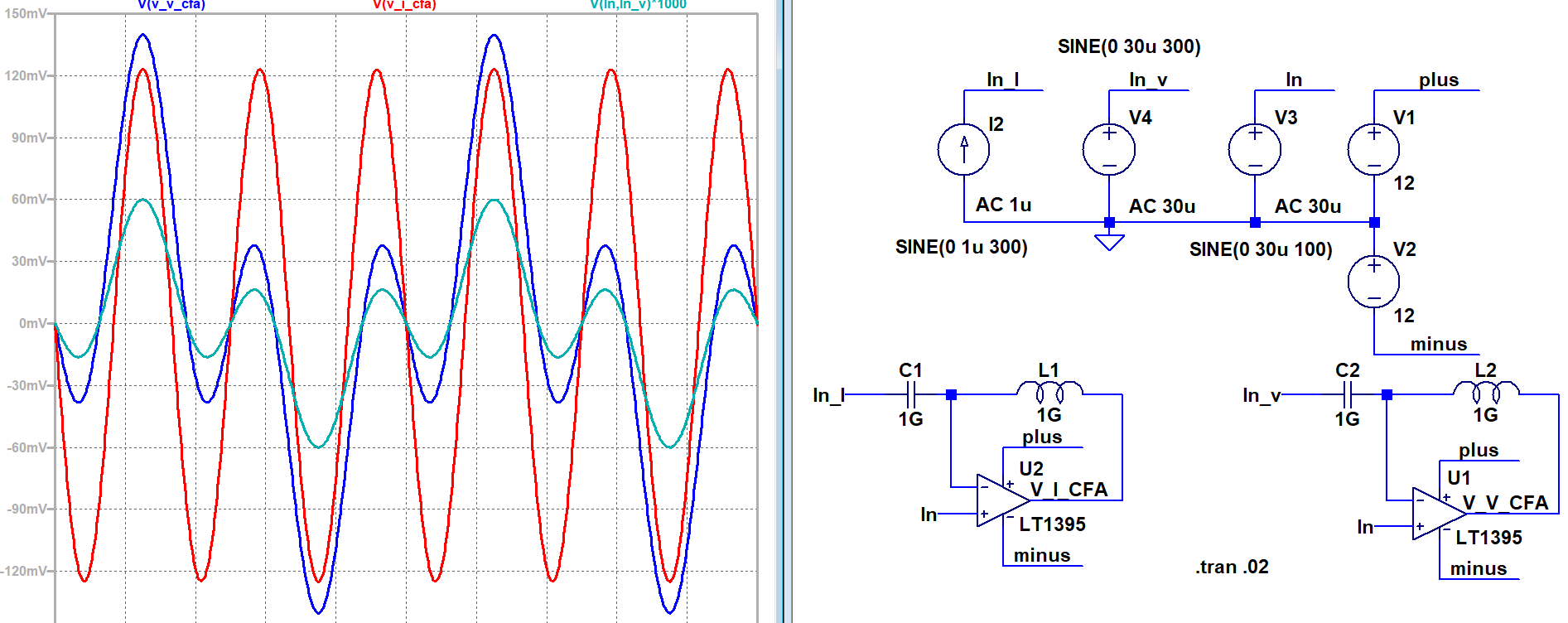

Consider the attached. We drive DC-stabilized CFAs in two ways:
(1) We apply a 1kHz voltage source to the (+) input and a 3kHz voltage source to the (-) input. These are of equal amplitude, and we see the difference of these signals at the CFA output. (The difference of the input signals multiplied by a factor of 1000 is displayed for reference.)
(2) We apply a 1kHz voltage source to the (+) input and a 3kHz current source to the (-) input. But only the 3kHz signal for the current source is apparent at the output. Oh, there is a 3kHz voltage difference between the inputs (no significant 1kHz component) - but this is only because Ohm's Law cannot be denied.
The CFA is responding to an applied current and ignoring an applied voltage.

Yes, because the CFA is responsive to the current fed back into its input. The VFA is not. What better proof of the effect of current feedback could you ask for?
