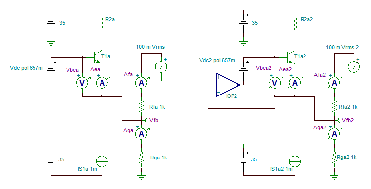

A first sight, the ideal input stage I suggested leads to a theorical perfect CFA (right circuit in the image below).
Looking carefullly, we see that this perfection is obtained by a perfect voltage control between the non-inverting and the inverting input by the ideal op-amp. The low impedance of the inverting input is not only preserved but is ideally null. So the ideal CFA operates like a VFA on voltage difference between its two inputs. This means the input stage is a differential input stage.
What appears with a realistic CFA is that it suffers from imperfection (well, far from dramatic) but the whole principle of differential input stays valid.
In fact, the input stage of a CFA, below on the left with a simple transistor, combines two functions at once :
1. sensing the voltage between its base and it emitter
2. delivering current to the feedback network
To me, it is the cause of the difference of the interpretations .

I don't see this as necessarily complex. Operational type VFA's and CFA's seem can be evaluated simply on the basis of the resistance at the Tz node and two resistors that make up the feedback path. One resistor from the output to the inverting terminal and the other from the inverting terminal to ground. The identification of an amplifier being of a voltage or current type seems nothing more than a function of the direction of current flow in the feedback resistor, mostly when Av is around 0dB. This is to suggest that VFA's and CFA's can be either type as pivotal around that point. The conclusion is also that neither a VFA or CFA can be a VFA in the absence of a resistor to ground for reasons that the current can't then be reversed in the feedback resistor.
It is interesting that a CFA with a resistor connecting the inverting input and the output but none connecting the inverting input and ground actually exhibits positive feedback when operating closed loop, and even more interesting that it can be recommended for use in this manner.
However, even in this situation, the "slew rate enhancement on demand" current is available from the CFA output, but not from the "classical" VFA output. This is an important functional distinction between the two that remains even for 0dB closed loop gain configurations. Of course, modern "enhanced" VFAs don't necessarily suffer from this limitation.
I think you meant "In a VFA the input stage output current comes from the tail current".Ian, I beg to differ. One large difference is that in a CFA the input stage output current comes from the -inp emitter, i.e. from the feedback network.
In a CFA the input stage output current comes from the tail current.
So, in addition to the difference in impedance level, there is a conceptual difference as well. A VFA is not 'just' a CFA with lower Zin at -inp!

Like LazyCat (next post 1118) and many others you are thinking of a VFA with the traditional LTP diff amp input stage. But a VFA does not have to be that type of IPS. A VFA can have the current on demand input stage of a CFA where there's no "tail-current".
Now try my thought experiment with a VFA current-on-demand input stage. (Post 1115)

Yes, you can construct what I think is often called here an H-bridge, basically two CFA's interconnected through each other's Rf.
But the discussion I was reacting to was a CFA or a CFA with a buffer/emitter follower on the inv input. The latter turns it into an LTP and the stage output current no longer comes from the inv input current but from the tail current.
And that not only changes the impedance level but also the topology.
Then you have two high impedance inputs and still the advantages of a CFA. But note that the interconnecting Rf still provides the current that ultimately forms the stage output (collector) current. So considering that, it would make sense to still call it a CFA, maybe a balanced or push-pull CFA. You can call it a current-on-demand VFA but that seems less logical to me since it is based on a specific topology of a CFA. Anyway, we were not yet at the stage of naming all kinds of bastards. We still have to agree on the original, simple different topologies ;-)
